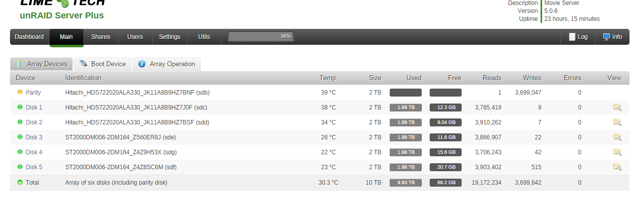

I had a 10TB array and in my largest share (movie) it says I have 1.14TB of data.  The odd thing is that when I am in the console it unRAID says that every drive is basically full (76GB free out of 9.93TB).  It seems like the data is there but I have no idea how to fix it or if it's even fixable. I've attached a syslog and screenshot.  Please let me know if I need to provide anything else.

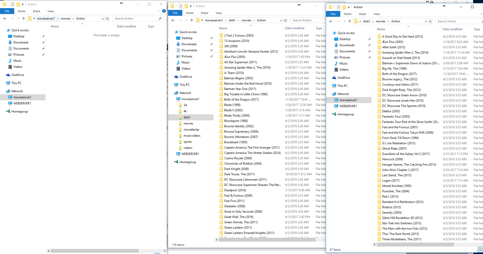

Parity sync finished and still having issues.  Now if I go to the share directly I can't see anything.  \\movieserver1\movies\Action show no files.  If I go to the each individual disk i can see the files!
\\movieserver1\disk1\movies\Action
\\movieserver2\disk2\movies\Action
etc

Your description of what you did is incomplete and doesn't really make sense. You said you replaced a disk but you don't say anything at all about it rebuilding the data onto the new disk. And then you did a New Config and rebuilt parity instead. If so then you would have lost the data you meant to rebuild, but your screenshot of the array doesn't seem to indicate anything wrong with the data since your disks seem to have data on them.

Your syslog seems to indicate a problem with disk4, probably filesystem corruption. Here is the wiki on how to address filesystem corruption. It has nothing to do with rebuilding parity.
https://lime-technology.com/wiki/Check_Disk_Filesystems
