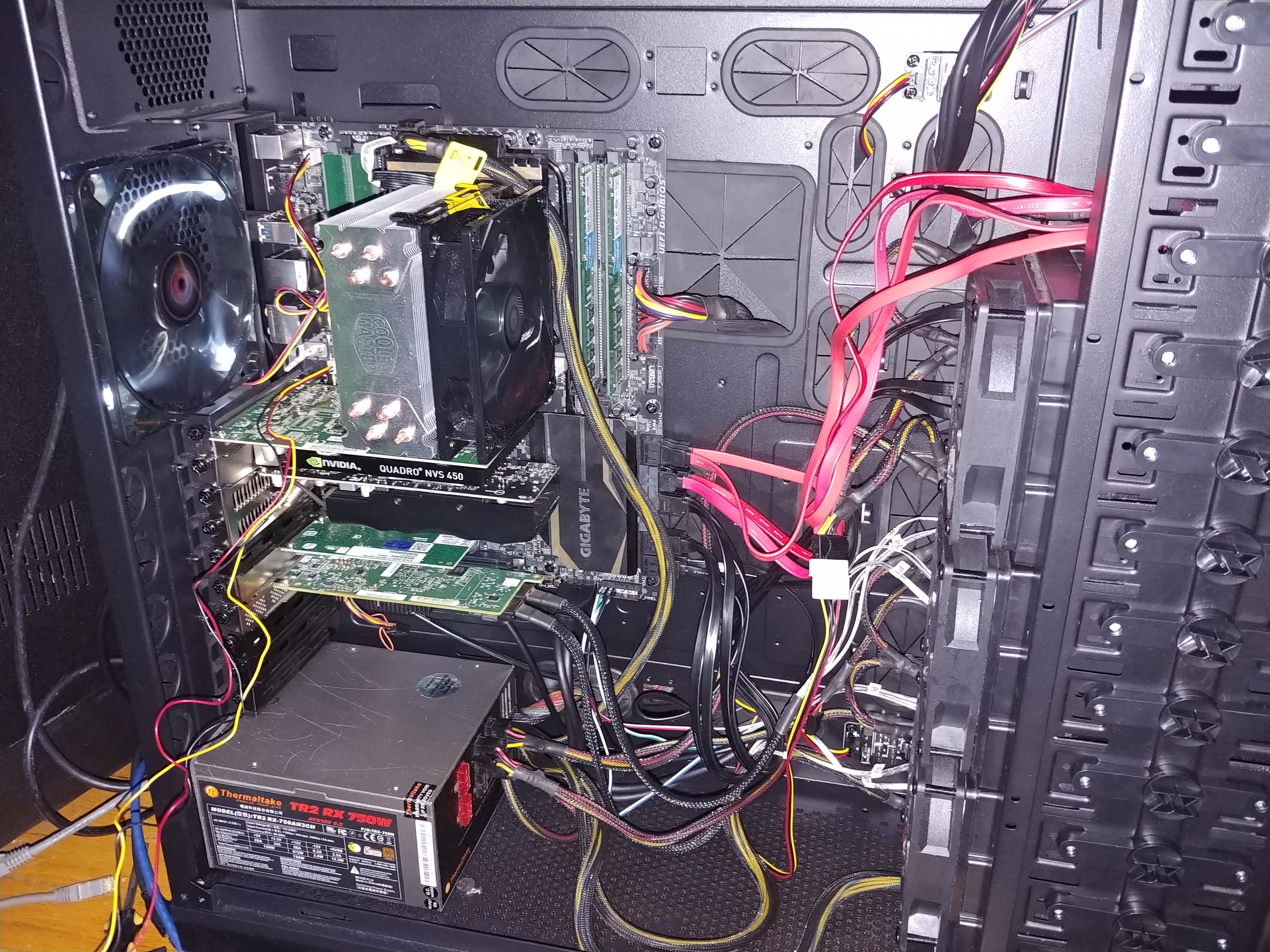

Trust me, I spent days experiment with this.  I don't have another sas card yet so I can't do a comparison tests.  As you see in the picture attached. Nothing is tied down(total mess).

I just noticed the sleaving over the cables from the HBA in your photo.  That's not a huge length to be holding together, but it might not be helping in terms of crosstalk between cables.
It won't be elegant, but I'd be tempted to cut that sleeving back and let the cables hang free and slightly separated.  Then even if they are in close ontact, it will only be for an inch or so at a time.
Edited by S80_UK
At least those cables are foil screened, unlike the regular SATA ones.
