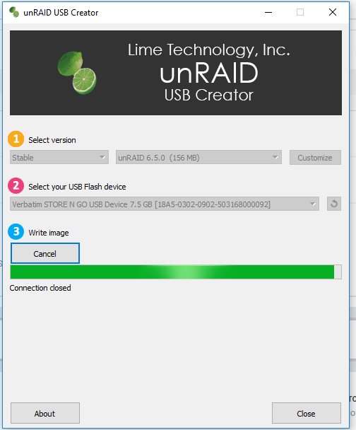

My flash was corrupt after the update to 6.5. After that I tried to put a backup on that flash but the USB Creator tool gives an error (please see screenshot attached).
What can I do?

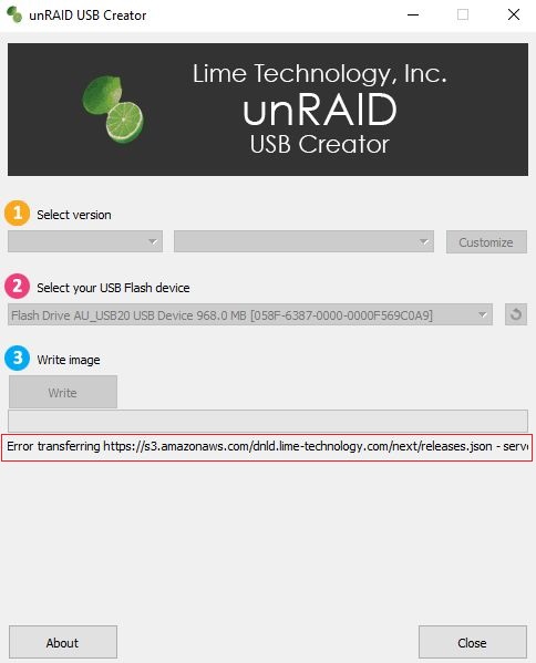

10 hours ago, hawihoney said:
Seems that I do have bad luck today with unRAID.
What can I do?
This issue should be fixed now.

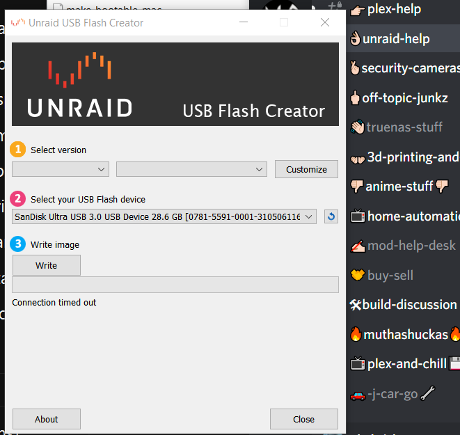

  • 4 years later...
