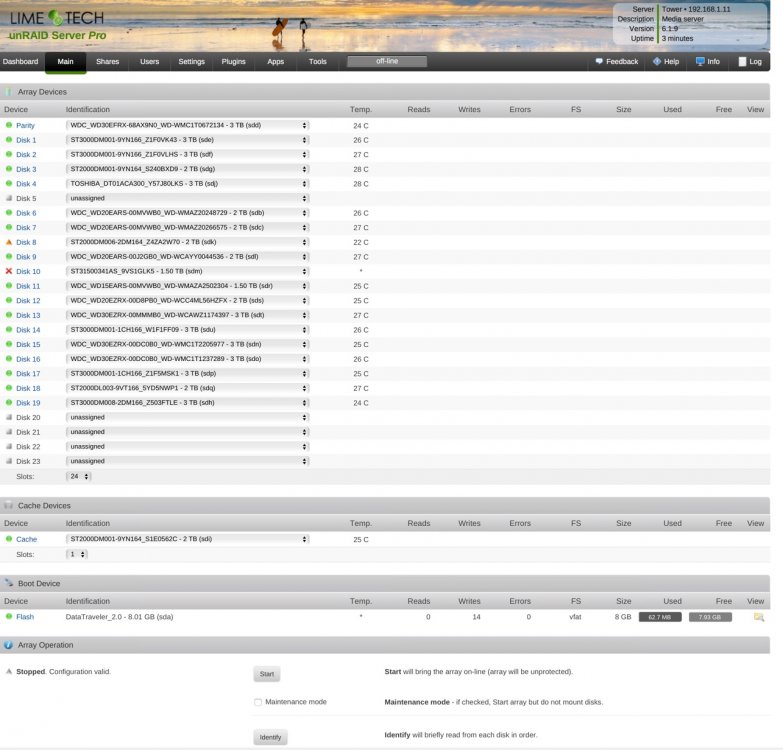

thefly Posted March 14, 2018 Share Posted March 14, 2018 Hey team. Just returned form a vacation to an extended power outage. Upon restarting I was presented with a disk outage (Disk 8 - see image). I shut down and inserted an new drive. When restarting and preparing to initialize, Disk 10 is now showing and error (Disk 10 - see image). Am I in major trouble? Link to comment
JorgeB Posted March 14, 2018 Share Posted March 14, 2018 4 minutes ago, thefly said: Am I in major trouble? Possibly, post your diagnostics, ideally from when the 2nd disk was disabled and before rebooting. Link to comment

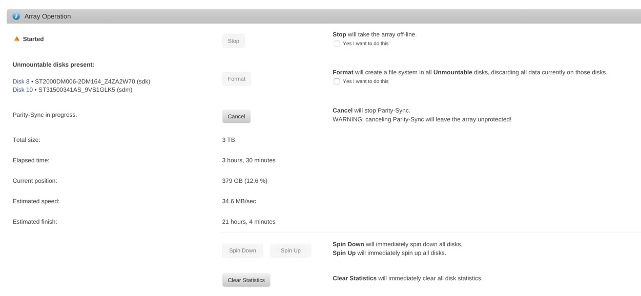

JorgeB Posted March 14, 2018 Share Posted March 14, 2018 Not a good sign disk10 being unmountable, disk8 is likely a consequence of that, but let the rebuild finish and then run a filesystem check on both, it's reiser so there's a good change it's fixable, unless something catastrophic happened with disk10 when it was disable, pity there are no diags. Link to comment
JorgeB Posted March 14, 2018 Share Posted March 14, 2018 Strike that, looking more carefully at the screenshot you're doing a parity sync instead of rebuilding disk8, so rebuilding disk8 is not an option anymore, old disk8, if not completely dead, is your best option to recover that data. Link to comment

JorgeB Posted March 15, 2018 Share Posted March 15, 2018 6 hours ago, trurl said: I saw that but thought maybe the webUI was just wrong about the invalidslot command since it wasn't initiated there. No, either the OP missed a step or invalid slot is not working correctly on v6.1.9, I know for sure it works on v6.2 and newer but it's been a long time for v6.1. OP, you should still let the parity sync finish, this will at least result in a protected array if it's successful, then run reiserfsck on disk10, and finally try to mount old disk and/or post a SMART report. Link to comment

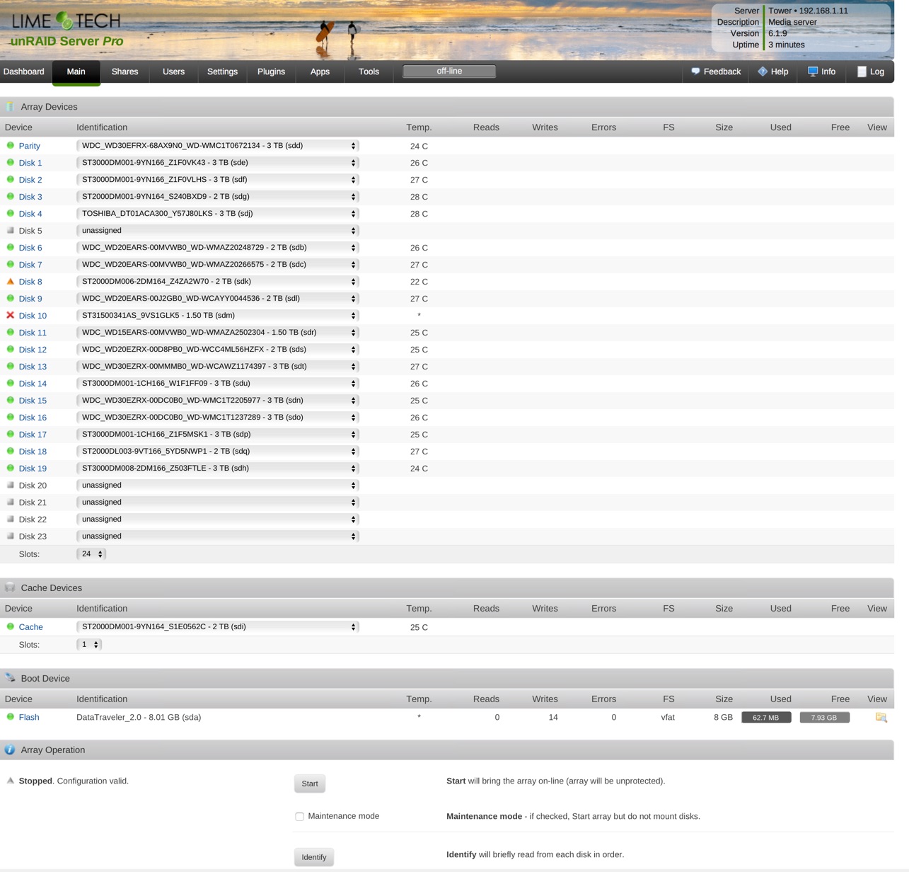

thefly Posted March 15, 2018 Author Share Posted March 15, 2018 Bigger issues now. Created a new config: 1. disk 2 has now disappeared from the selection list; 2. disk 8 is showing the new disk that I previously entered 3. disk 10 is unassigned Link to comment
trurl Posted March 15, 2018 Share Posted March 15, 2018 4 minutes ago, thefly said: Bigger issues now. Created a new config: 1. disk 2 has now disappeared from the selection list; 2. disk 8 is showing the new disk that I previously entered 3. disk 10 is unassigned 1. You need to figure out why it isn't detecting disk2 2. Don't understand why this is an issue. Do you think it should be showing something else? 3. Is there some issue with reassigning it? Link to comment
