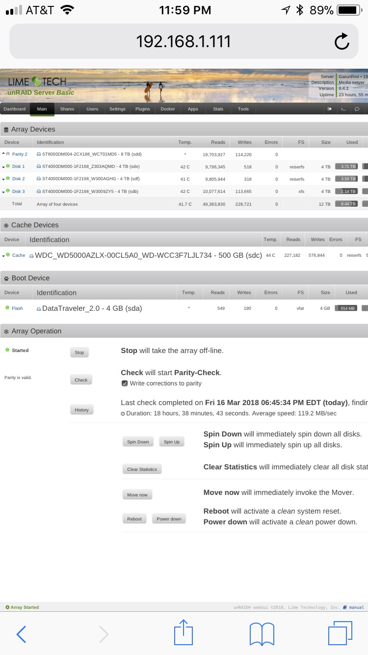

Post your diagnostics. Go to Tools > Diagnostics > Download and upload it here.
Does this only happen in one share?
Does this only happen to files accessed by Plex?
Does this only happen to movie files?
What file extensions do you experience it with in that case? (MKV, MP4 etc)
Does any other apps, dockers, VMs or computers have access to the share?
https://www.dropbox.com/s/f1zsynp6nv3zpsl/garunriot-diagnostics-20180320-0220.zip?dl=0
That's my diagnostics.

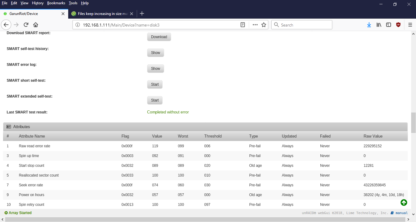

Likely unrelated, but disk2 has a SMART failing now attribute, still this attribute failing might cause data corruption and the disk should be replaced.
ID# ATTRIBUTE_NAME          FLAGS    VALUE WORST THRESH FAIL RAW_VALUE
184 End-to-End_Error        -O--CK   097   097   099    NOW  3

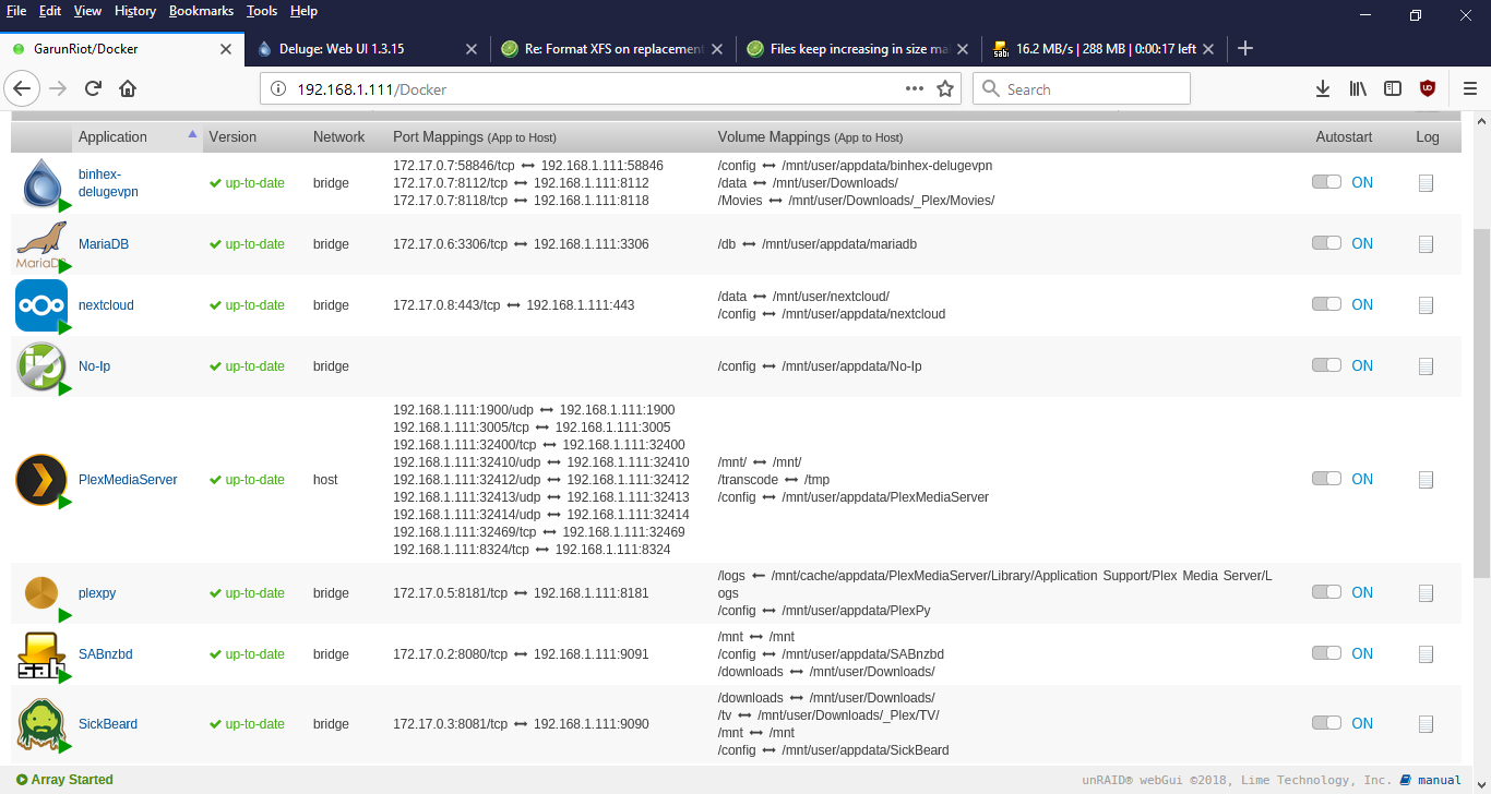

What dockers other than Plex has access to where you store your media? Do you manually move downloads from sabnzbd and Sickbeard or do they handle moving the files?
If it's not file system corruption or mover issues as itimpi suggests, it could be Sickbeard messing up the files. Try download or put a known good video file in your library and stop Sickbeard for a day or two and see if it gets corrupted as well.
No other dockers have access to my server, only Plex.
It’s not Sickbeard but yes i have sickbeard and sabnzbd organizing my shows and movies automatically.

It could be but your SMART data seems okay, other than the 3 end-to-end and sata downshift errors on Disk 2.
If the onboard cache on disk 2 is bad though, that could be why you're seeing these bloated and corrupted files. Do you know what disk the damaged files are stored at?

Could you try to stop Plex, Deluge, SABnzbd and SickBeard, copy a file to the share again and then run the mover? Maybe, just maybe one of the dockers for some reason is doing modifications to the file that the mover can't detect.
1 hour ago, SelfSD said:
From what I can see from that result there's nothing wrong with the file system on disk 3.
How do i stop those dockers?
Click on the icon next to the name and a menu appears. Select "Stop" and wait until the green arrow on the icon turns into a red square.
