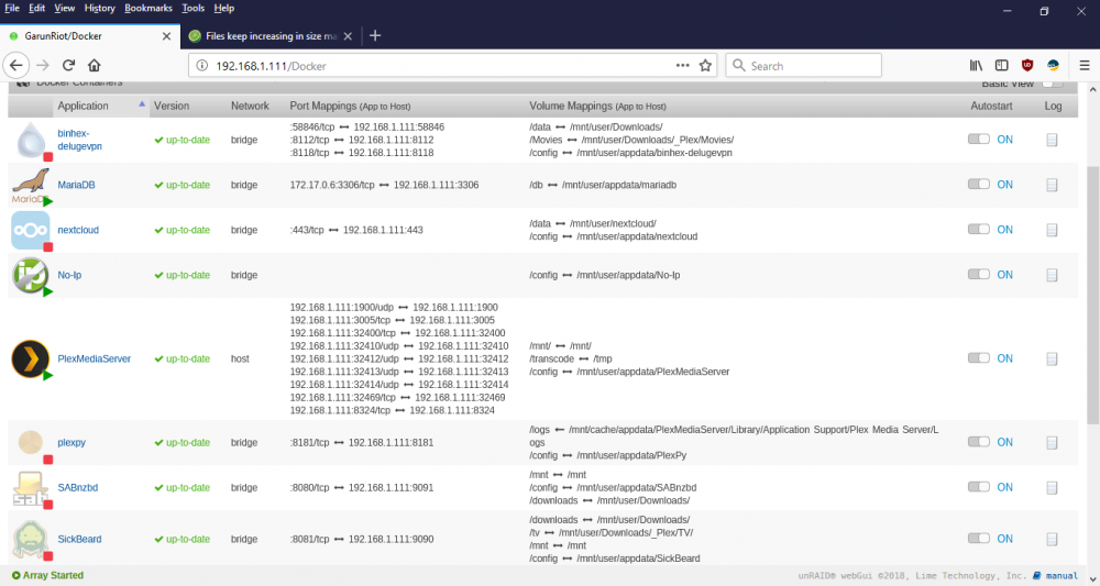

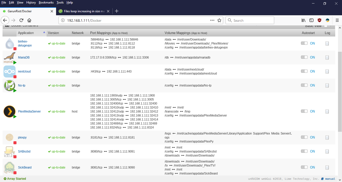

I'm doing an experiment for the next 24 hours. I'm turning off all my dockers except plex media server, no-IP, and MariaDB to see if the newly downloaded videos are still corrupted. I will update you guys on the result tomorrow to see if this is cause by any of these dockers or not.
Edited by gigga45
So after turning everything off last night except those 3 dockers, my new downloaded files are still corrupted overnight which ruled out all of (binhex, sickbeard, sabnzbd, plexpy, and nextcloud). So what could be the issue then? The Plex media server itself or my drive??

So last night I turned every single docker off except Plex Media Server itself, I found many files corrupted just now. So it’s most likely the Plex Media Server docker/plug-in. What do I do now?

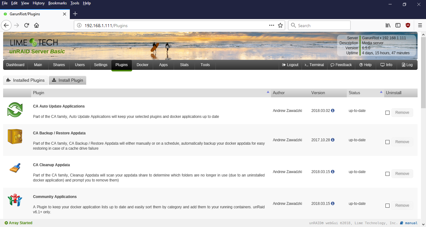

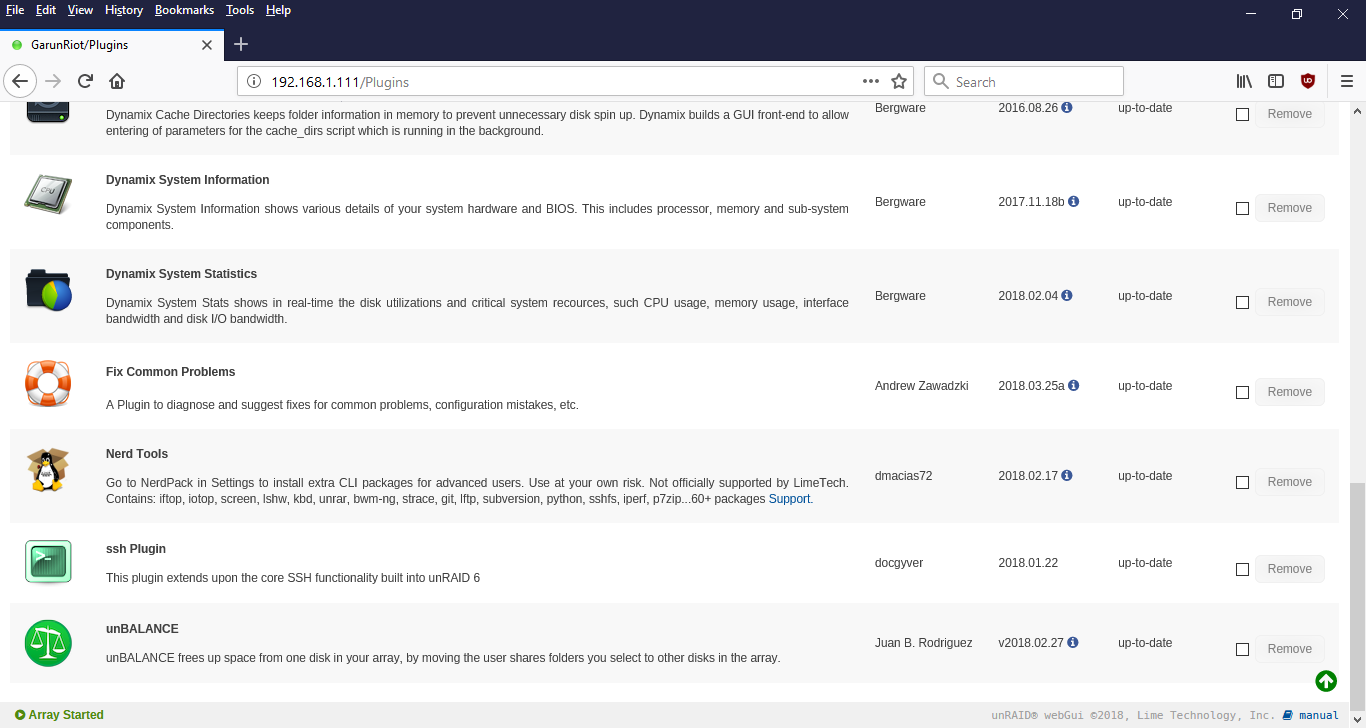

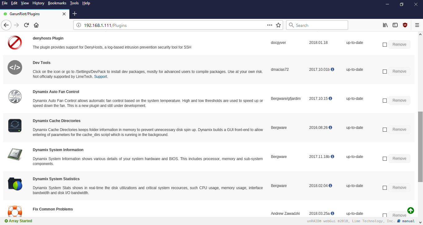

22 hours ago, jonathanm said:
If it is your plugins, you will need to uninstall them, one at a time if you want. Which plugins are you running?
But you replied with a screenshot of your dockers.
which suggests some confusion as to what is a docker and what is a plugin. You are running Plex as a docker. Which plugins are you running?
These are all my plugins.
