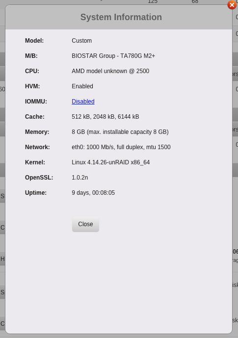

I have been using/running unRAID for about 8 years. I started with a basic build (only upgrade I have done over the period is add more RAM and hard drives), please see attachment for details.
However, now with dockers and VMs running, I feel like its time to upgrade my machine with server grade components. LimeTech has a good server hardware recommendation in their wiki page, but feels like its outdated. I would like to build a system that will last few years without a dire need for an upgrade.
