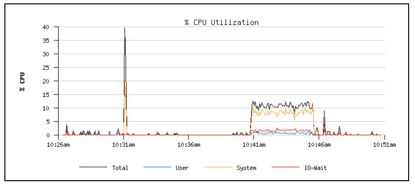

It has already helped me discover a problem I didn't know I had.  I seems when I resume my test server from s3 suspend, disk i/o drops significantly, but not because of i/o wait.... curious.

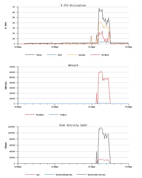

Here a graph of what I have working so far.  The activity was copying a 4.5GB .iso file to disk 1.
