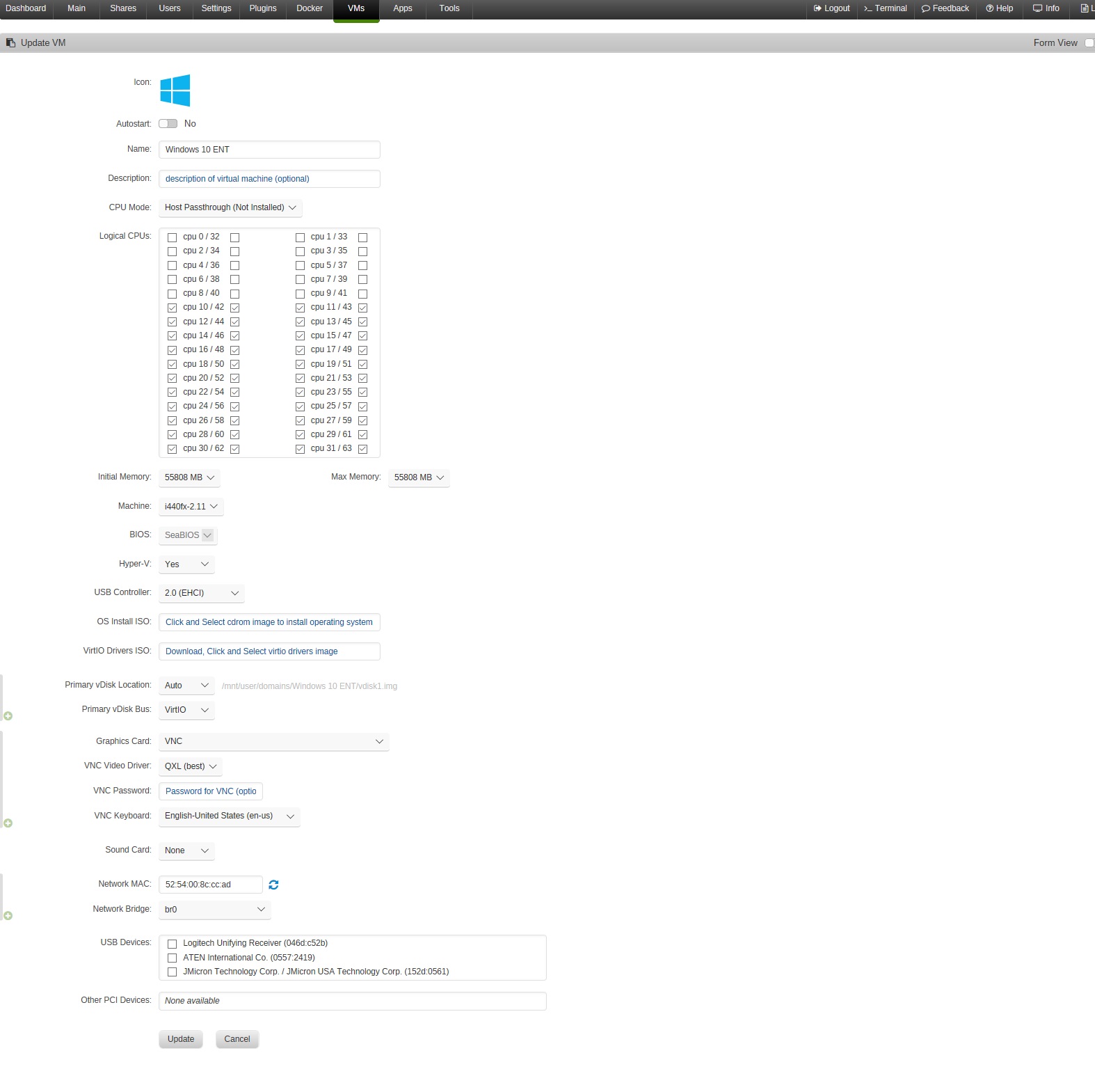

One last thing if anyone know how to install the CPU drivers so it says install would you please help me out.
the last photo show the config and that the CPU says not install. I am wonder if
that is the reason that the overclock doesn't work and all core stay at 2.0 and not boost to 2.55 or more.
Thanks for reading and any help would be great
