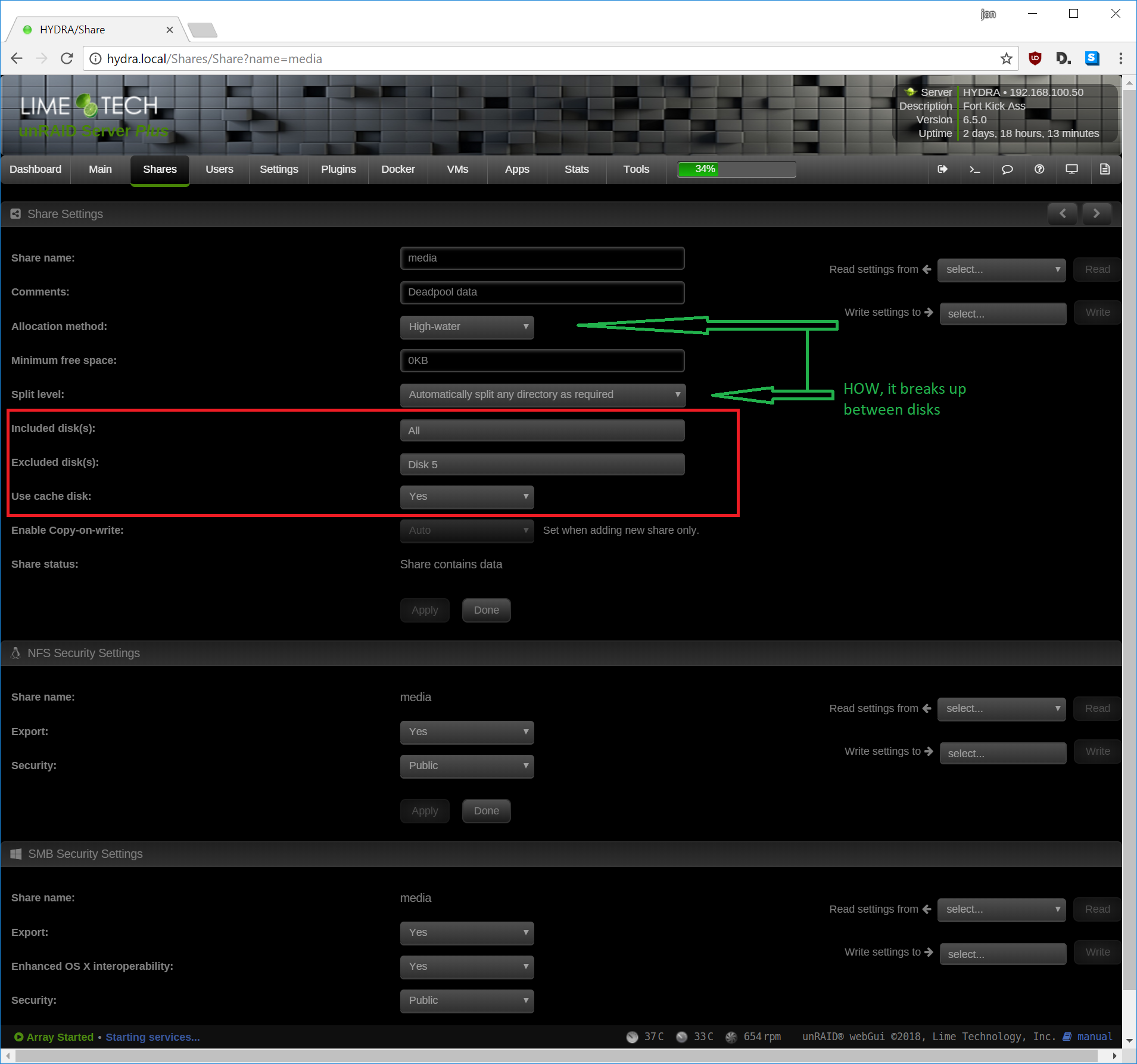

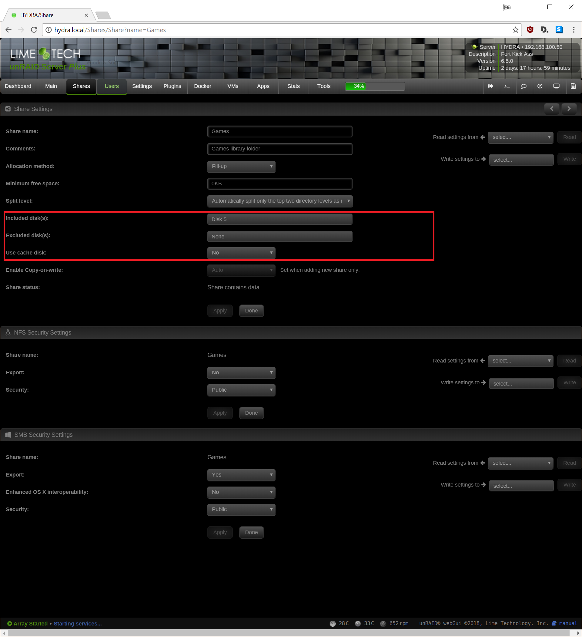

As an example here's a screen shot of the user share I use for Steam games.  In this case, I specified a single disk for the Steam, and it won't use the other disks in my array (I did this because that particular is a WD Black, and most of my drives are Reds).  By default all drives are selected in your disk array. Another example I've, my media stuffs, I've done the opposite.
In both cases I the shares show up as:
/mnt/user/Games
/mnt/user/media
If I go looking in /mnt/disk#/media I will get the broken up directories, but typically one does not need to look at those - just bother with /mnt/user/.
I hope that help clear things up for you.
