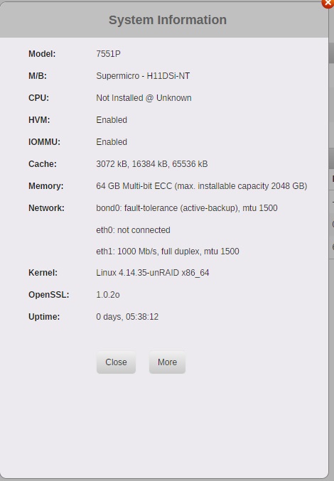

1)- First problem is that UNRAID say my CPU is not installed and I am unsure how to fix this as showed in the photo below marked unraid02.jpg

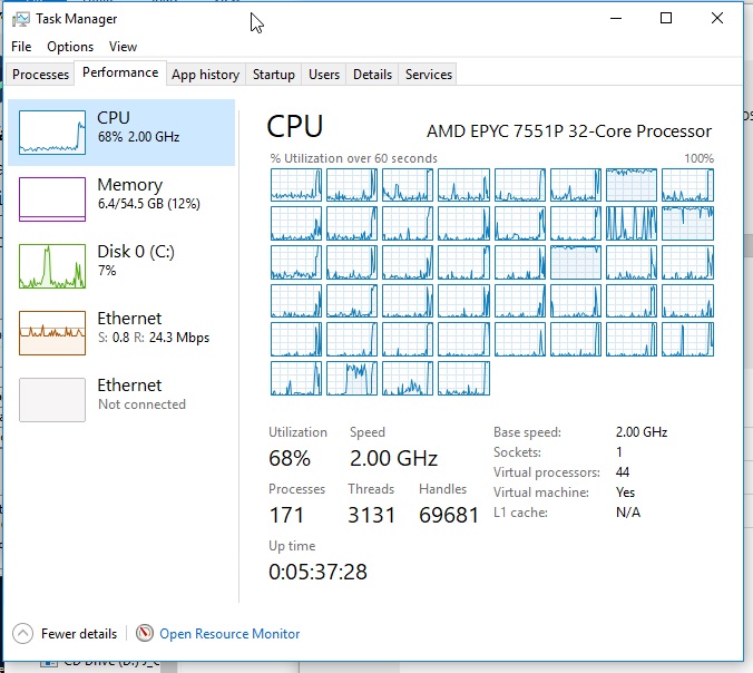

I am not seeing the CPU boost to 2.55GHz or 3.0 GHz. it stays at 2.0 GHz even if the cpuc is being used 100%. I am wondering if this is because the CPU driver or

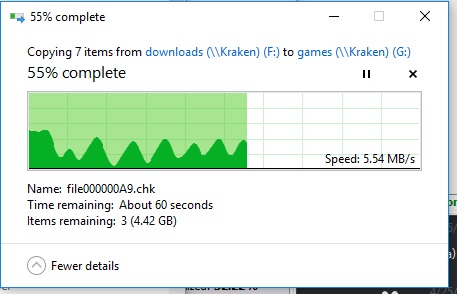

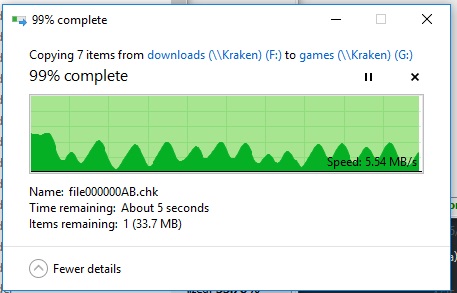

I am copying from from the share or loading a app but it is very slow I feel considering the NVME cache, the hard drives and the system.
I'm not sure if it's because it's a VM, since this is the first time I'm running all my apps in a VM. Photo unraid01.jpg
I tried to get a better photo to post but that one show how it starts off fast then goes much slower.
On some transfer it drops down to KBs and I'm not sure why.

Clearly you do have a processor installed! The lack of information in the System Information window is just cosmetic because your CPU is correctly detailed in the lscpu.txt file in your diagnostics so it will be something simple like its identification string not being recognised.
VMs only report base clock speeds.

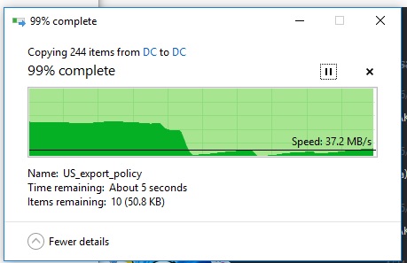

In your Windows file copy example you are copying a lot of very small files. 10 remaining (50.8 KB) so an average of 5 KB each and each carries a significant network and file system overhead. Try copying one or two very large files (10 GB or so) instead.

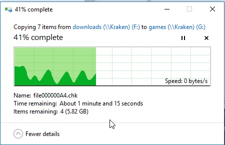

Okay I have done the copy with 7 files 10GB total and the speed goes up and down sometime even going real slow to look like it stop. each file is no less than 1GB and one that is 2GB
