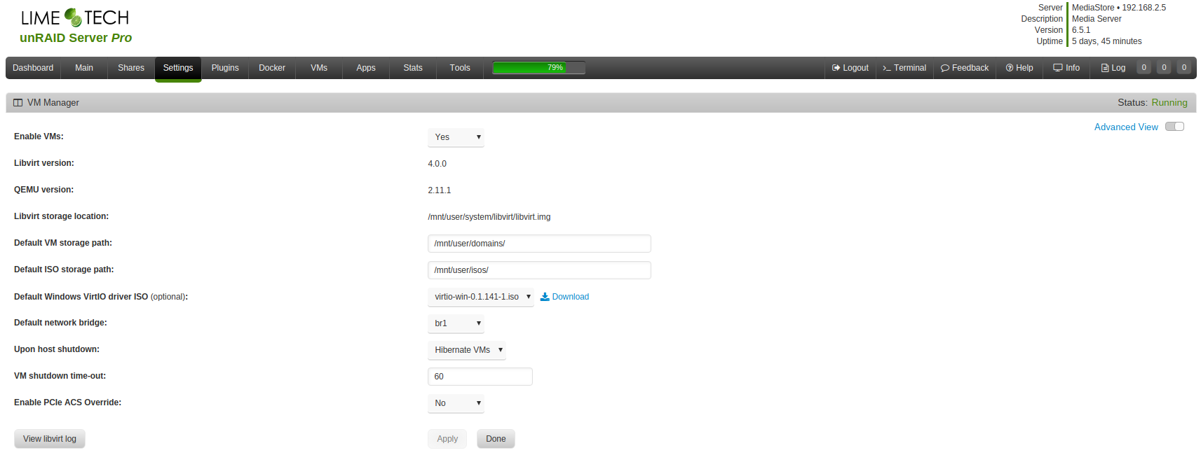

Your network settings are back to the defaults which means that virtual machines will be using vibr0 (VIrtual BRidge 0) and thus be in an internal host only network that is NAT'd out to your LAN
You need to change the setting to use br0 instead, which is tied to your NIC interface and thus become visible to your LAN
I'm using br1 as my NIC interfaces are not bonded together.
I don't have a br0, but I did have a vir, so I deleted and restarted.  That cleaned it up.  Thanks.  I know this is self induced from updating firmware, but maybe someone can make better sense of this in the future.  Cleared it all up.  Thanks!
