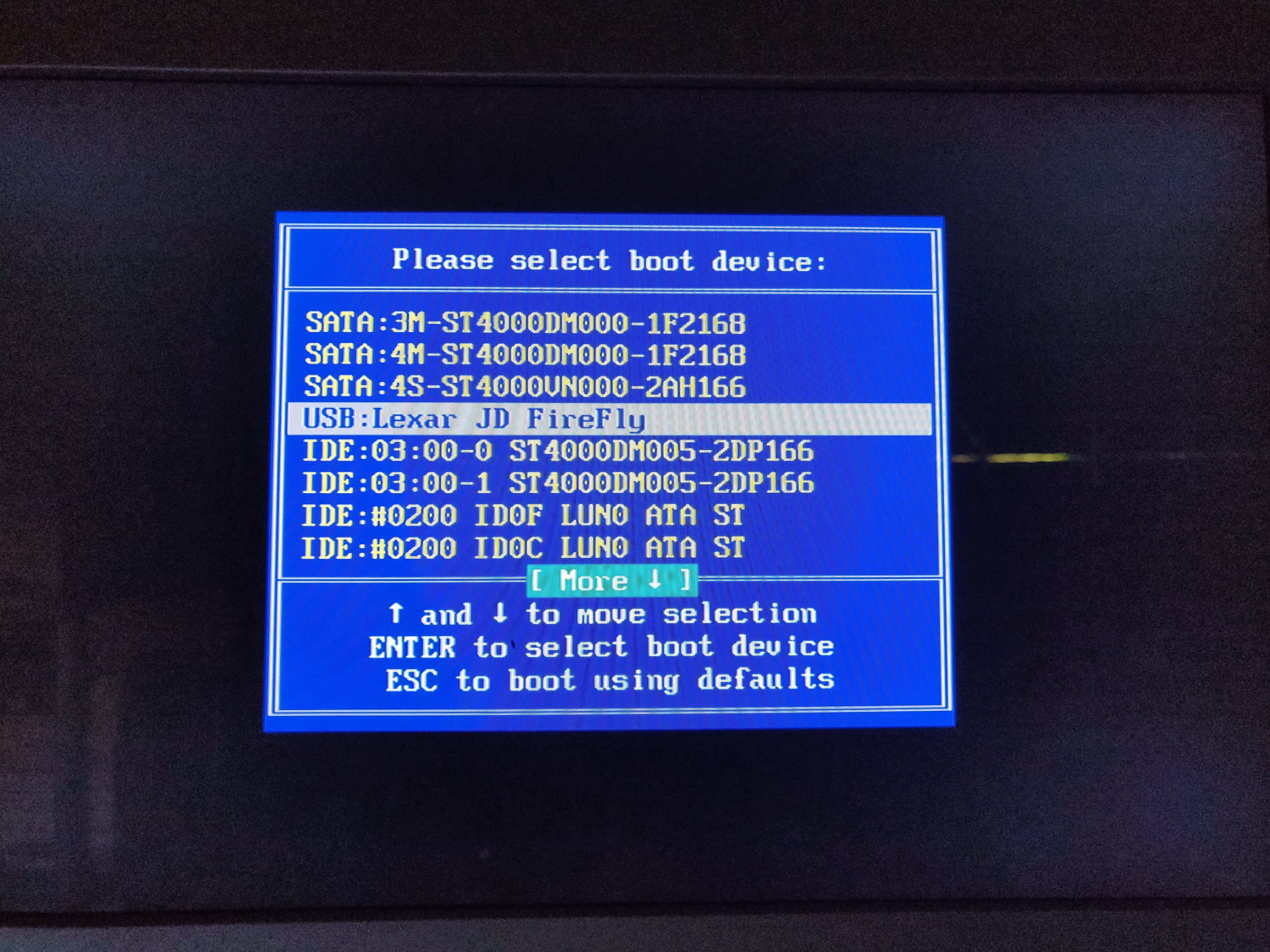

- As you can see the USB drive shows up when I press F8 and select it to boot.

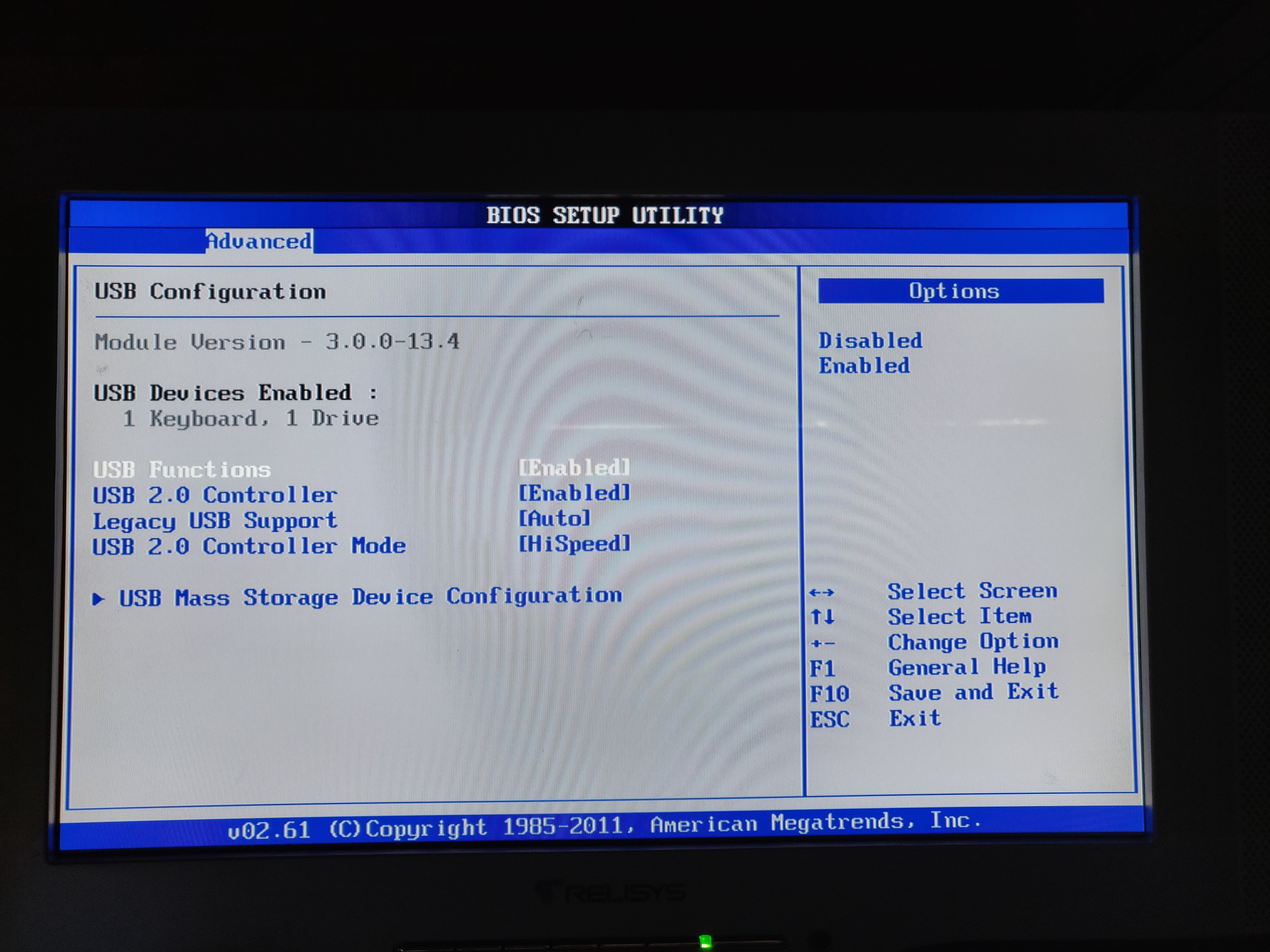

- These are my USB settings

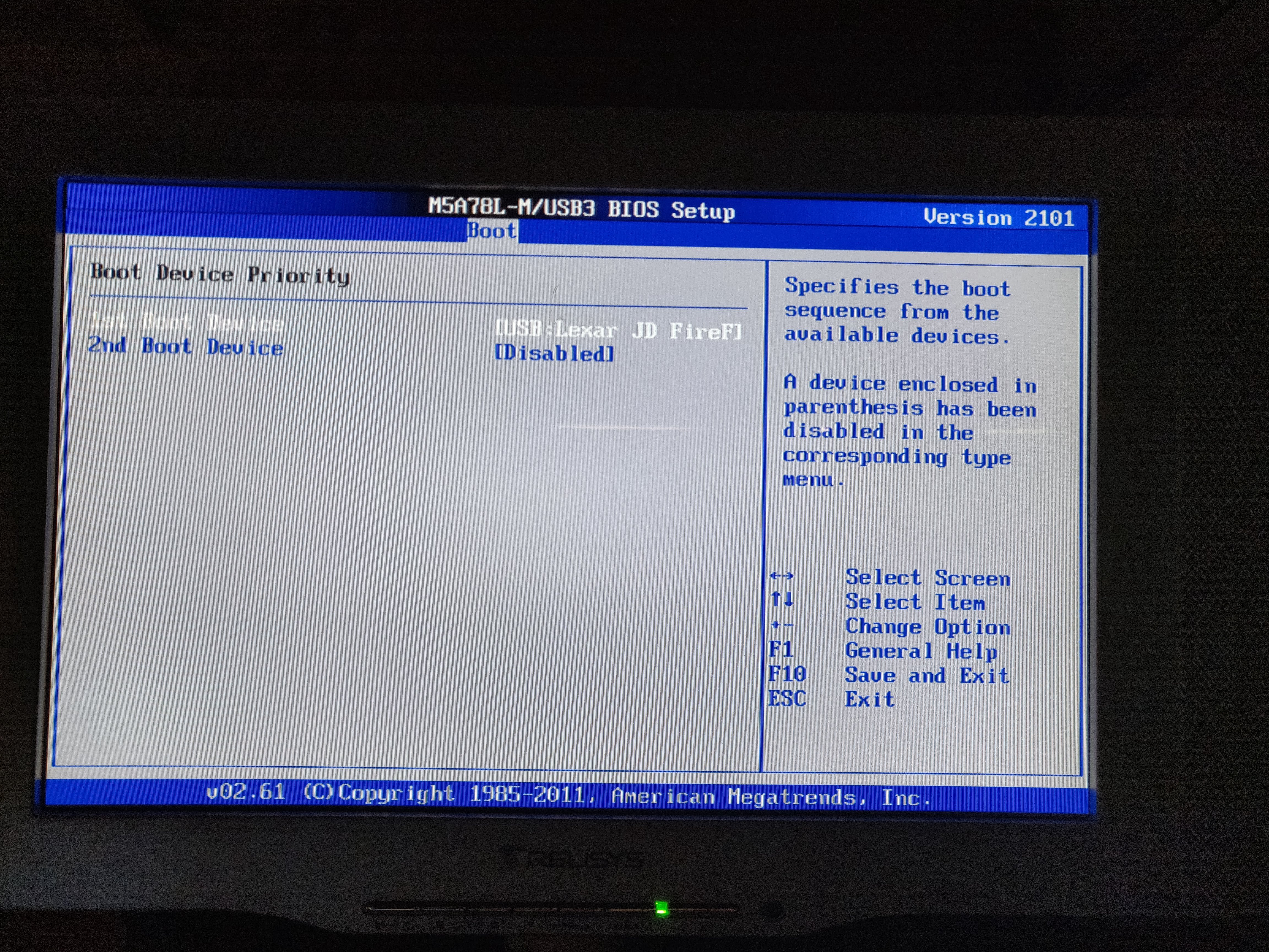

- This is my boot priority, it states than any device enclosed in parenthesis is disabled, which the USB drive is.

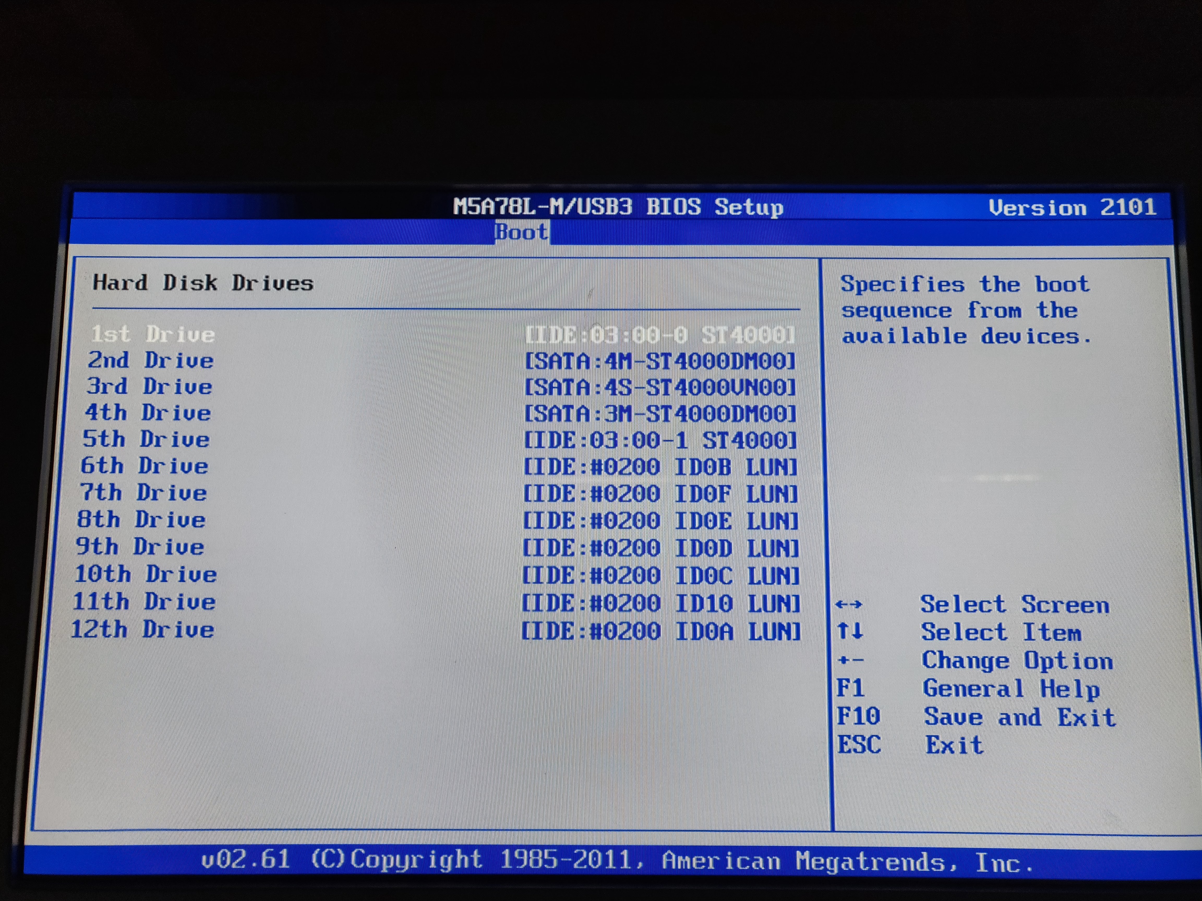

- This is a list of drives available to boot. I could have sworn I've seen the USB drive there over the last week but it's not there now. For some reason it lists many IDE drives that don't exist.
