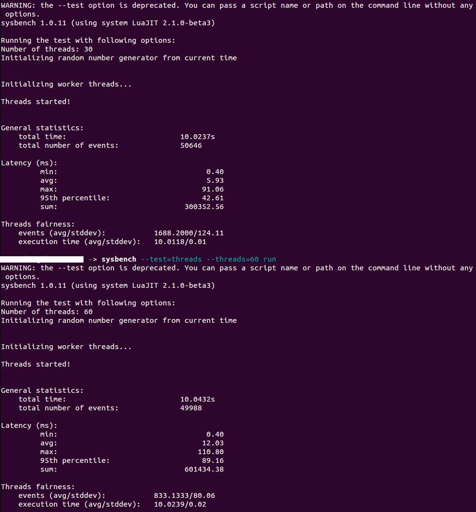

Hi, thank for the reply but I believe there is a bit of a misunderstanding. I probably need to rephrase.
i would like to know if qemu/kvm has a problem or maybe increasing overhead if the VM have a lot of vCPUs.
Most people if the forum are normal users with 8-16 cpus running games, flex etc. My case is of high performance multi threaded computation.
i feel that kvm/libvirt is hintering the VM when many cores are full.
Any know issues with this?

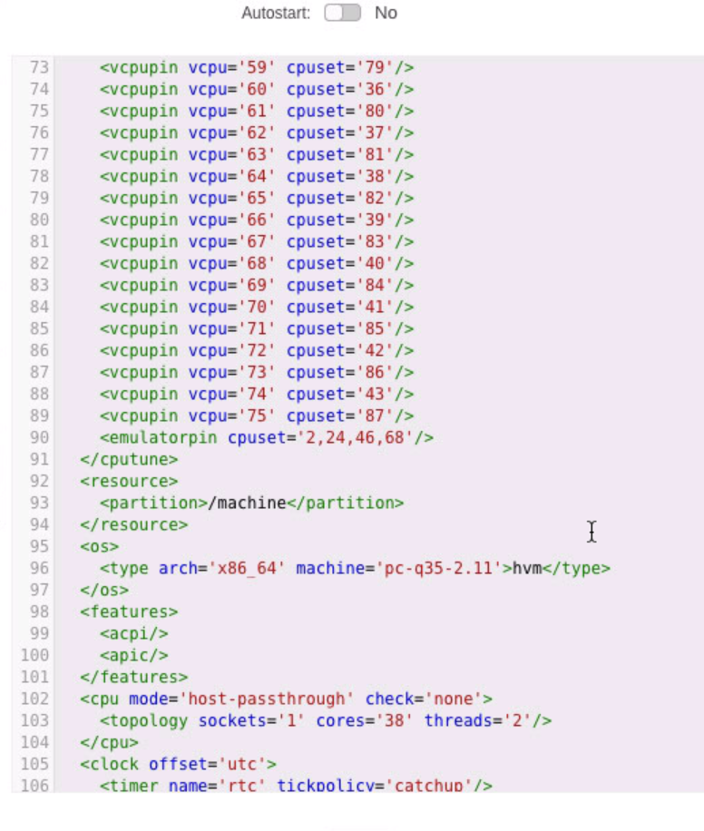

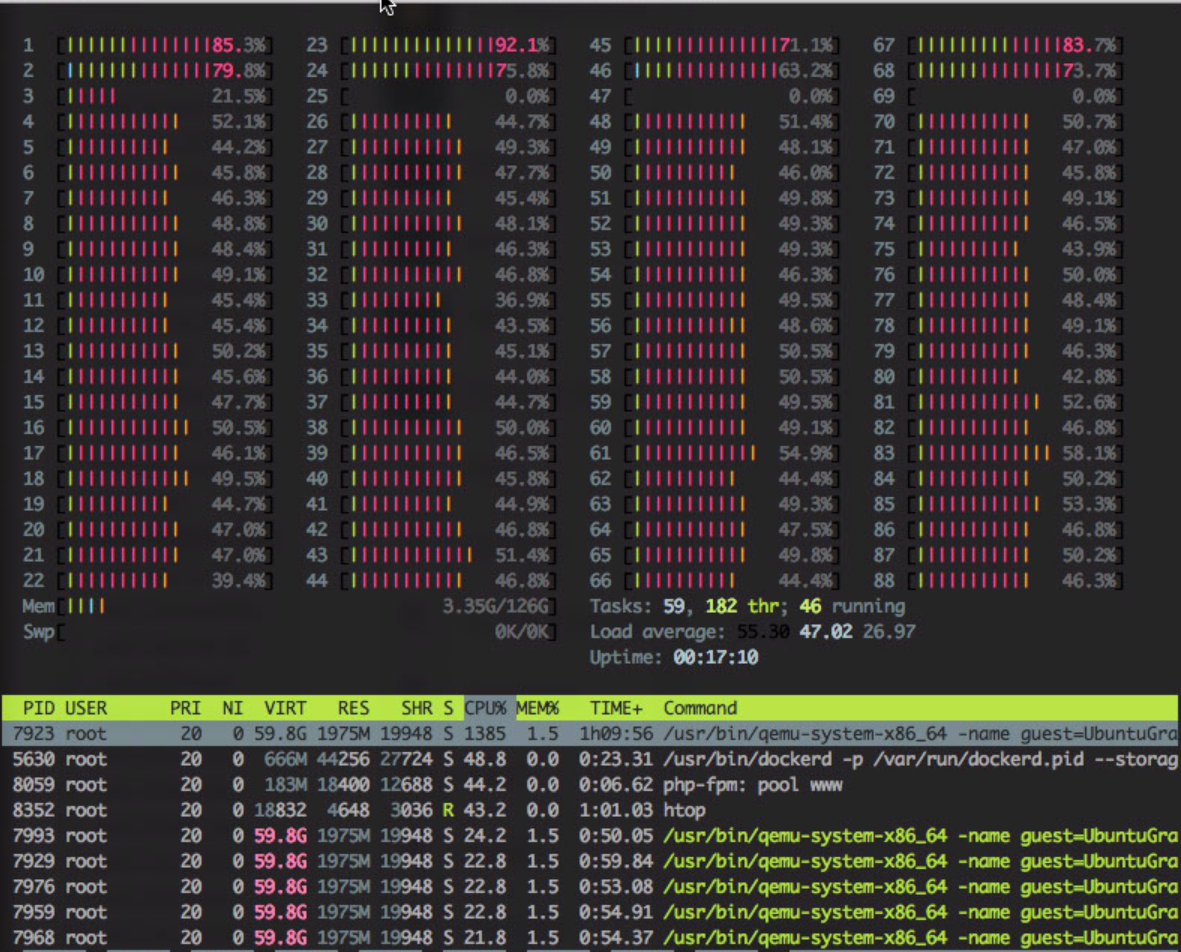

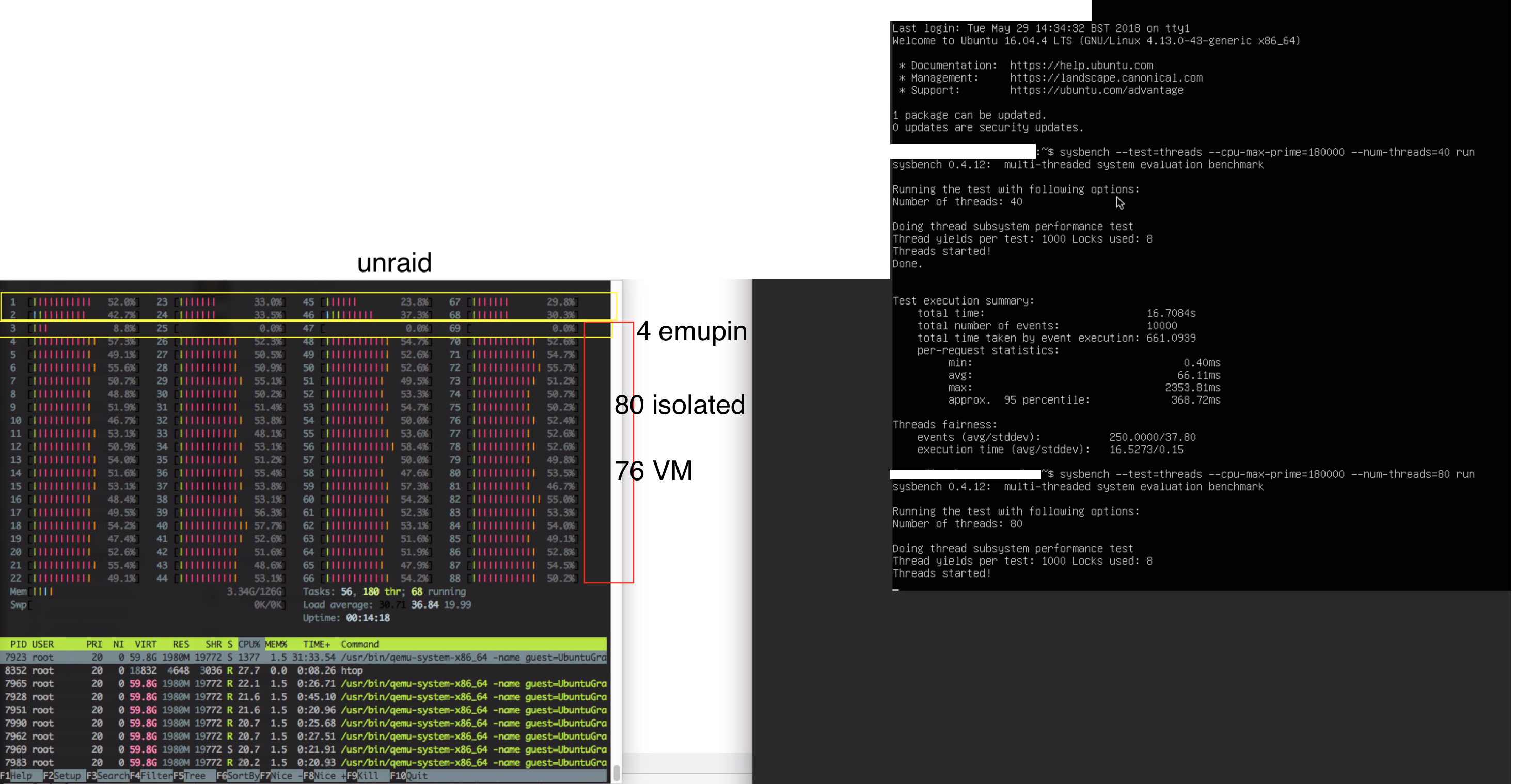

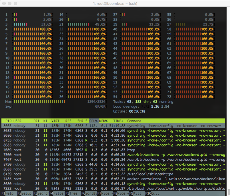

So I isolated 80 cpus, from that I gave 4 to emupin and 76 to one VM.
As you can see it seems that the leftover cores for unraid are going crazy instead of the emupin cores..
At times (htop image) unraid WEBGUI is extremely slow and you have to wait 10 sec to refresh the VM or docker page.
append isolcpus=2-21,46-65,24-43,68-87 initrd=/bzroot

your emulator pin assignments of 2, 24, 46, 68 in the xml are boxed/identified as in your unraid grouping, with the emulator pin box 3, 25, 47, 69 having nothing assigned to them. So thats why you are seeing activity as you described.
Htop starts counting cpu cores from 1 as seen in the screenshot  and unraid assignement starts from zero. Got me a few times as well so i always check on the unraid dashboard for core utilisation instead.
yes exactly. The cores are the same its a numbering issue, this is why I added the image as it was weird for me to understand.

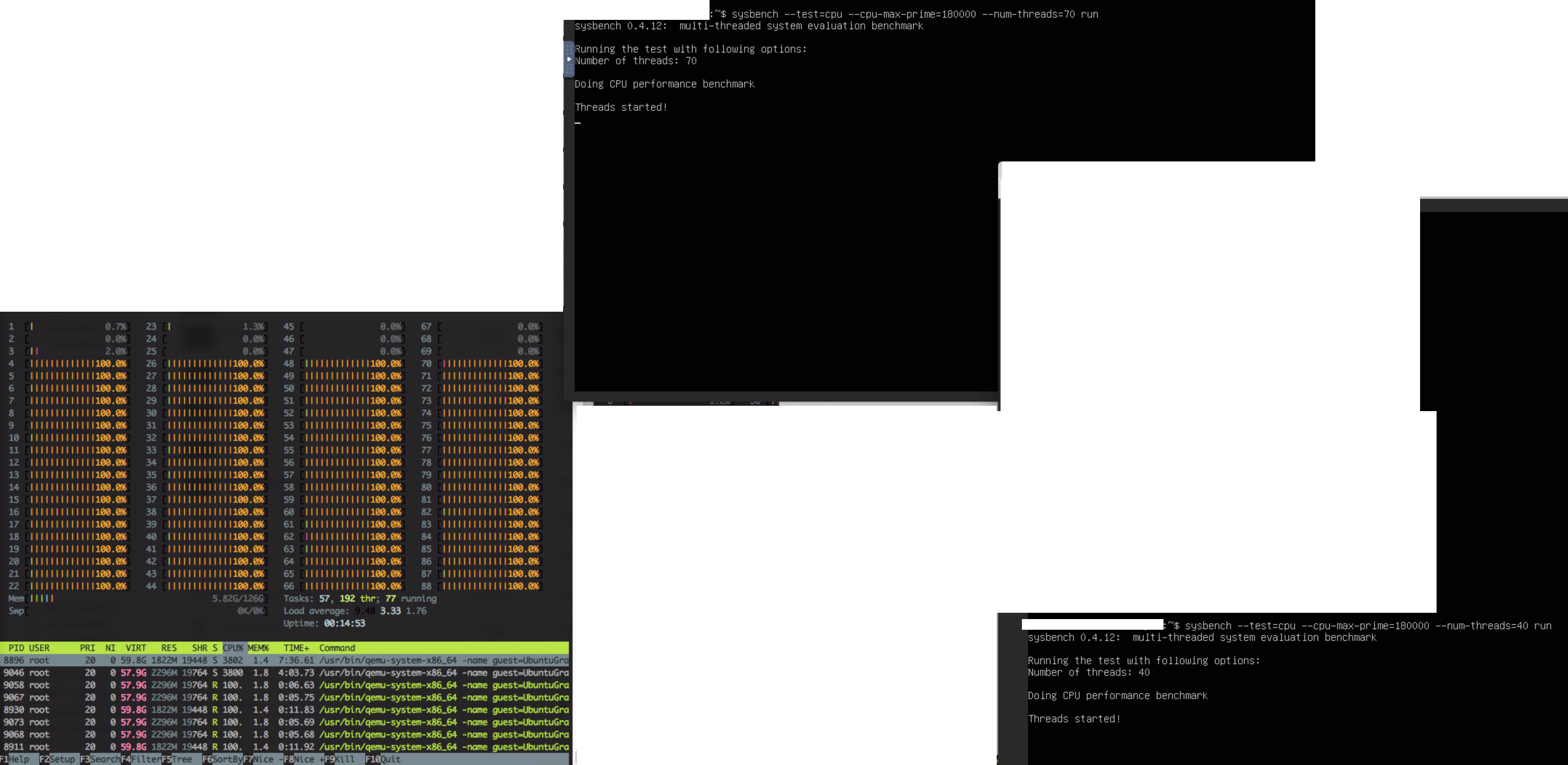

As you can see the emupin are almost free (a bit of activity on one core) and the remaining unraid (un-isolated) cores are almost maxed out! even the webGUI is slower

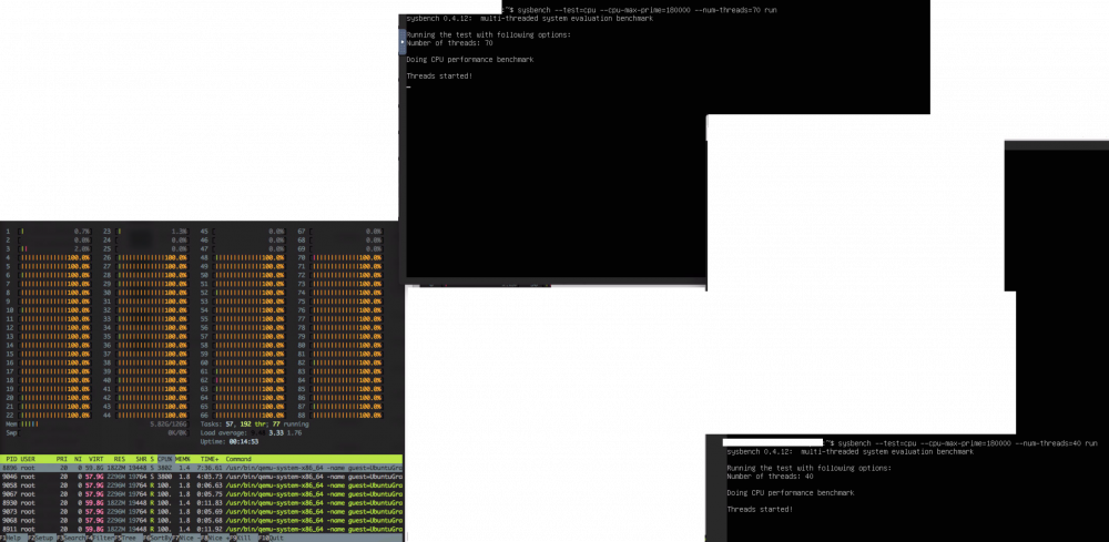

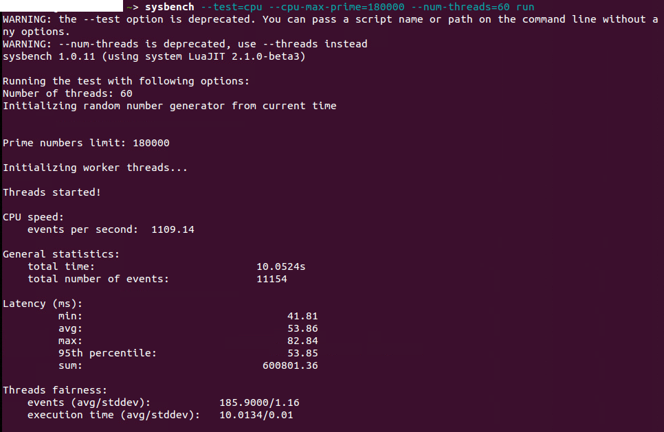

I run sysbench on my 'workstation' hardware based on supermicro and 60 core VM rum with almost ZERO utilisation on the remaining cpus :S
Look at this results from a dual 'Intel(R) Xeon(R) Gold 6154 CPU @ 3.00GHz': (BLUE ON htop is just docker/syntching, nothing to worry about).
This time I had NO emupin and all 60 vCPU are isolated. Look at the sysbench latency too, nice and cool.
Whats should I do on the HP 380g8 as a troubleshooting steps? reset BIOS settings?

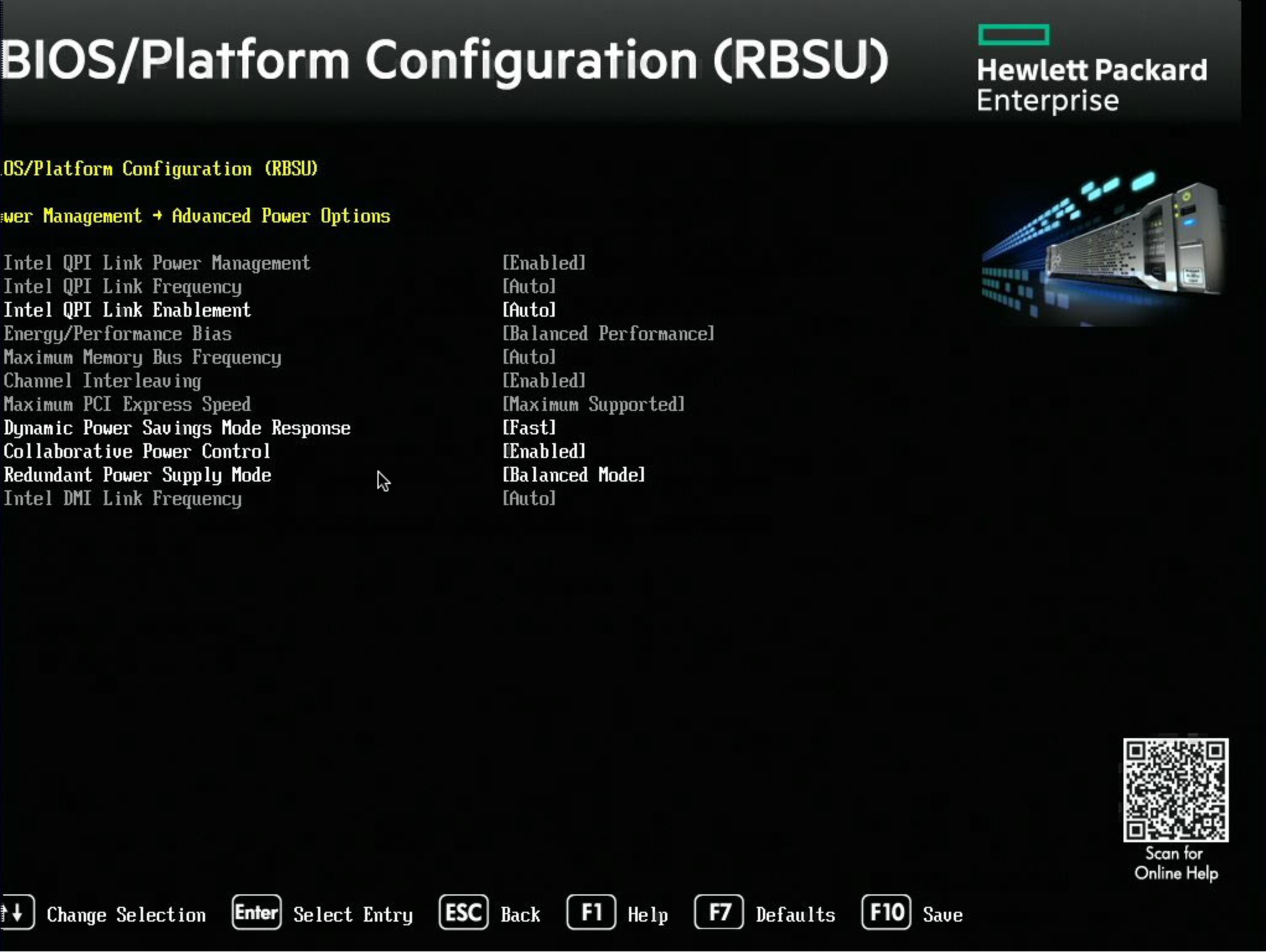

hi all,

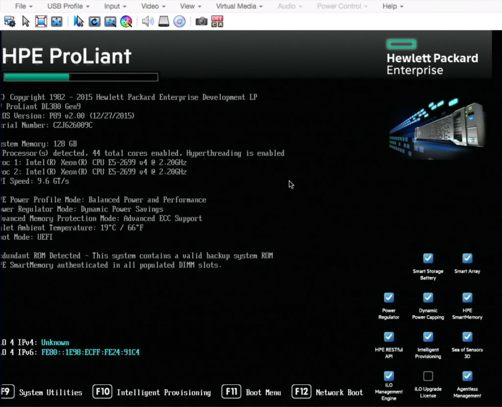

a full "reset to manufacturer settings" on the HP 380 BIOS helped a lot!!!! ? definitely no overhead and higher CPU clock speed. CPUs are 2699v4 so turbo speed seems to be 3.6Ghz. At the moment I can see some cores going up to 3.2-3.3Ghz but I think its ok as the full turbo is for some cores only?!?! (right?)

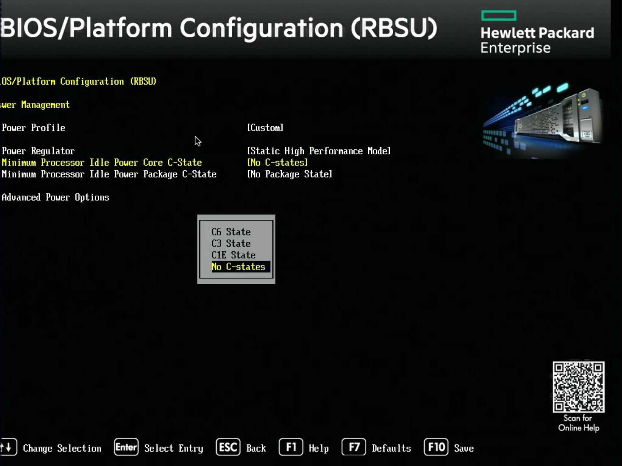

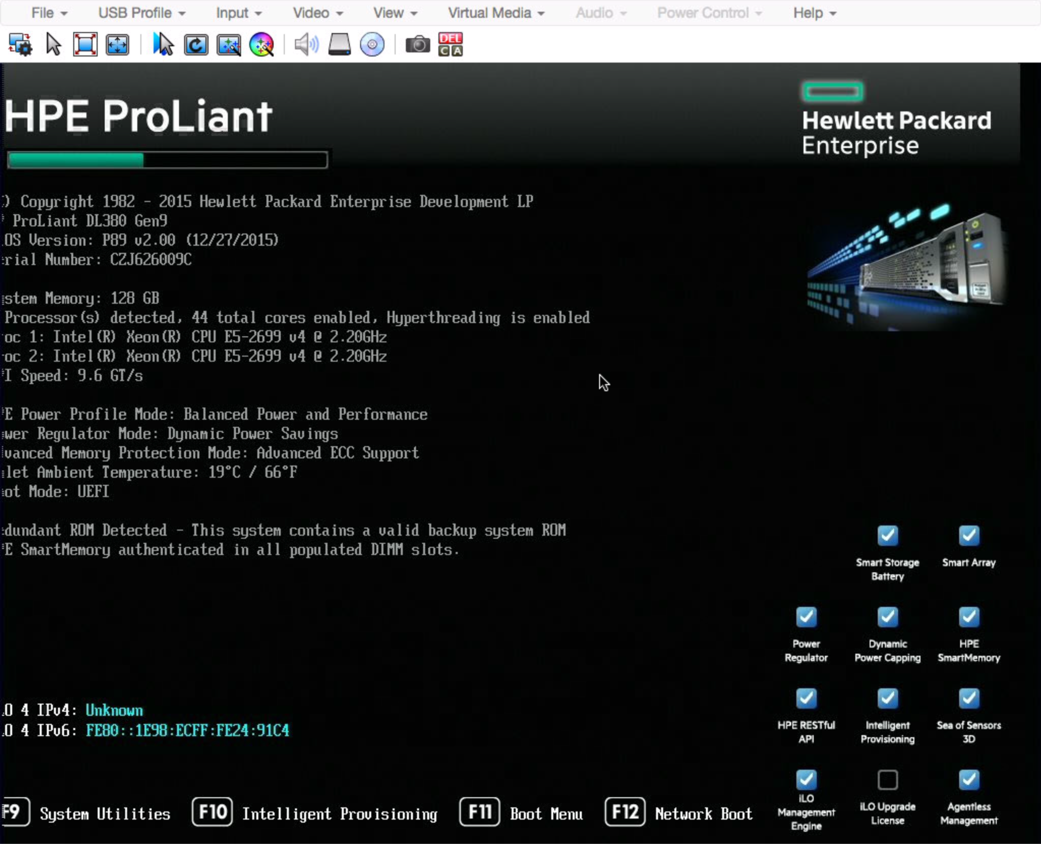

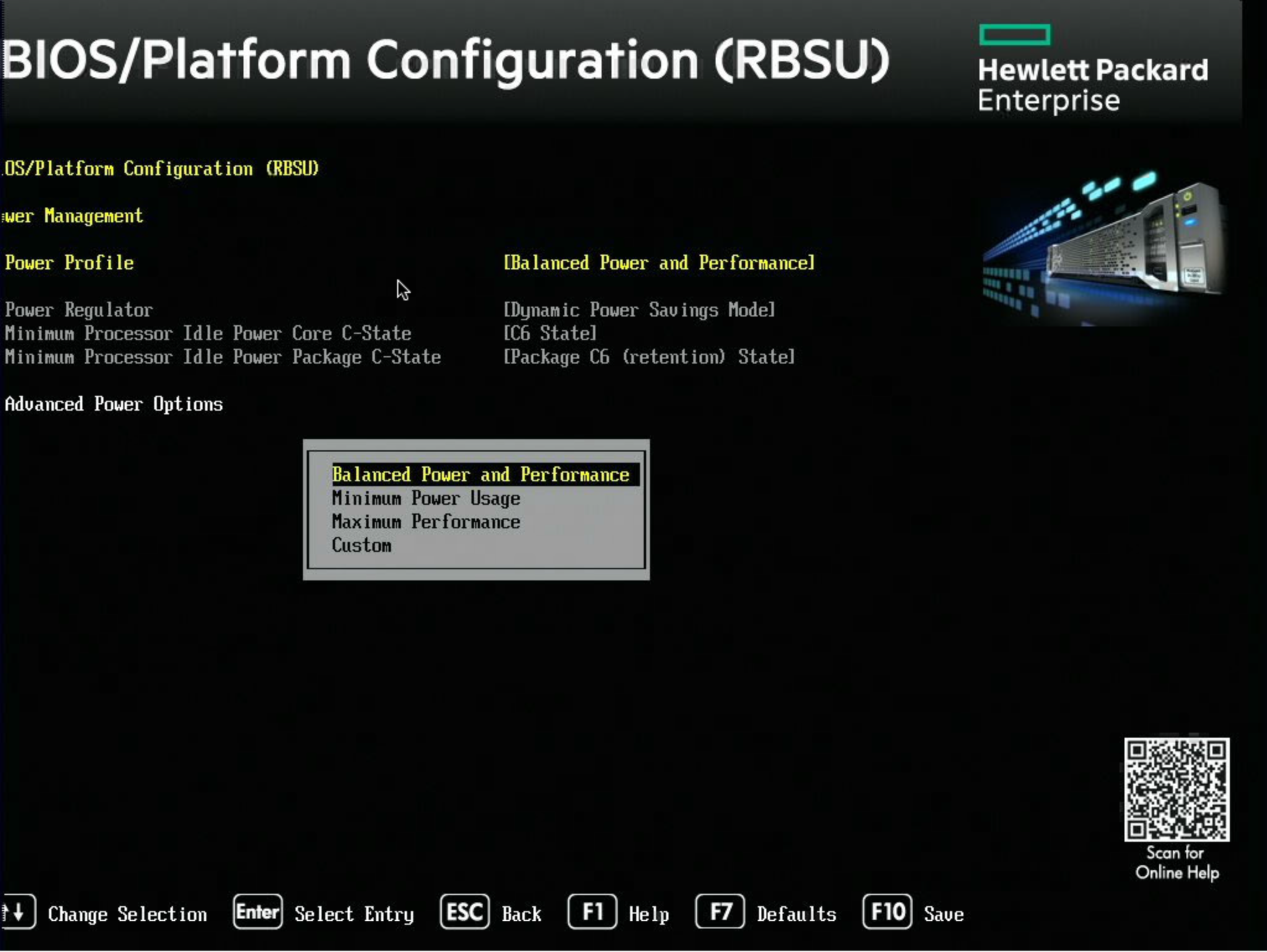

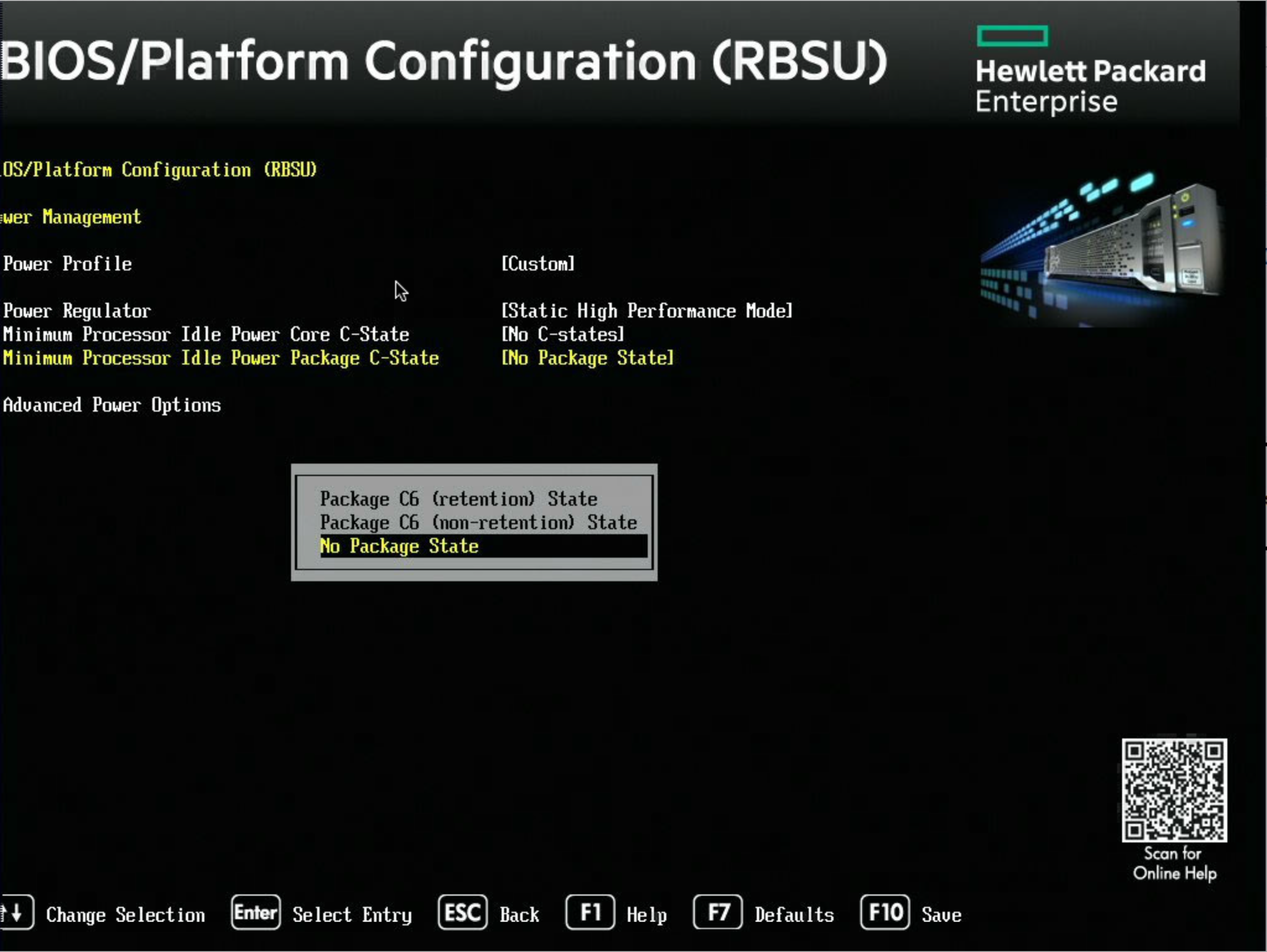

Regarding Proliant seetings, here is a tour of the BIOS and the possible settings.
-At the moment I run the "Balanced" setting from the BIOS and the Performance setting on unraid Tweaks.
The custom options seem similar to the settings you posted above but Im not sure.

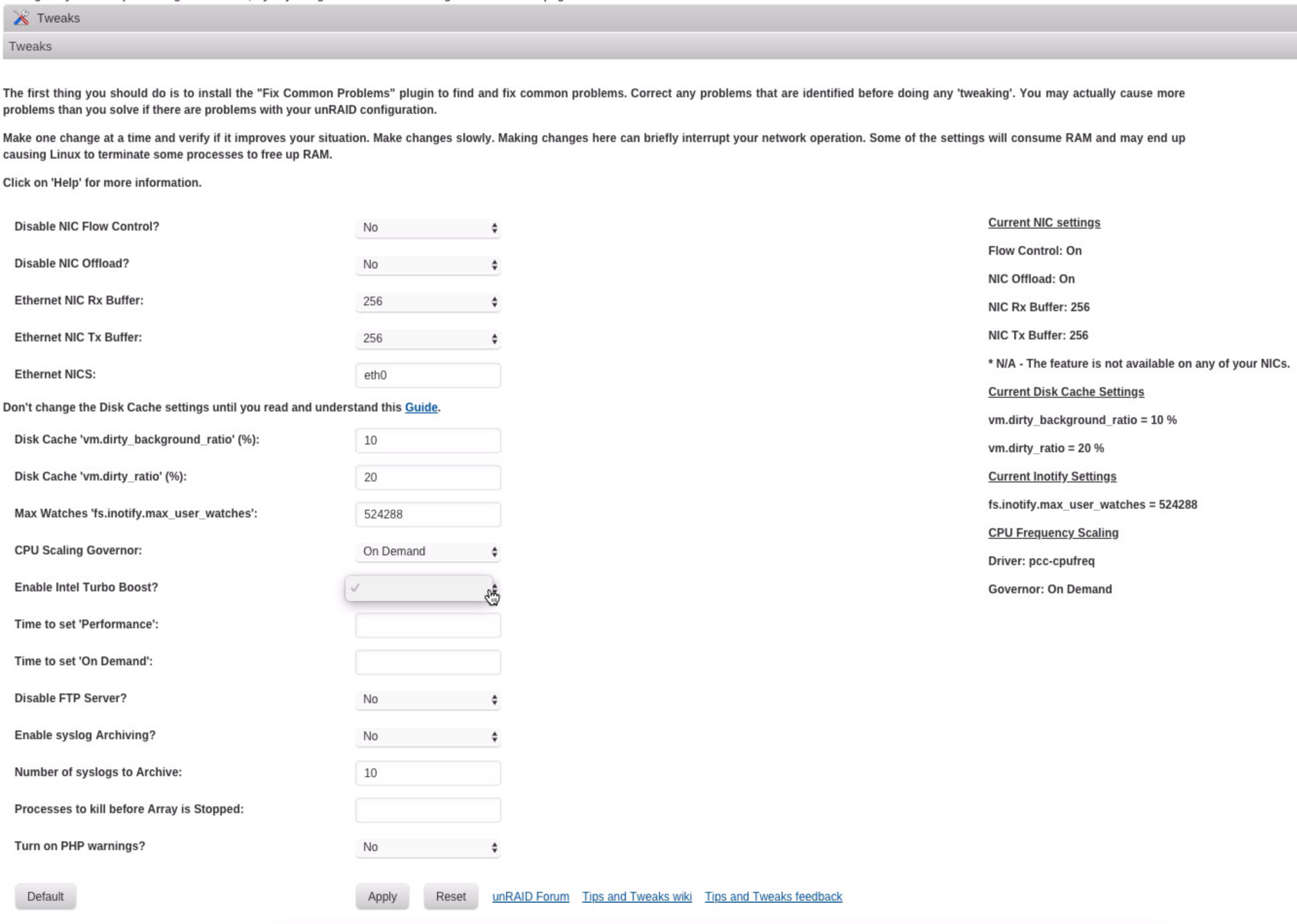

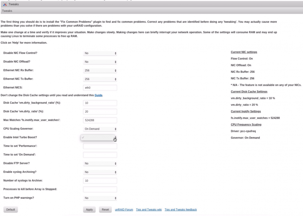

There is no TURBO setting on Unraid though!!! :S

So with basic/auto 'balance performance and savings' mode: no overhead to non-pinned/non-isolated cores at all!!! :):):)
I had the same in my Dell Server (T630 with dual Xeon E5-2640 V4) and it turned out that I set it to manage its power/turbo by the BMC not the OS, changed the setting and now the unRAID does the work!
I've no experience with HP servers but I'm sure others have ;)

How did you get to go with so many cores in OSX ? Whatever i do am stuck at 32 vcores. Have a dual 2697v2 supermicro board.
Whatever combination i try of sockets, cores , hyperthreading, anything that ends up above 32 and crash during boot.
32 or lower and all great .
running clover based sierra vm and would like to assign 40 vcores and the rest for unraid.
Did you do anything specific in clover ? Any specific machine type (tried to change but crashed like a madmen, now on model 14.1) or other setting that makes it work ?
Was almost convinced it was a hard limit untill i found you and a few others running way above 32 vcores.
Remove the topology from the xml. As an added bonus It will actually use all the cores to 100% then as well vs limiting the second “hyperthreaded core” to 80ish percent. I did a bunch of testing a year or so showing it.
For definition I used 14,2 and no special changes in clover.
When i do that it does boot with 40 vcpu and at first glance it all looks perfect. But most programs i start crash immediately. Even terminal.
Geekbench looses the 64bit option and only shows the 32 bit option , which is interesting. It dies when i try to run it.
I have heard of this behavior but only above 64 cores. I am running 14.2 as well btw (was a typo before).
Can you show me an xml of your working setup with 32+ cores please . Maybe i miss something obvious.
I've never experienced the behavior you describe nor ever seen above 64 cores as it requires modifying several components in OSX at the core level last time I checked.
Here is 60 cores
