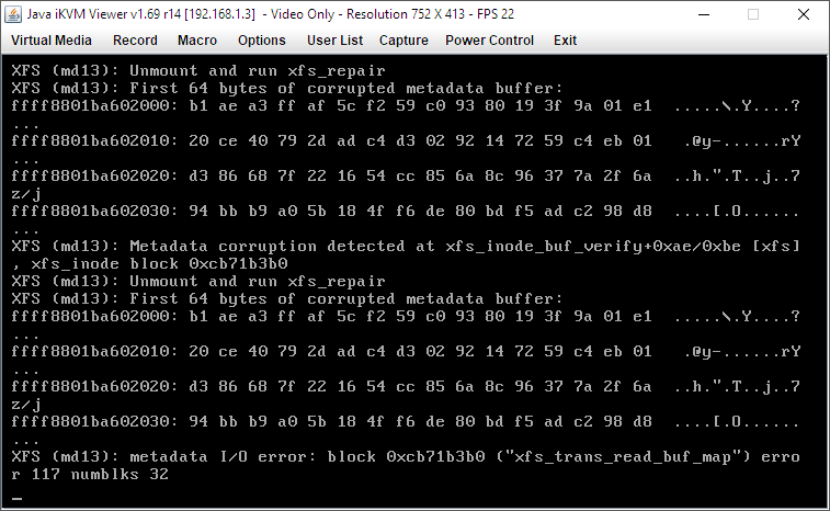

My Unraid suddenly reported a drive problem. The drive cannot be mounted. I know this from unraid website.
I tried rebooting my Unraid. But my Unraid cannot properly boot. It stuck with error message.
Ive attached the boot log and the error message in console which I recorded through IPMI recorder.
Please advise.

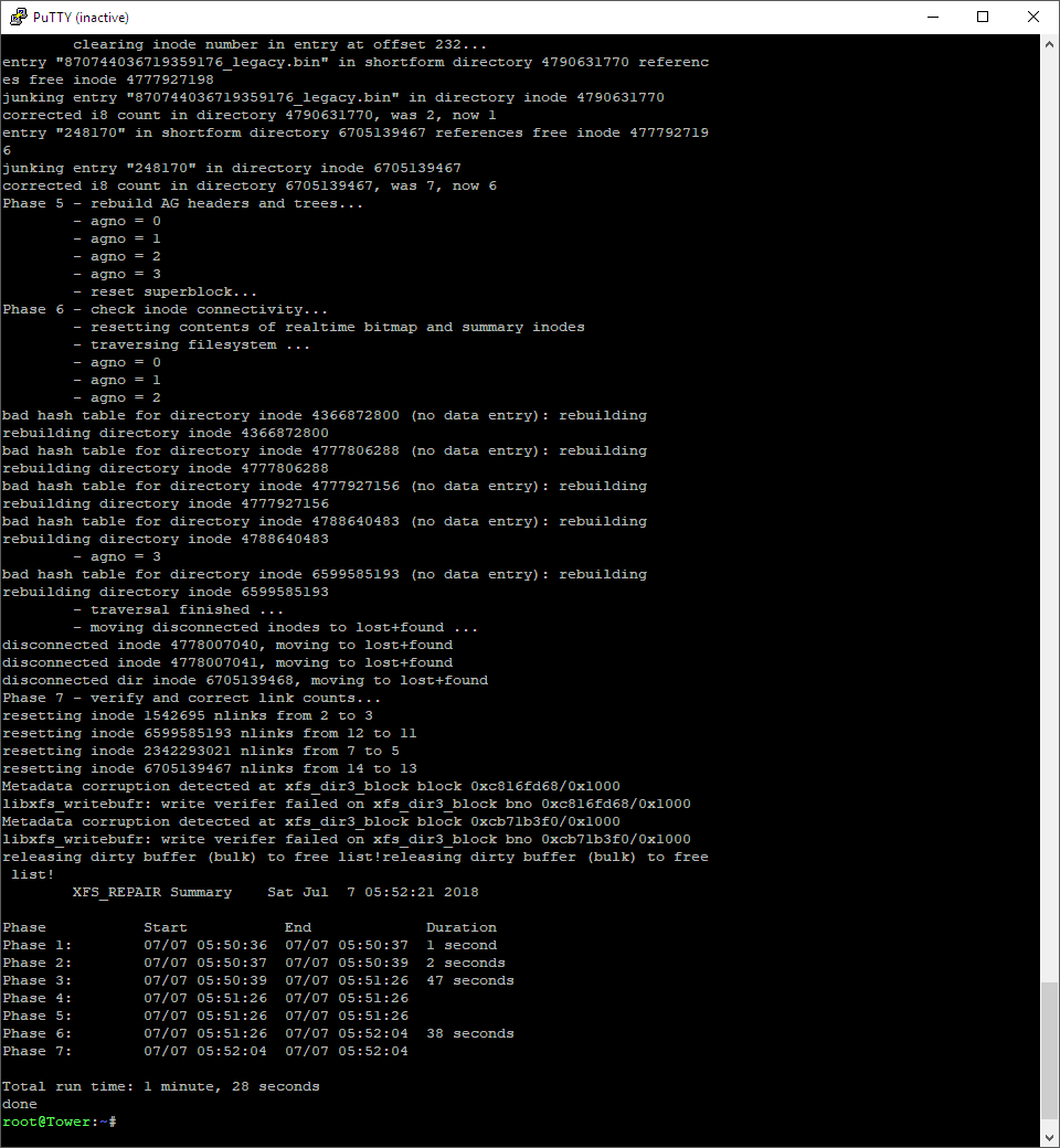

Disable array auto-start by editing disk.cfg on your flash drive (config/disk.cfg) and changing startArray="yes" to "no".
Then start the array in maintenance mode and check filesystem on disk13 (md13):

I did xfs_repair and its status is done.

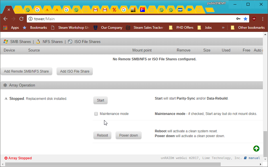

Next Im reinstalling new replacement drive. I use the procedure here.https://lime-technology.com/wiki/Replacing_a_Data_Drive
Im at step "8. Put a check in the Yes, I'm sure checkbox (next to the information indicating the drive will be rebuilt), and click the Start button."
Unfortunately, there are no 'Yes, I'm sure checkbox'.
What should I do?
1 hour ago, publicENEMY said:
What should I do?
Just click the Start button.
