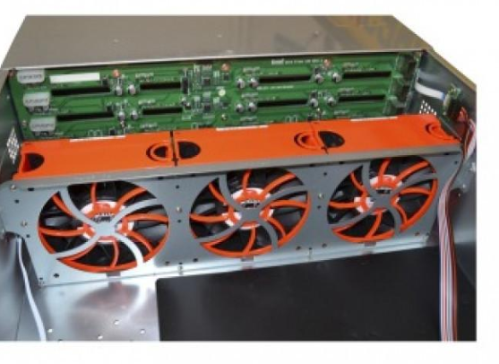

If it is true and I am getting below 70 under stress I am happy with that, I use a 24 Disk U4 Rackmount so 150 is the highest I can get in there I just don't seem to "Know For Sure" what my temps are which I find un-nerving!

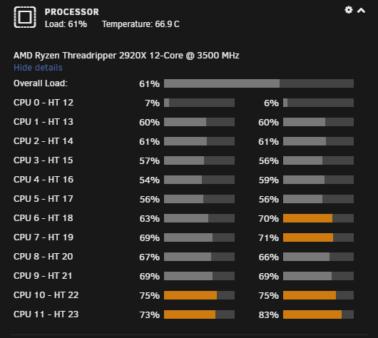

Sensors output under load
I'm using Dark Rock Pro 4 TR4. I dont know if i should see that CPU temps.
It gets at 68C even if using only 6 cores full load,
Same with 12 cores full load
Clocks remain at 3.9-4Ghz

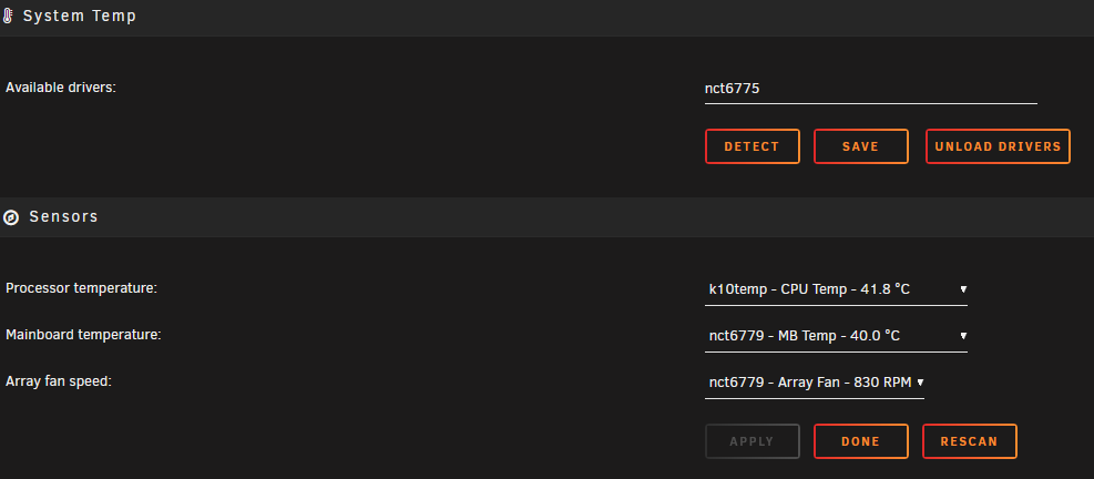

I tried typing the "nct6775" , hit save, and then load drivers. but nothing is happening. Maybe i dont have this on my board?
@skois I guess you have to live with it how the it8792 driver reports it to you. As I said before my guesses are that both sensors (k10temp-pci-00c3, k10temp-pci-00cb) are reporting the temps for each die and the "MB Temp" labeling is wrong. To proof it check if the offset between the reported temps and the Tctl is 27°C and you will know it's a sensor in the CPU. Temp1 or Temp3 might be a sensor on the board somewhere.
