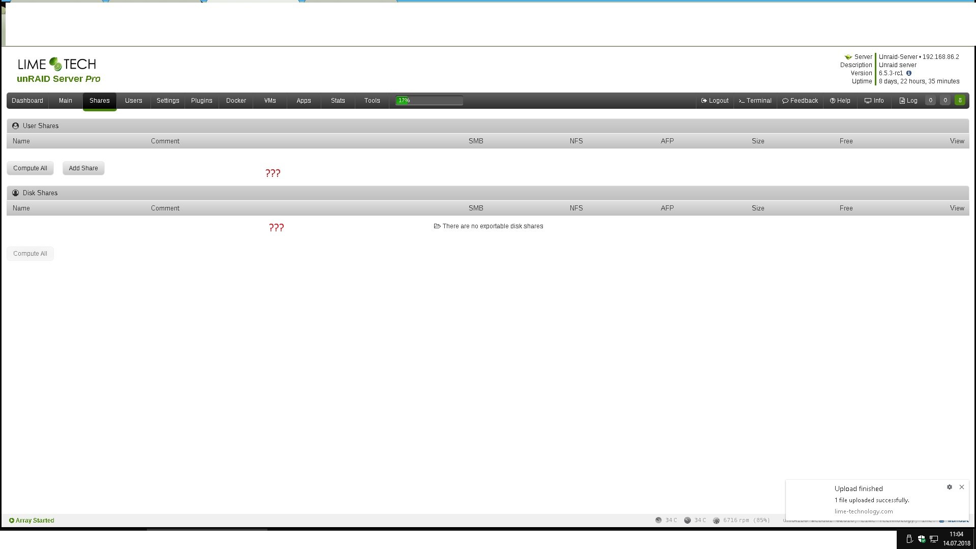

July 14, 20188 yr I noticed it some time ago, but was no issue bc i didnt need to edit anything, but now i would like to change my shares, but they are all disapeared in GUI. All is working just fine, its just a graphic bug. unraid-server-diagnostics-20180714-1059.zip
July 14, 20188 yr Community Expert Do you have an ad blocker installed in your browser? This can interfere with the unRAID GUI and the share list disappearing is a typical symptom. White listing the unRAID server in the ad blocker is the way to resolve this.
July 14, 20188 yr Author Omg, yes that fixed it. I use ublock, it didnt displayed that it blocked anything (...) Crazy. Should there be anything at "disk shares" (bottom?) bc i never saw there any button or anything.
