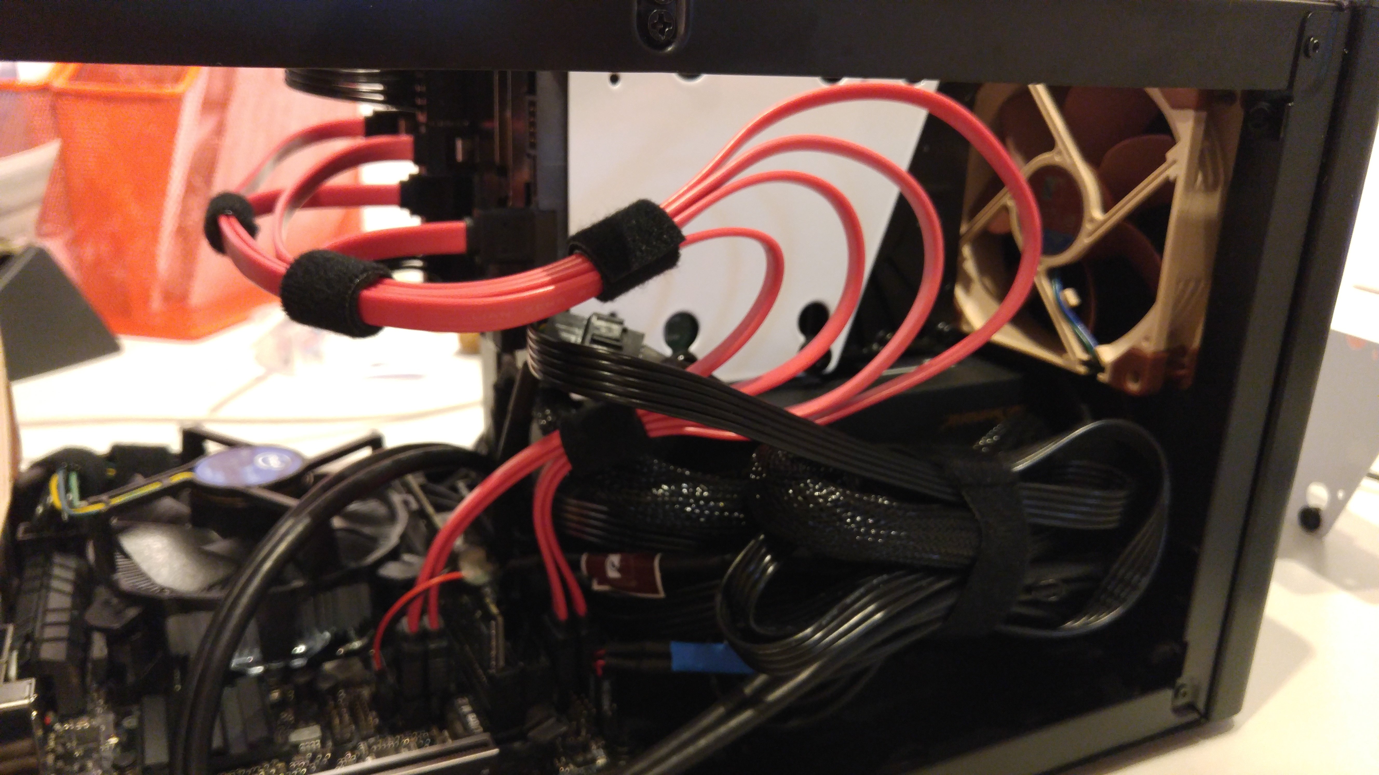

I know this is too late, but I recommend a SFX PSU in that case. Nothing wrong with the seasonic, I have the exact same model. But it takes up more room than necessary and it doesn’t have a silent mode, the fan is always spinning. Space is at a premium in the node 304 especially when you have 4+ drives. You will discover this soon when trying to wrangle all the cables into submission... :)

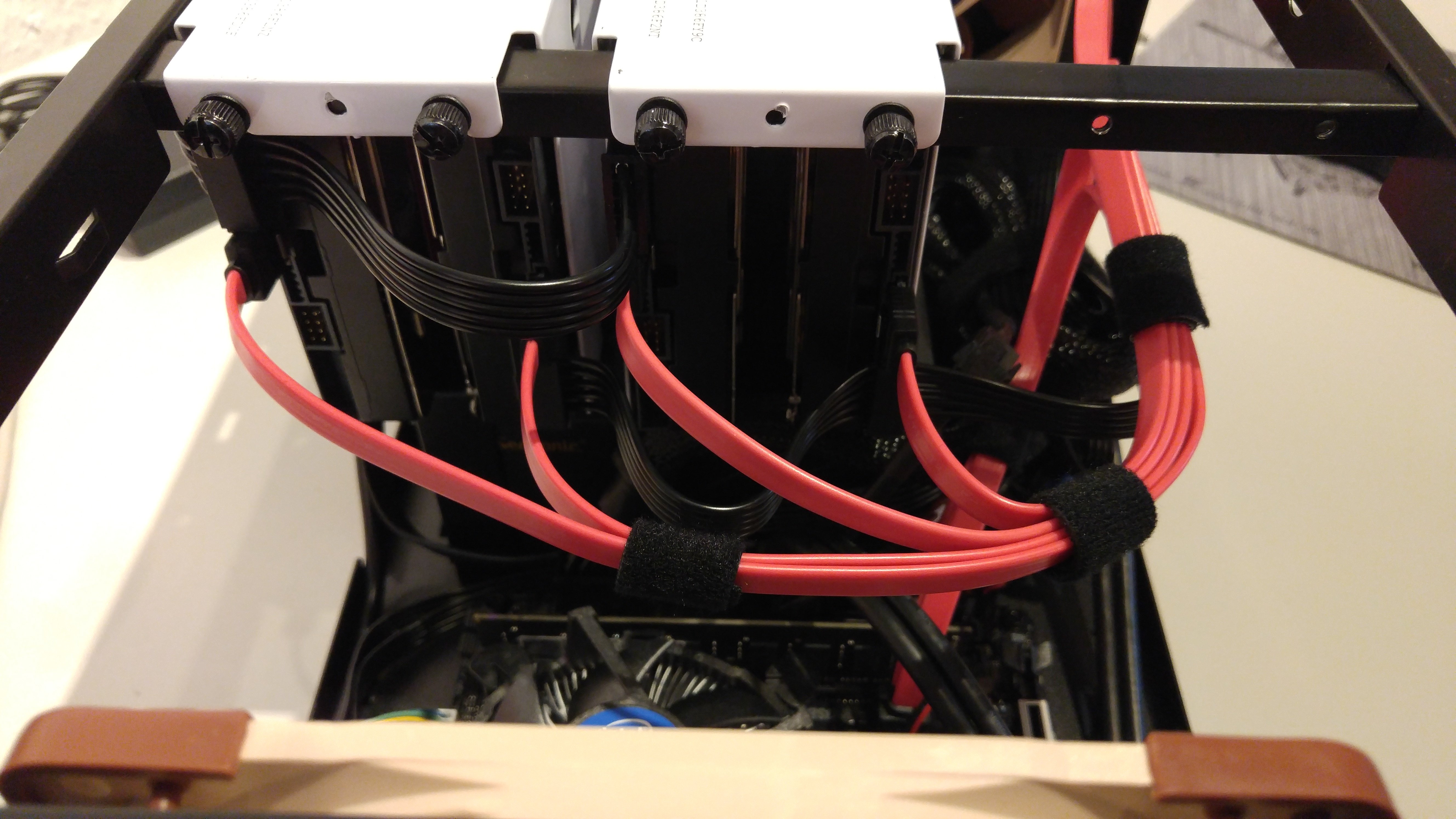

Space for Cable management is kind of ok right now with 4 disks installed but i allready see that it will much harder to do it clean when you have all 6 disks installed.

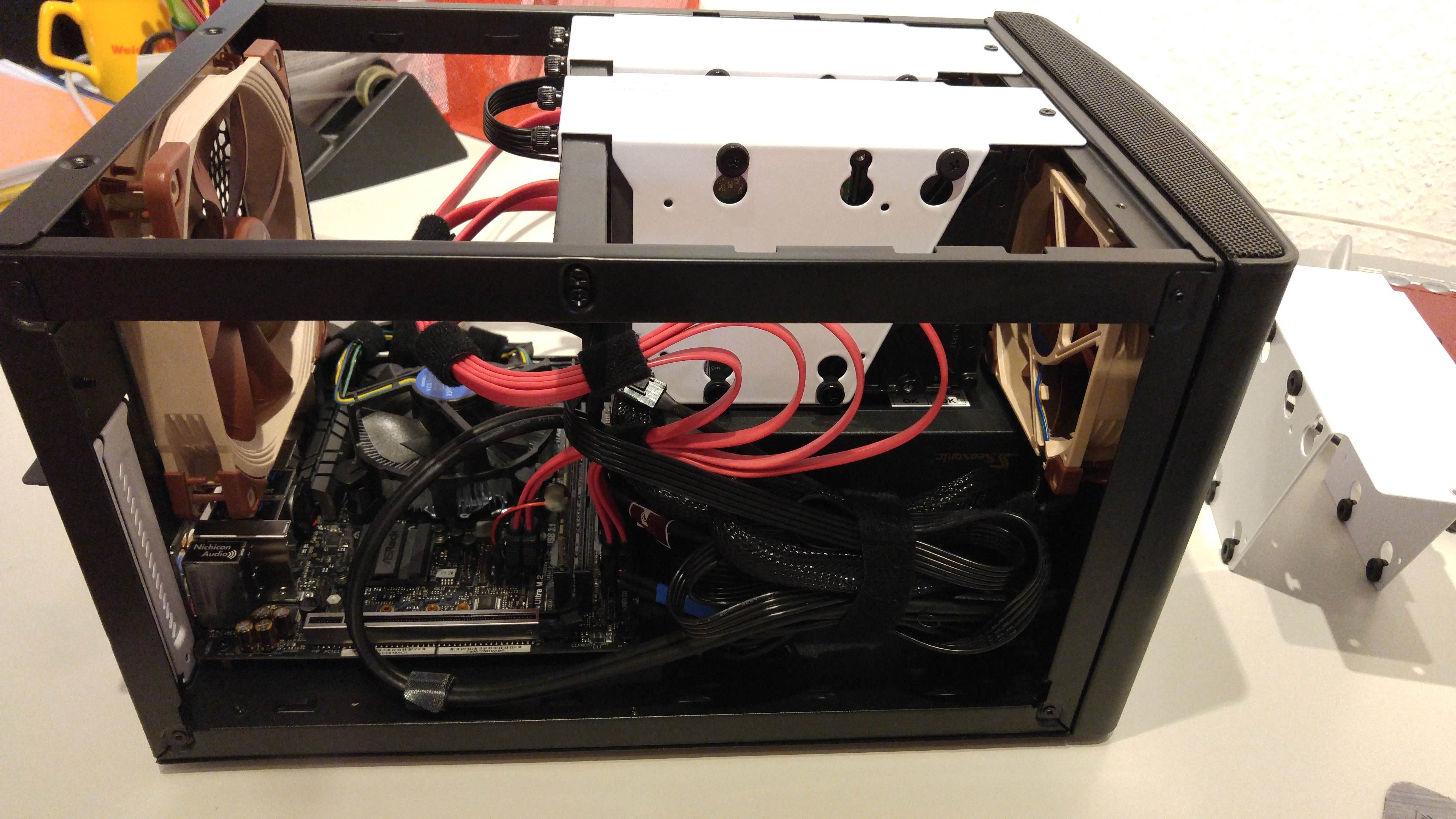

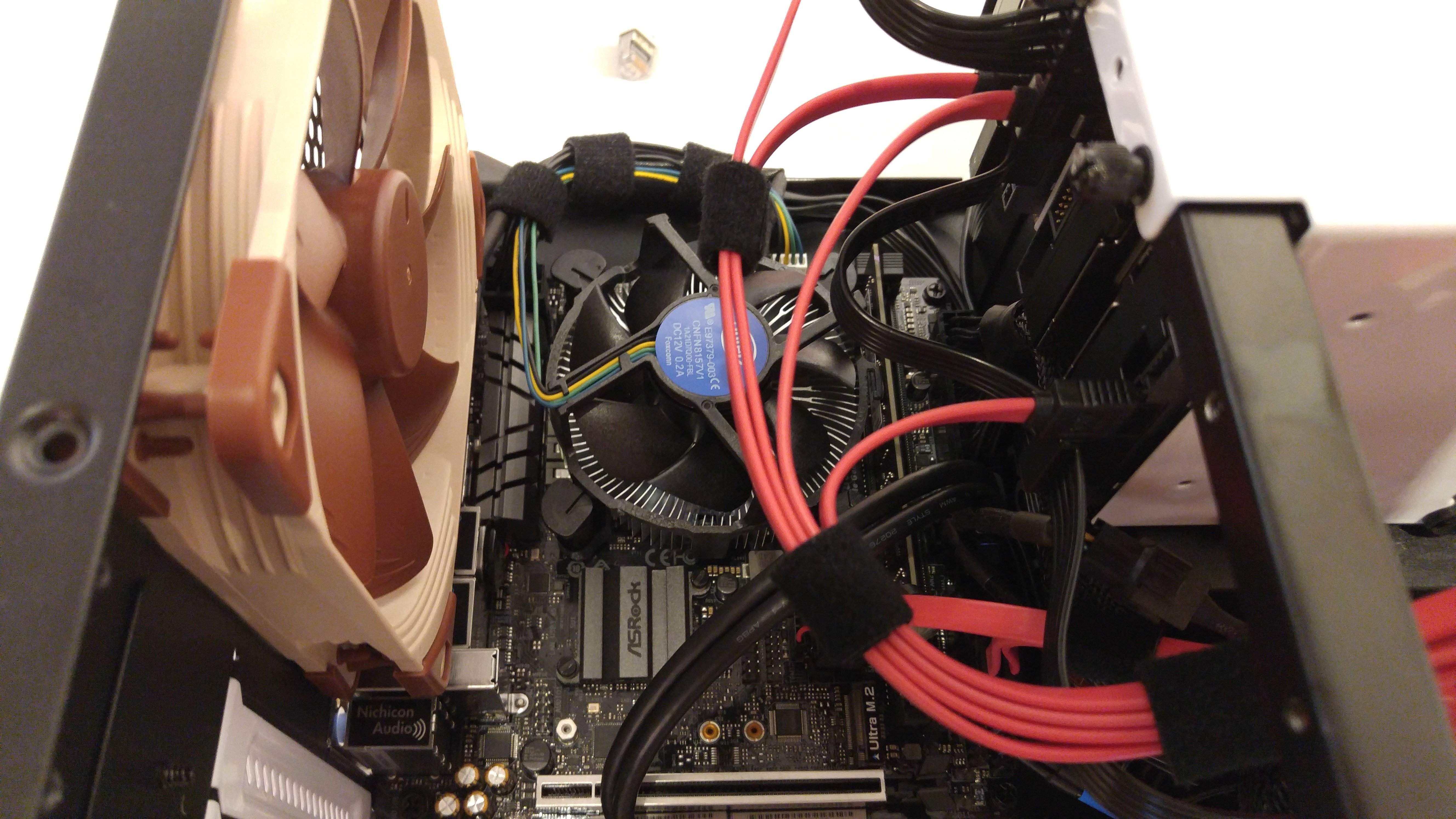

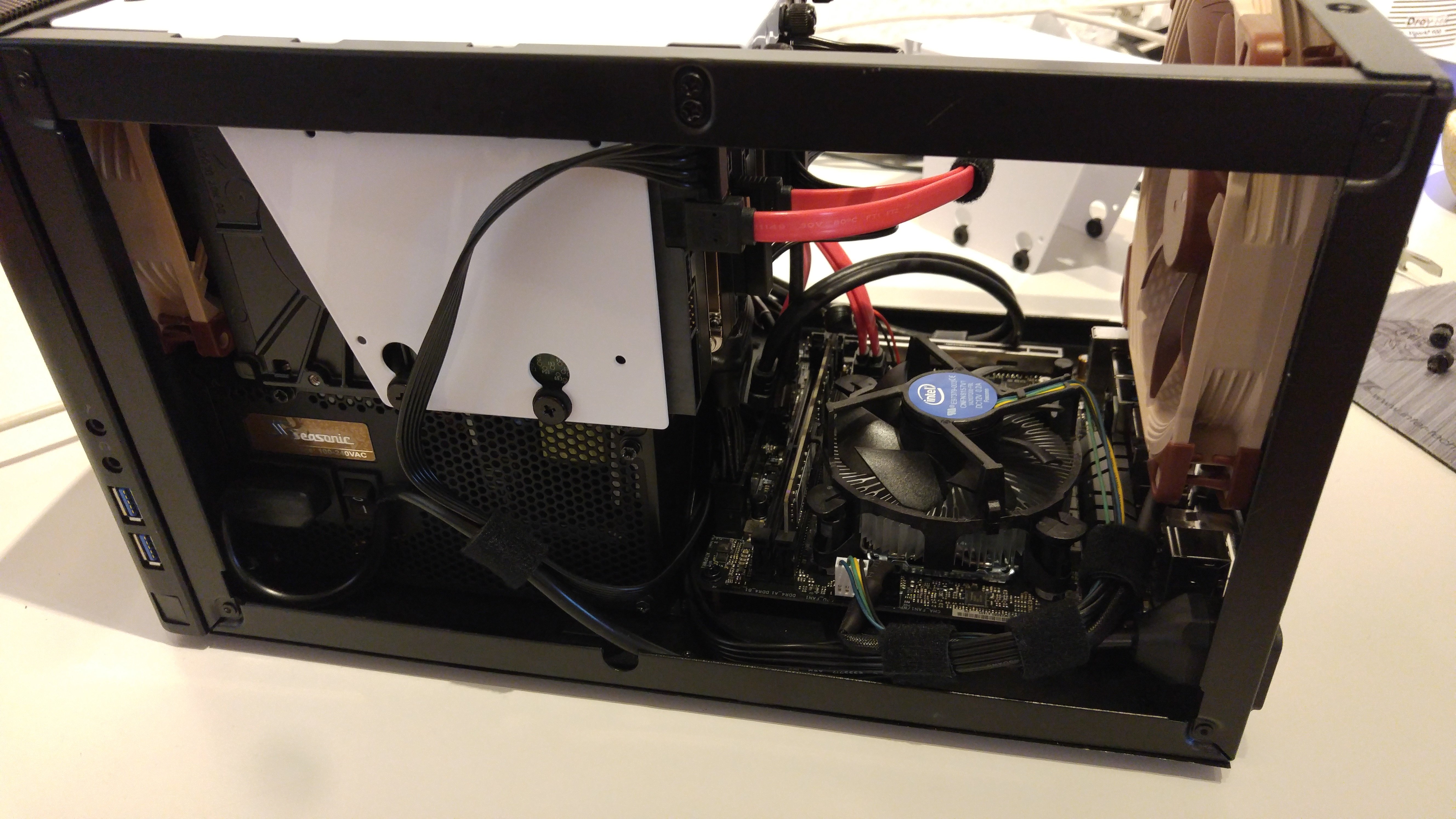

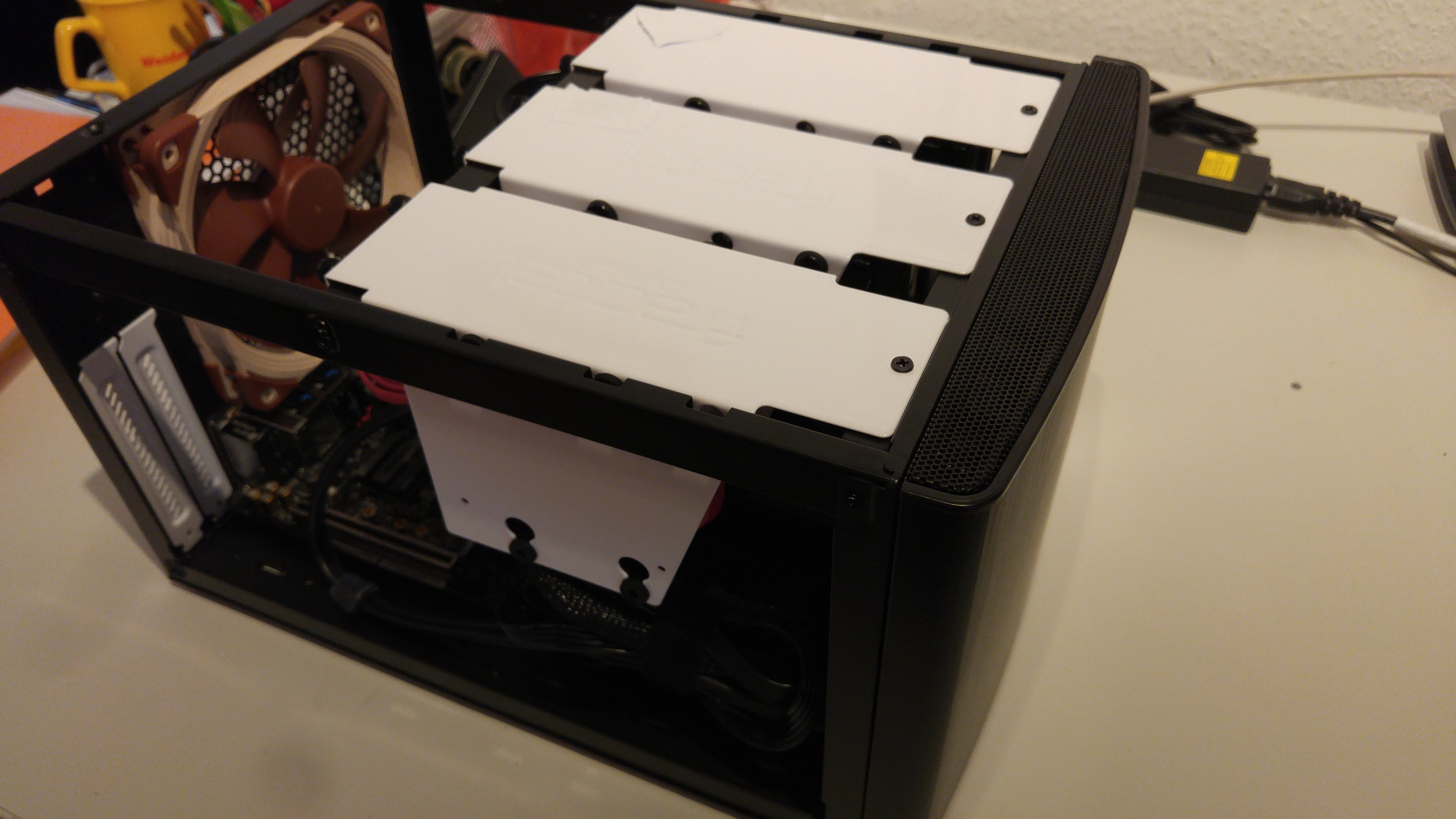

For Buildlog: sadly i didn't had time to do photos since i put it together at work but here are some pics of the final product.
