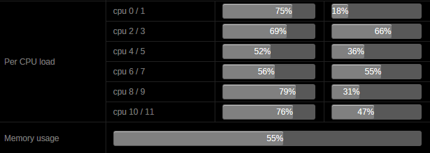

August 2, 20188 yr Hi all So might just be me missing some minor detail (again ), but I can't seem to restrict plex docker usage to 10 of my 12 threads (ryzen 5 1600) Atm I have not touched my basic unraid config for any core settings, running unRaid 6.5.1 and added this to my Plex docker. Something I'm missing or just doing plain wrong? Every time plex wants to do some heavy lifting, it takes all my cores Nothing else is using cpu at this time from what I can find. All help appreciated
August 11, 20188 yr Author So I've been reading around and can't seem to find out what I'm doing wrong. According to @Squid comment bellow, this should be the way to do it, but it changes nothing. Maybe something is different as I'm on AM4 ryzen 1600?
August 11, 20188 yr On 8/2/2018 at 12:27 AM, ProZac said: Something I'm missing or just doing plain wrong? You're doing it wrong. The --cpuset-cpus goes into the extra parameters section, not adding it as a variable. You may need to switch to advanced view to see that field (top-right)
August 11, 20188 yr Author Wow talk about being blind. Not sure how I missed that, worked like a charm. Thanks alot @Squid
