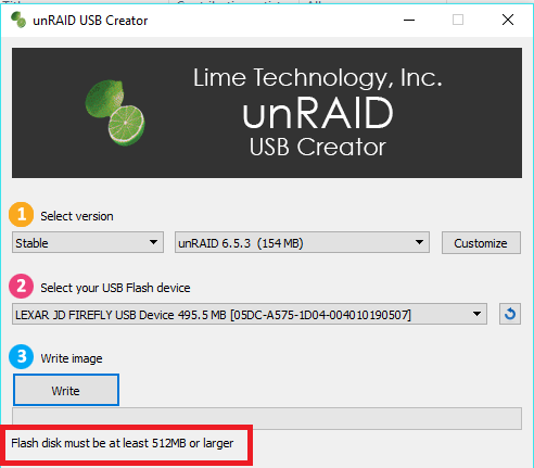

I've tried. At least through the Download USB Creator; I keep getting the error
Let me try it, "old school"
Edited by CDLehner
Damn; I feel dumb.
I had this line of thinking, all along; but was assuming...the new OS, must not fit on a 512 flash.
Should have cleaned the sh*t out of my eyes; and seen, it was only 154M...and that error, was obviously a byproduct of the Creator app.
OK; back to the GUI!
Gotta assign drives. I'll Google; am I going to find it?
are you sure your dont have more than one partition on that flash drive.  it sure sounds like you have a 512mb partition, and another with the rest of the space.  Windows will only see the 1st partition to format, insert it and use the drive management tool from windows.  it will show you if there is more than one partition.  remove them all, then use the unRAID creator tool.  I have used it, the tool does work
