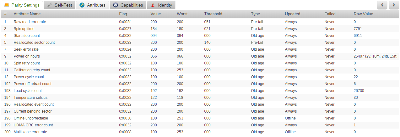

I then shut the array down, walked down and opened/reseated the connectors to the Parity drive (and all drives) and looked around not seeing anything obviously wrong, so I started it back up.  The drive powered up and appears to be error free from a smart perspective.  smartctl runs and I can see attributes in the UI
Because of this, my opinion was to just unassign, reassign the drive and let it rebuild, but that doesn't seem to be working.   And that's what I'm doing now.  But I'm curious if anyone has any opinion on what might have happened?

Looks like a connection problem, replace/swap cables/backplane slot to rule them out in case it happens again.
Thanks, that is my opinion as well.  After reseating the connectors, The Parity Sync did complete w/o errors.  Fingers crossed it was a one time issue.
