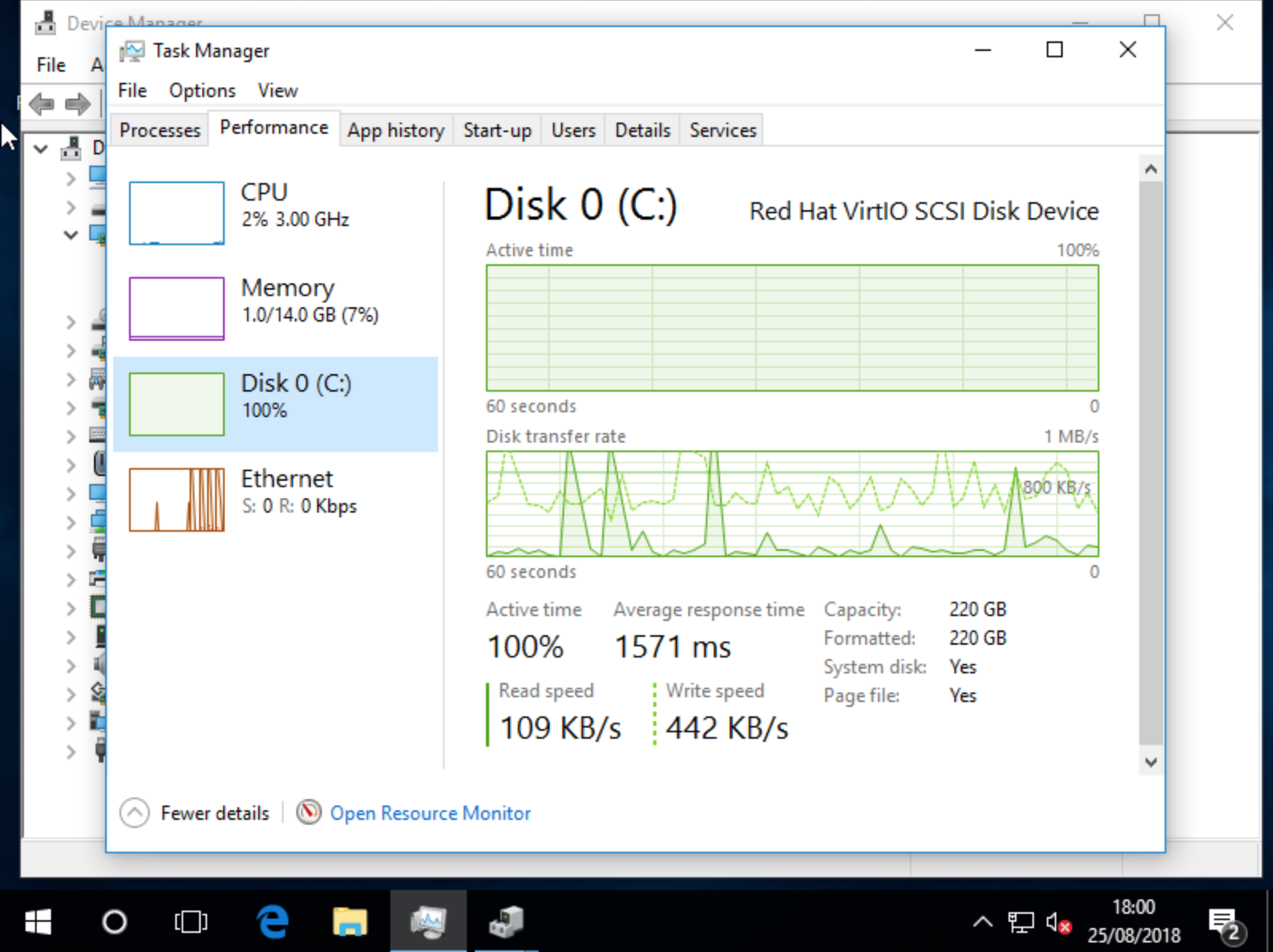

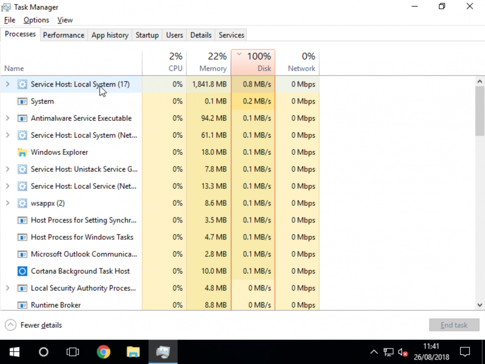

I have set my domains share to only use the cache drives, although on my VM I get really bad disk speeds1278209688_ScreenShot2018-08-26at01_59_54.thumb.png.a11ad2e6369e93ba539c44ed81add498.png
My drivers are up to date, I have no idea what's happening.
Jamie

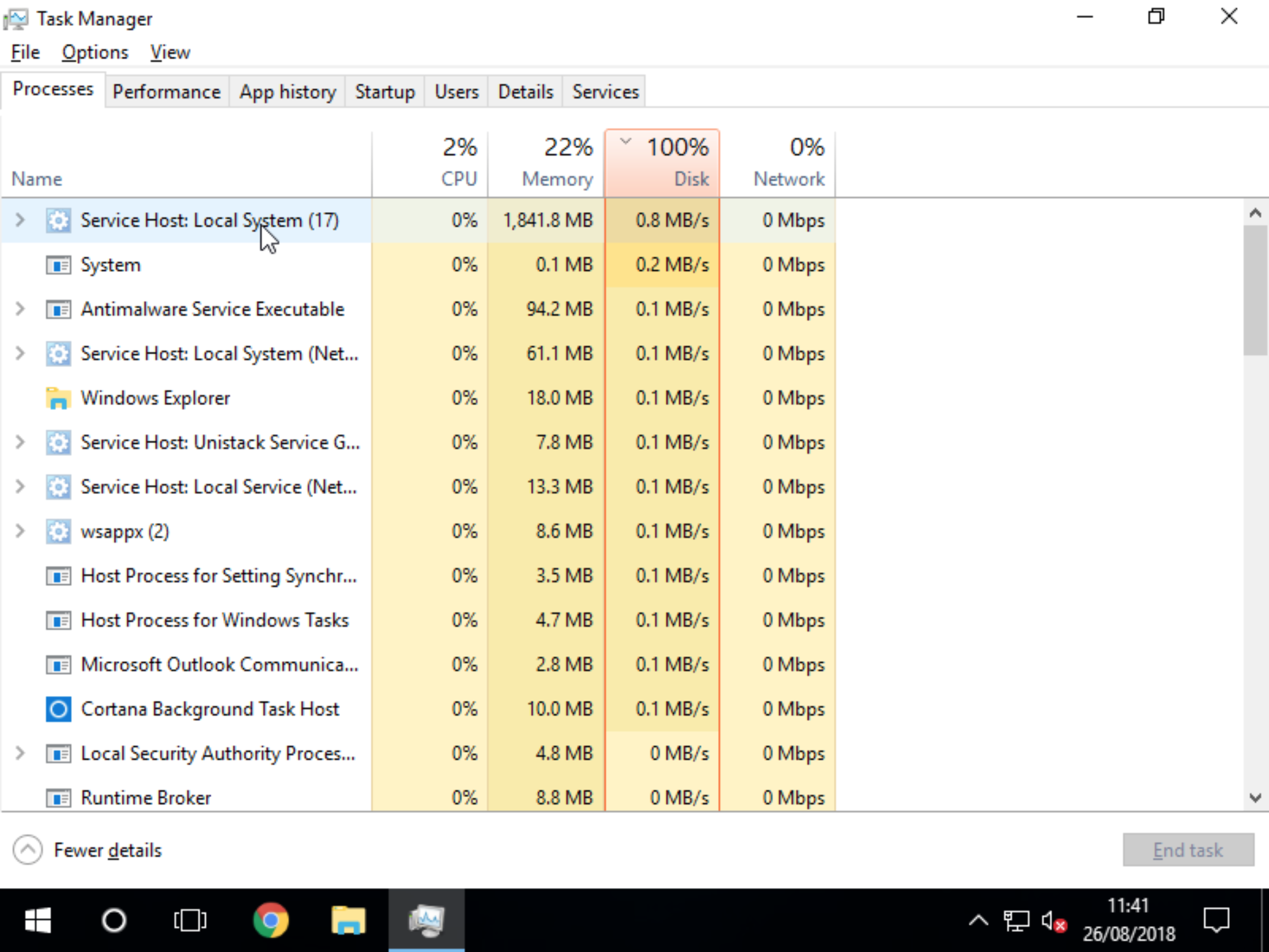

Without a lot more information, neither has anyone else. Post your diagnostics and the XML for your VM. What is the Task Manager screen grab meant to show - were you doing some sort of file copying at the time?

Sorry I thought I posted the diagnostics. The screenshot is at idle, the only task I was running was searching for a graphics driver and even when that task was complete it was the same story.
1367191943_ScreenShot2018-08-26at11_40_54.thumb.png.f7675bcaa372dfa5d4eb8554ddf3c609.png
You can see here the process that is using the most disk usage and it little to nothing.
tower-diagnostics-20180826-0156.zip

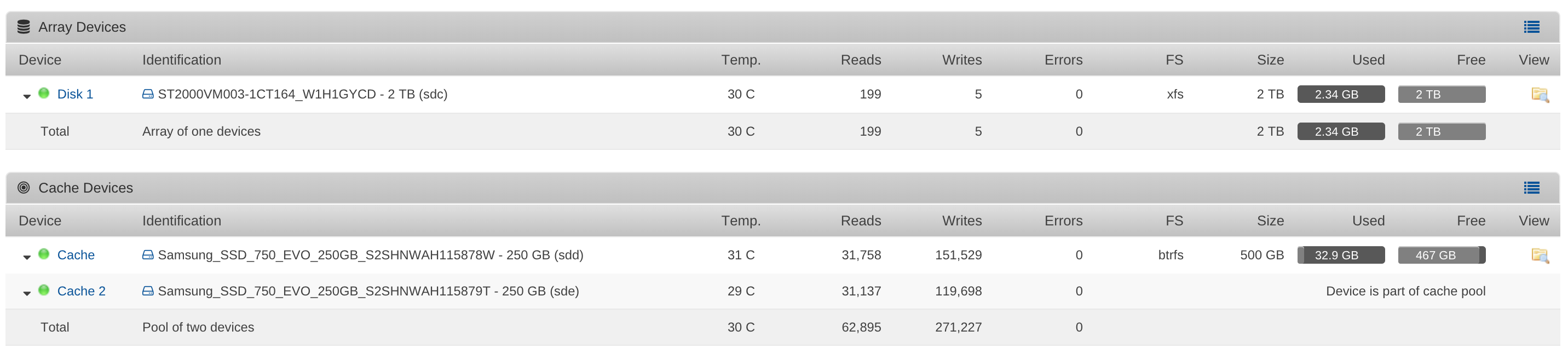

One thing I notice from your disks' SMART data is a very high power cycle count on most of your disks, including your two Samsung cache SSDs:
  9 Power_On_Hours          -O--CK   099   099   000    -    3244
 12 Power_Cycle_Count       -O--CK   098   098   000    -    1205
That's a power cycle approximately every 2 hours and 41 minutes of power on time, on average. Do you have a power supply problem? As a comparison, here's the same information for one of my disks:
  9 Power_On_Hours          -O--C-   100   100   000    -    14684
 10 Unknown_SSD_Attribute   PO--C-   100   100   050    -    0
 12 Power_Cycle_Count       -O--C-   100   100   000    -    24
I would do some read/write tests from the command line, directly to a folder on /mnt/cache, bypassing the virtualisation to check if the cache is the problem or if it's fundamentally sound.

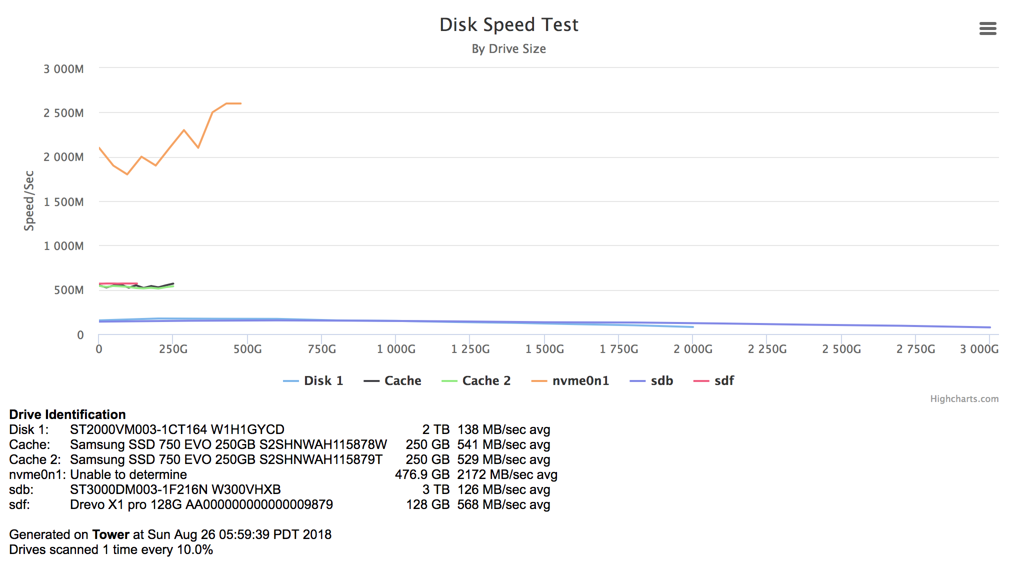

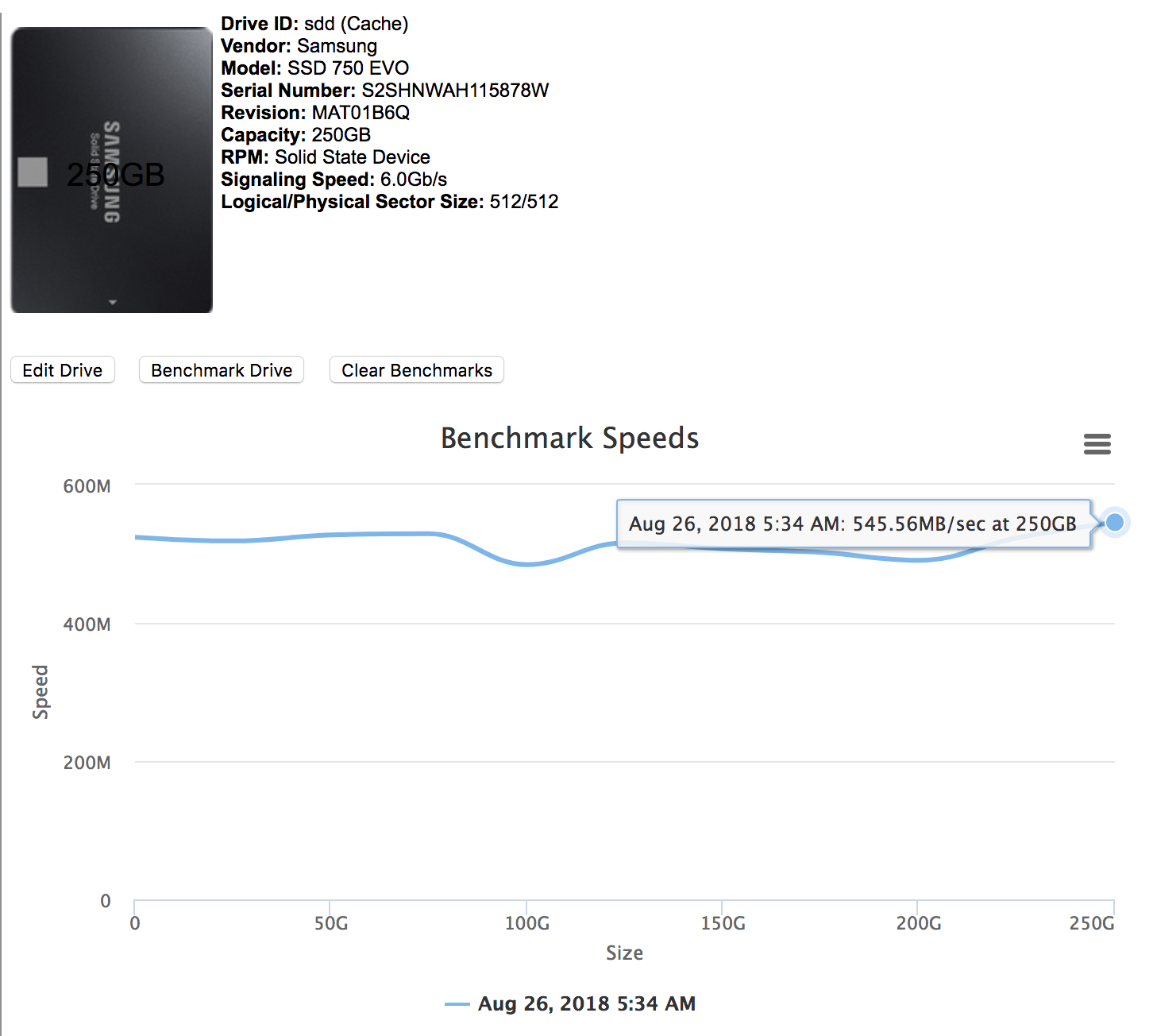

I've not noticed any problems with my power supply (I doubt that I have). I used the DiskSpeed plugin and got from what I can tell are normal results:
1032364750_ScreenShot2018-08-26at13_38_40.thumb.png.42e40c4277292ce1b3e9ee8c6493823e.png
I don't really understand what a power cycle is?
Edited by jbonnett
A power cycle is a power up followed by a power down, or vice versa. It's not necessarily a problem with your power supply itself but possibly the distribution (cabling, backplanes, drive cages) whatever is between the PSU and the drives. Read performance looks fine. How about write? Are you trimming your SSDs?

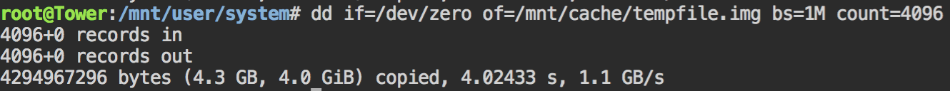

Ok I did this, it doesn't look right though1381146758_ScreenShot2018-08-26at14_16_35.thumb.png.d87b60045713d9608bbf6c3874a014ba.png
I didn't realise that I had to explicitly turn trimming on.
Edited by jbonnett
Writing only a gigabyte is probably misleading as it will be buffered by memory. Trim isn't enabled by default. An easy way to set a schedule is with the Dynamix SSD Trim plugin.
I installed the Dynamix SSD Trim as soon as you mentioned it :) I tried again with 4GB but it still doesn't look right.923811203_ScreenShot2018-08-26at14_41_14.thumb.png.fe6f61907b2bd251dd23928990014793.png

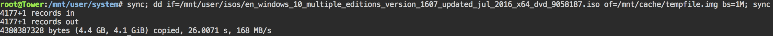

I then used a real file
288443952_ScreenShot2018-08-26at14_44_29.thumb.png.e97f5ddc60a7eb22e2ff801e05a67824.png
keeping in mind the read speed of that disk that the iso is stored on is around that number (disk 1), it's a cheap NAS drive
1303563486_ScreenShot2018-08-26at14_00_20.thumb.png.e5bd01338fcf71153de100cf2a193144.png
In terms of the power cycle it is probably that I don't keep my machine on at all times, I only use unRAID for 2 gamers 1 pc and do a far few restarts due to software development work.
Edited by jbonnett

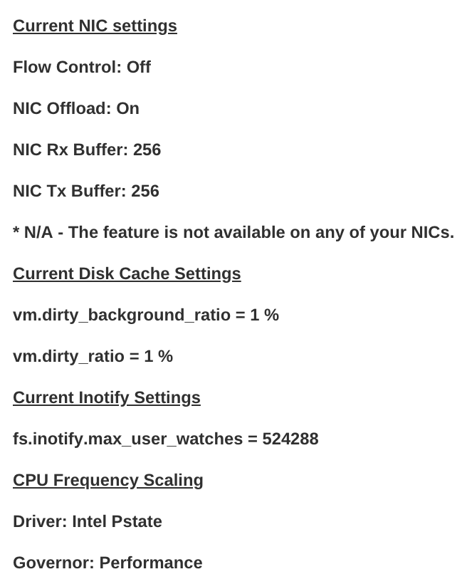

I have my write cache settings vm.dirty_background_ratio and vm.dirty_ratio set very low (to 1% and 2%, respectively) so a 1 GiB transfer doesn't fit in RAM. Reads aren't affected, as the second one shows - it's clearly read from RAM. If your ratios are set to their default values you'll need to choose a bigger transfer to defeat the write cache. You can change the ratios with the Tip and Tweaks plugin - it helps with avoiding Out Of Memory errors too.

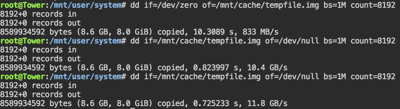

I set them both to 1%  tried a 8GB transfer and I still get silly speeds. Just in case you don't know from the diagnostics I have 32GB RAM.

Here are mine
476811400_ScreenShot2018-08-26at15_31_34.thumb.png.1accf9991ae6038204468f36e0d79cf7.png
486908139_ScreenShot2018-08-26at15_29_24.thumb.png.c99d44d1e18d286be388d8f1e2ee2494.png
Edited by jbonnett
The write speed is sensible. The reads are clearly from RAM as the dirty ratios don't affect read caching.

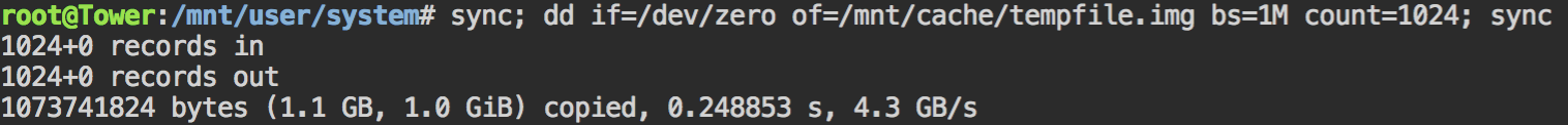

So what could be affecting the VM? Also surely it's not right due to the scaling of 4GB, anything over 320MB (1% of 32GB) should have around the same speed?

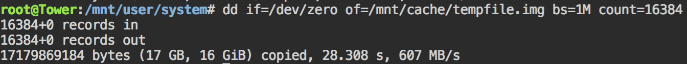

1786727271_ScreenShot2018-08-26at15_36_40.thumb.png.03e939ebced84490fc47b35b8148632c.png

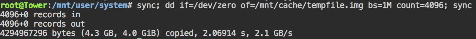

I also went the opposite way
2106744833_ScreenShot2018-08-26at15_38_35.thumb.png.a2f9e7b6efb25cb4b53df4e8e0ff5a82.png
Edited by jbonnett
Copying from /dev/zero can sometimes give silly speeds when actually writing to the drive - a number of SSD performs on-the-fly compression of data to reduce the flash wear. And the compression ratio of the contents from /dev/zero is very, very high. So the write speeds ends up being the link speed to the drive instead of the actual write speed of the drive.
