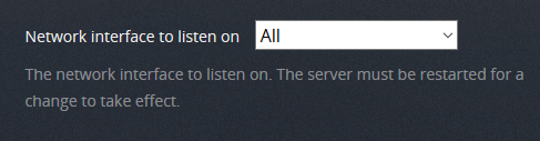

You may be suffering from an issue introduced with the 1.13.5.xxxx version of Plex.  They introduced the ability for the the Plex Media Server to bind to multiple network interfaces.  This has caused problems particularly with docker installations of Plex as it is confused by docker networking.
Your symptoms sound exactly like many are reporting (connections to server come and go, server disappearing in Plex).  Start reading here:
This is now in Plex Server Advanced settings:
For some, the solution is to listen on all interfaces; for others, it is to specify a particular interface and for others it was to roll back to Plex Media Server version 1.13.2.xxxx before the change was introduced.

Hi @Hoopster Many thanks for such a detailed post, it is really appreciated!
I have already tried rolling back the version and specifying the Network interface with no success but there are a few other suggestions in that thread I will try tomorrow!
