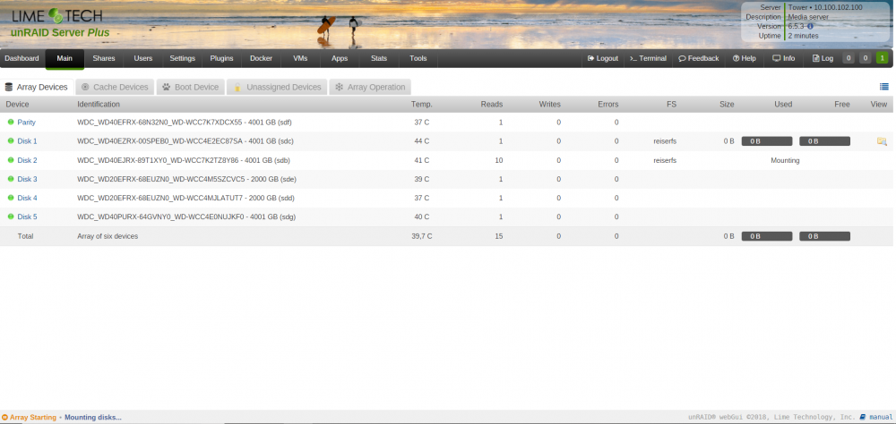

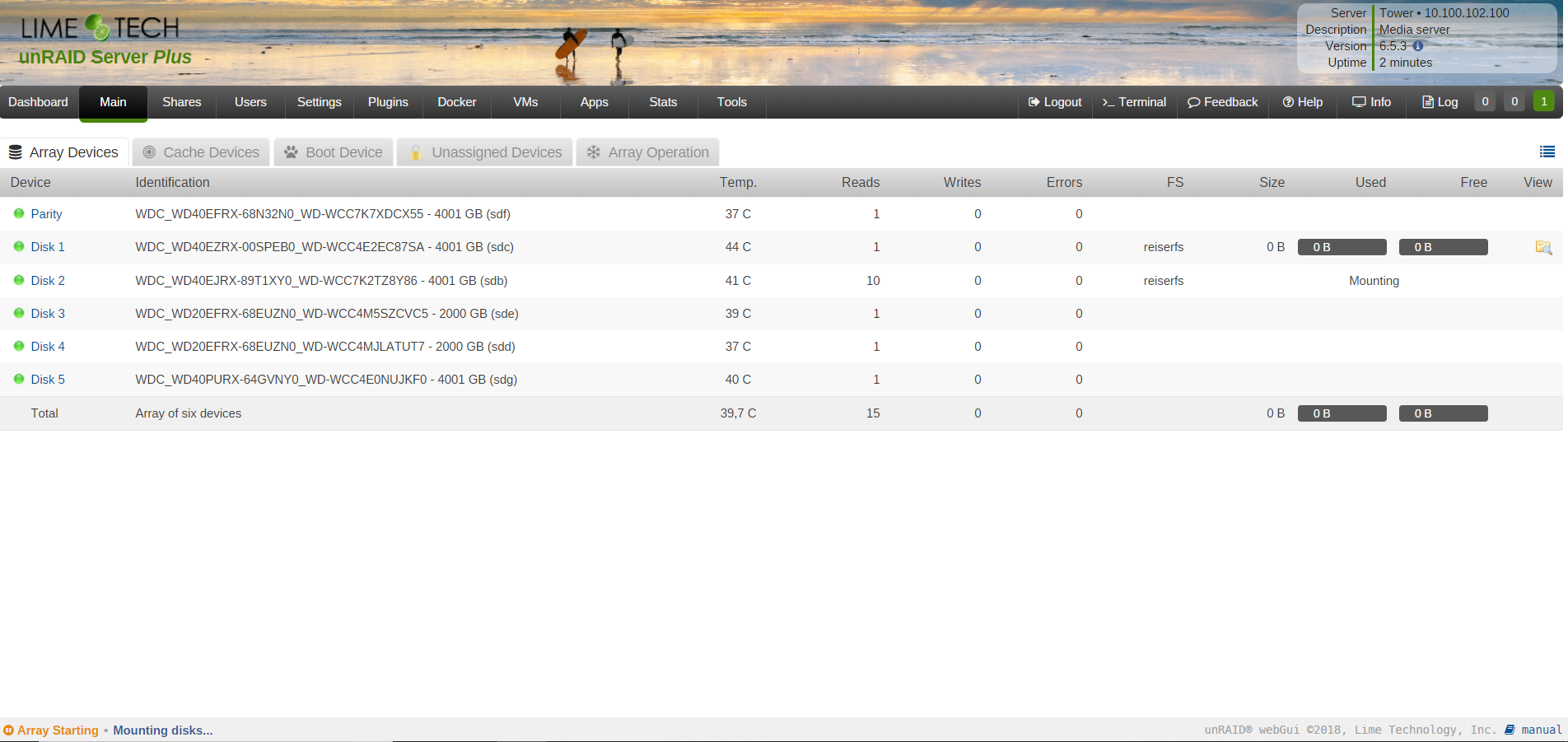

Also, once i rebooted the server i noticed that the disks took a while to mount, about 3-4 minutes - i don't know if this is normal behavior or not.

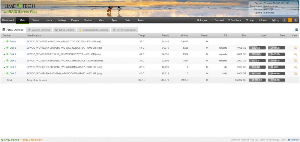

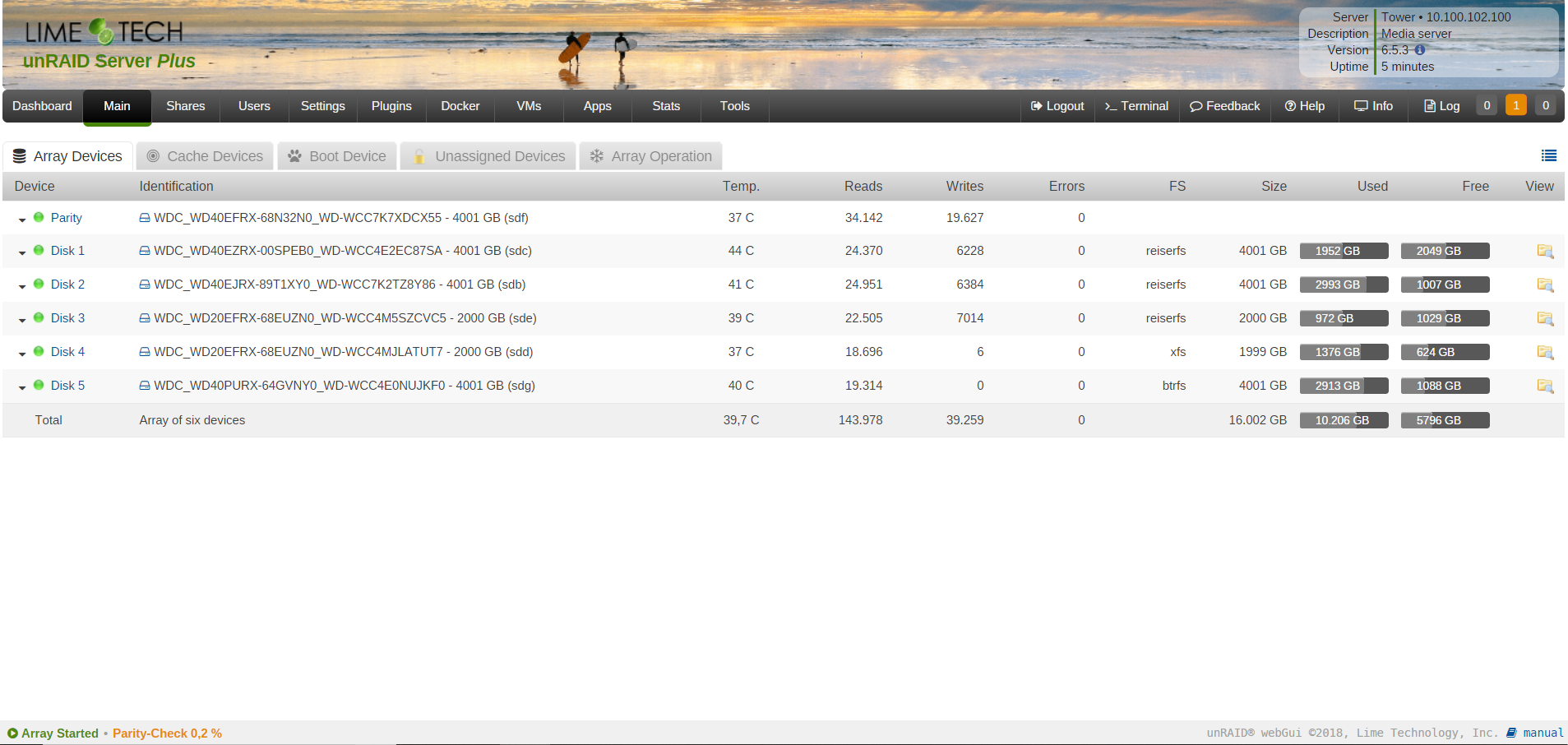

i'm attaching a couple of screenshots and the diagnostics - i'd appreciate any advice on what to look for if this happens again.
It's normal for reiserfs volumes to mount slowly after an unclean shutdown. It's also not unknown for reiserfs to cause these kinds of lockups. I'd start formulating a plan to migrate the rest of your reiserfs disks to xfs or btrfs, your choice.
You have enough free space on the array to move everything off of your 4GB disk1  to your other disks to reformat it, then you could copy disk2 to the newly formatted disk1, format disk2, then copy disk3 to disk2.
