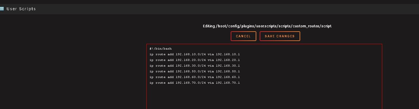

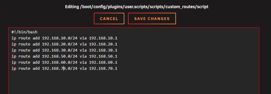

Does the attached script look right? Currently, the custom routes entered in the GUI are associated with the gateway name, i.e. br0.10. Does that need to be included in the script as well?

The command doesn't seem to work properly.
I receive the following message:
Error: Nexthop has invalid gateway.

Your gateway (192.168.1.111) must be part of a known network. I.e. 192.168.1.x/24 must exist.

Sorry for the confusion. The gateway you mentioned was an example fro @Delarius.
My specific script is attached above, but I can attach another copy.

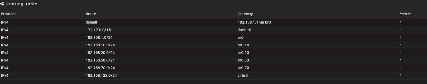

1 minute ago, surfshack66 said:
All of these networks exist..

I had to manually add 192.168.20.0 and 192.168.70.0 via the Network Settings page.
Add a network by doing something like this
ip route add 192.168.10.0/24 dev br0.10
Thank you! That worked
