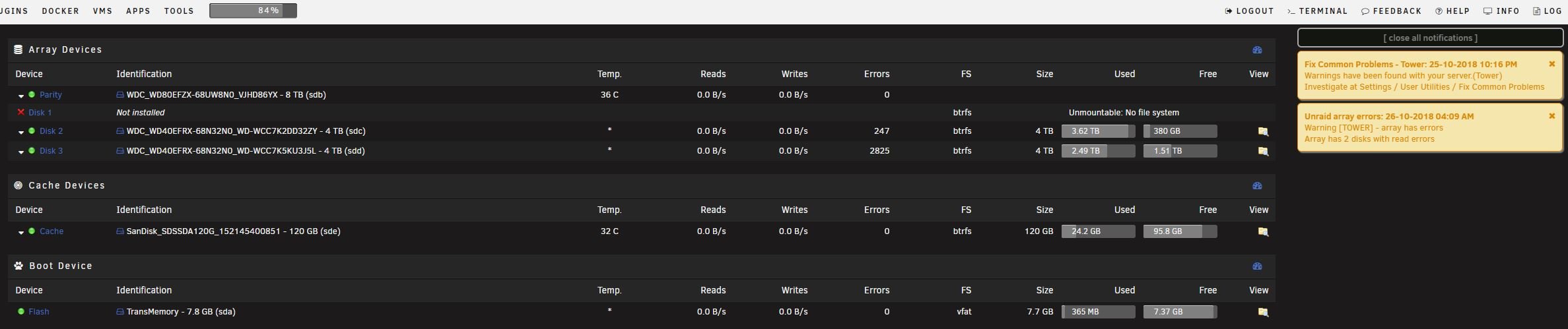

Should I be concerned about this, I've just come back to the server after having the array online for 24 hours to errors on disk 2 and 3 now.
Could something be wrong with the B120 controller found in the HP Gen8 causing all the errors?
tower-diagnostics-20181026-2137.zip
The controller on those servers in AHCI mode is just a regular Intel SATA controller and works very well, errors are similar to the previous ones, most likely there's a problem with the cable, board or power supply.

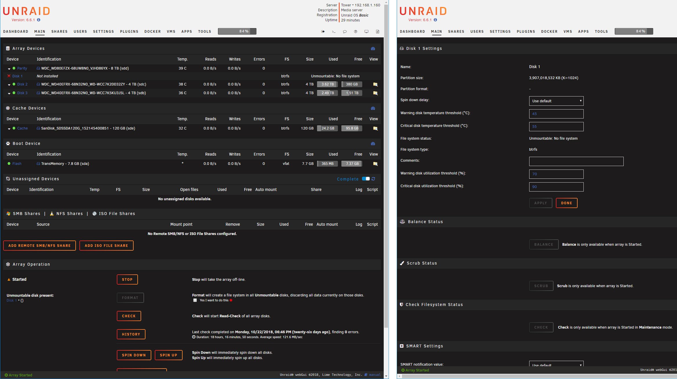

It also says "Unmountable disk present: Disk 1 • ()" and sees its partition size as 4TB, I physically removed that failing 4TB drive.  Another thing to add the parity doesn't seem to be emulating the missing files from the failing 4Tb I removed.
Syslog is spammed with ACPI errors and cuts off, but try checking filesystem on disk1

Disk1 is physically out of the system and has been for the last 2 weeks while the server was off. I just plugged Disk1 (the failing disk) in via USB and mounted it through unassigned Devices and I can see all the files are there through /mnt/disks in MC so they're not lost, but shouldn't the files be emulated through parity anyway, there is no /mnt/disk1 in MC either
The emulated disk isn't mounting, so not data from it will be available, filesystem check should fix it.
If the data disk really is btrfs formatted I would really need to see the syslog before, and likely your best option is going to be rebuilding parity with the old disk, assuming the old disk is OK.

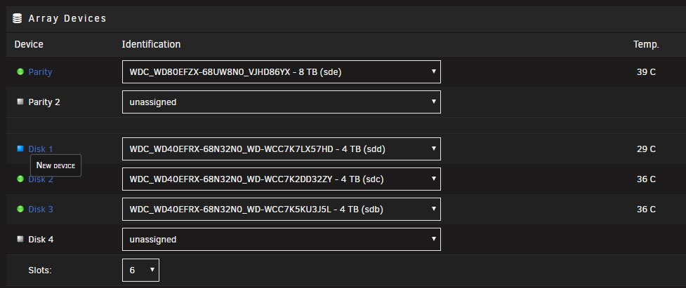

I stopped the read check, turned off the server, inserted Disk1 back into the system, is this ok to start the array, Unraid thinks its a new device?
No, don't do that, or it rebuild on top of the old disk
