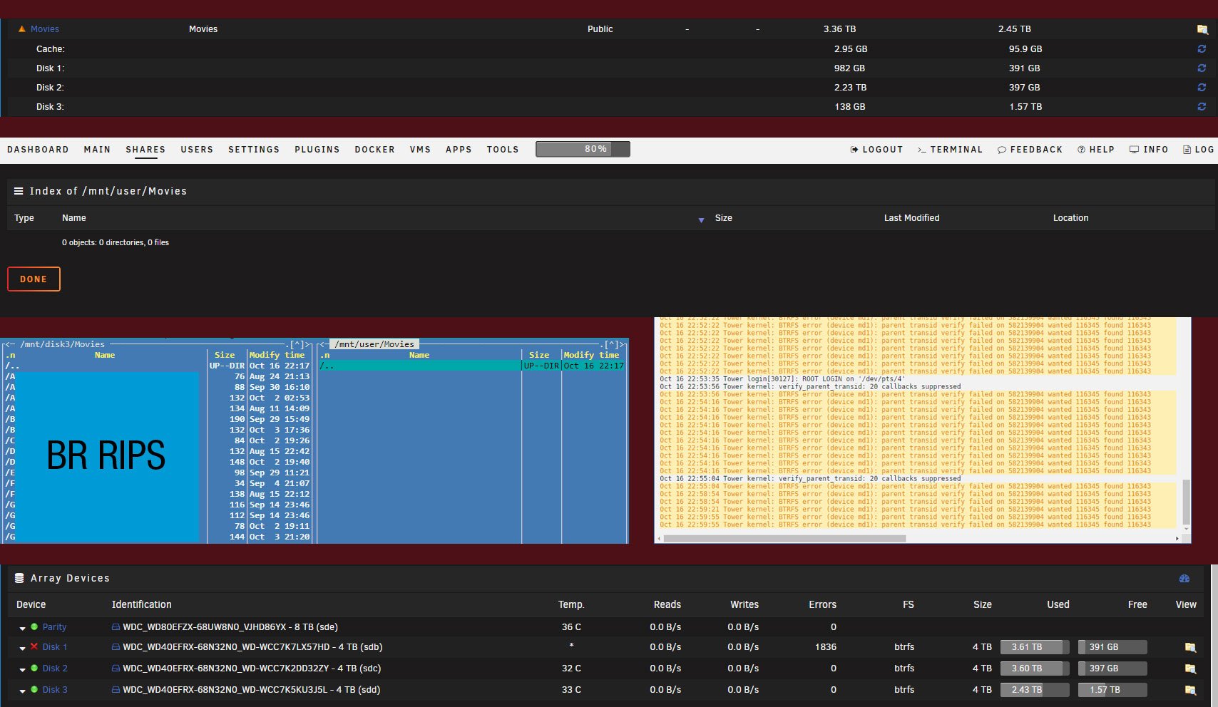

When I try and access my movies folder everything is gone, Plex can still access everything from it and I can see the files in MC when browsing disks, but not users. Every time I try and access the folder from windows the "BTRFS error (device md1): parent transid verify failed" appears in the system log.
disk1 is reporting errors and i'm not sure why, only last month I removed it from the array formatted it and put it back in, the SMART diagnostics show anything to be concerned about (though I may be wrong) I think this is unrelated because last month I didn't loose a whole share folder like this. I can still browse disk1 through MC
This could be linked to a sudden power loss which caused an unclean shutdown.

Oct 16 13:20:13 Tower kernel: BTRFS error (device md1): parent transid verify failed on 582139904 wanted 116345 found 116343
This is usually a fatal filesystem error, after replacing the disk you'll need to be reformatted the disk and restore the data, you can use this to help backup the data from the emulated disk if needed:

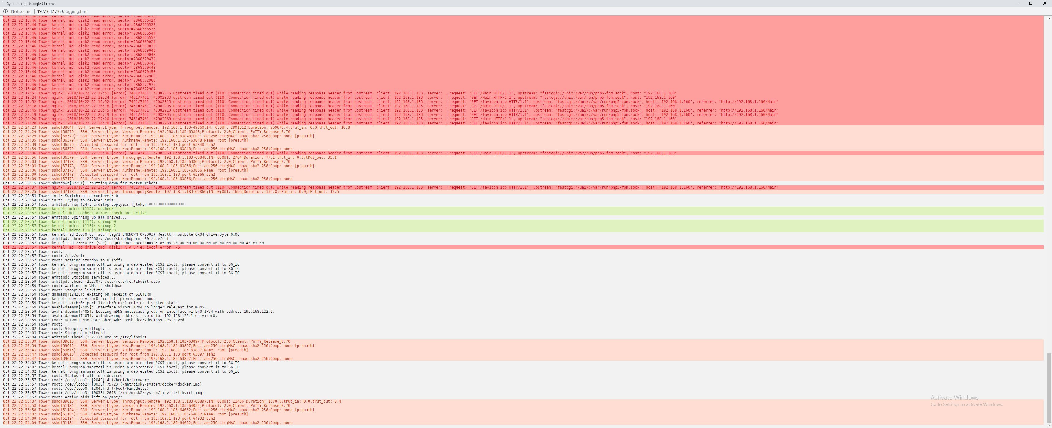

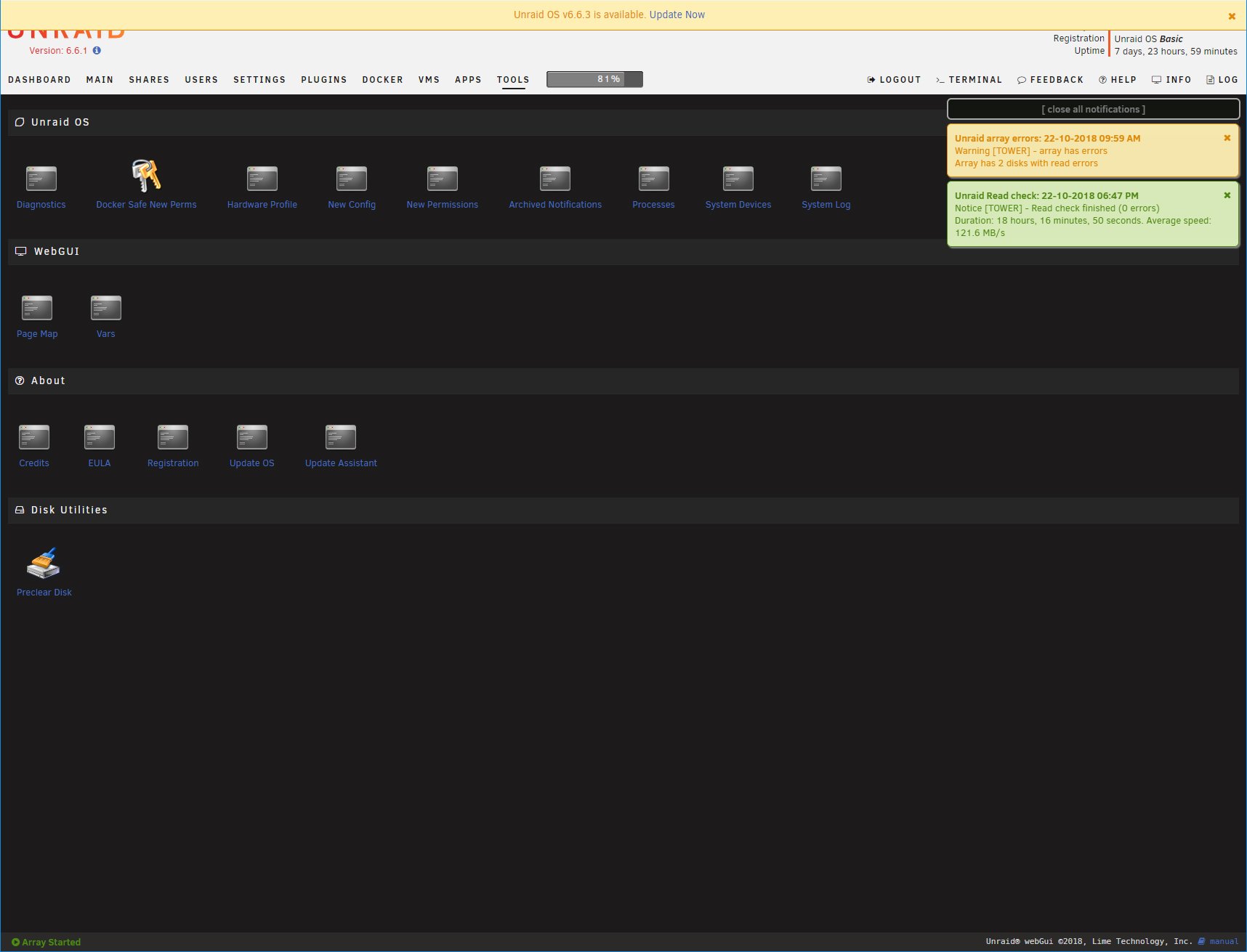

My system completed its weekly parity check while I was away and things have gone to custard, I've lost all options to shut down, the page just wont load, I cant download a diagnostics it just fails. All I've got are these screenshots.
It looks like I can still access files through MC, should I be grabbing as much as I can and just start again?

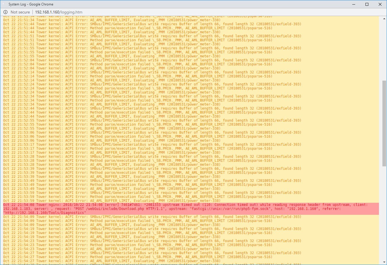

I had to force reboot it. I can login through MC but the web GUI doesn't load. I don't have a monitor with a VGA port to plug into the server to see whats going
Type diagnostics on the console and post the zip.
I'm using PuTTY and it says 'starting diagnostics collection...' and doesn't seem to go anywhere. I can see a Diagnostics folder in the root directory but the only folder with anything in it is /system. I grabbed everything there one by one.
I left my Logging window open and it keeps updating, I have attached it

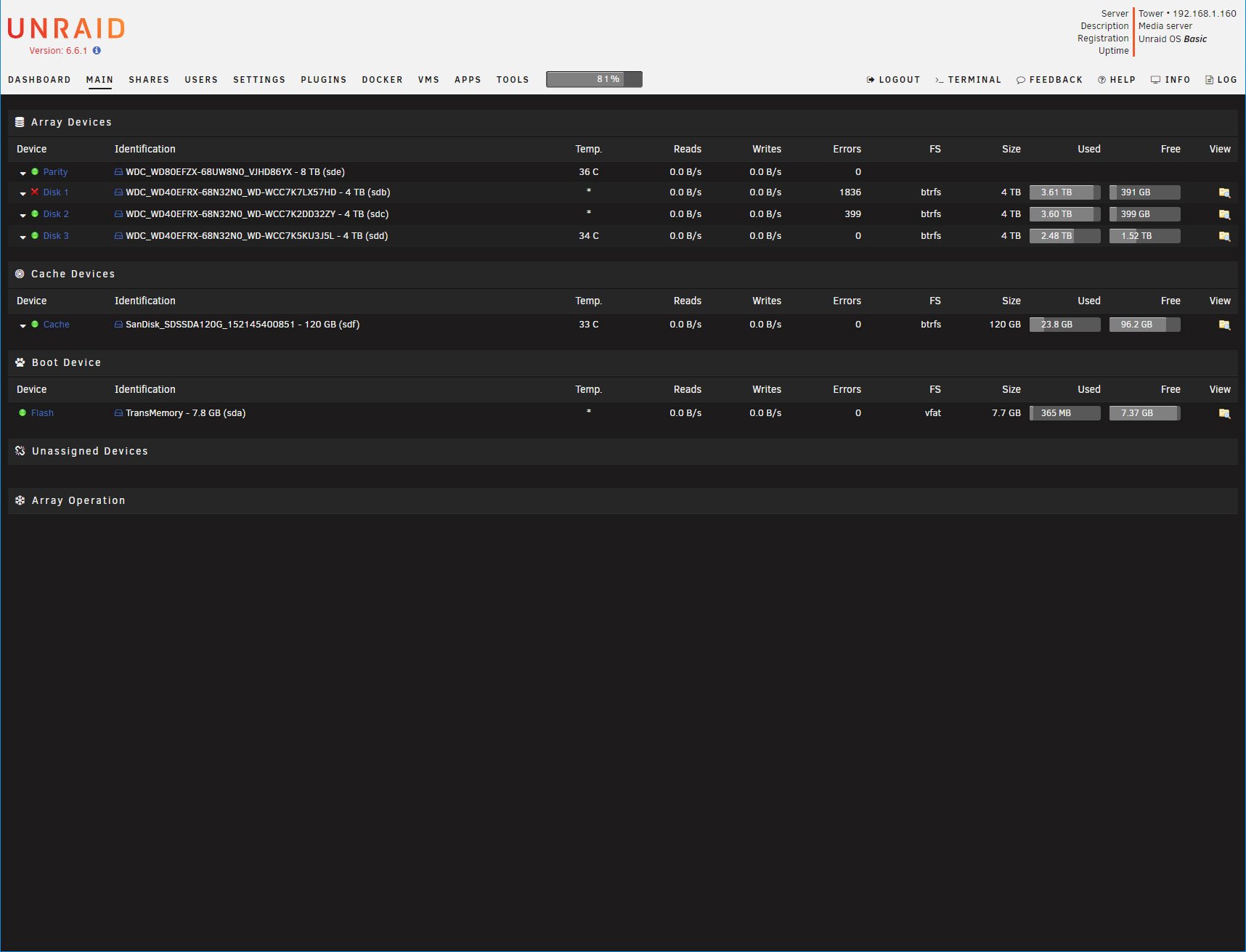

But after last night experiencing the unRAID GUI not responding and acting wierd after the parity check I'm worried that more is corrupt than just disk1.
in one of my previous screenshots you can see disk2 came back with 399 errors after the parity check, the notification says at 9.59am 'array has 2 disks with read errors' then a few hours later at 6.47pm 'read check finsihed (0 errors)' does that mean they're fixed or they still exist?
And then the logging window showing 'tower kernel: md: do_drive_cmd: disk2: ATA_OP e3 ioctl error: -5' is that a sign disk2 has issues
