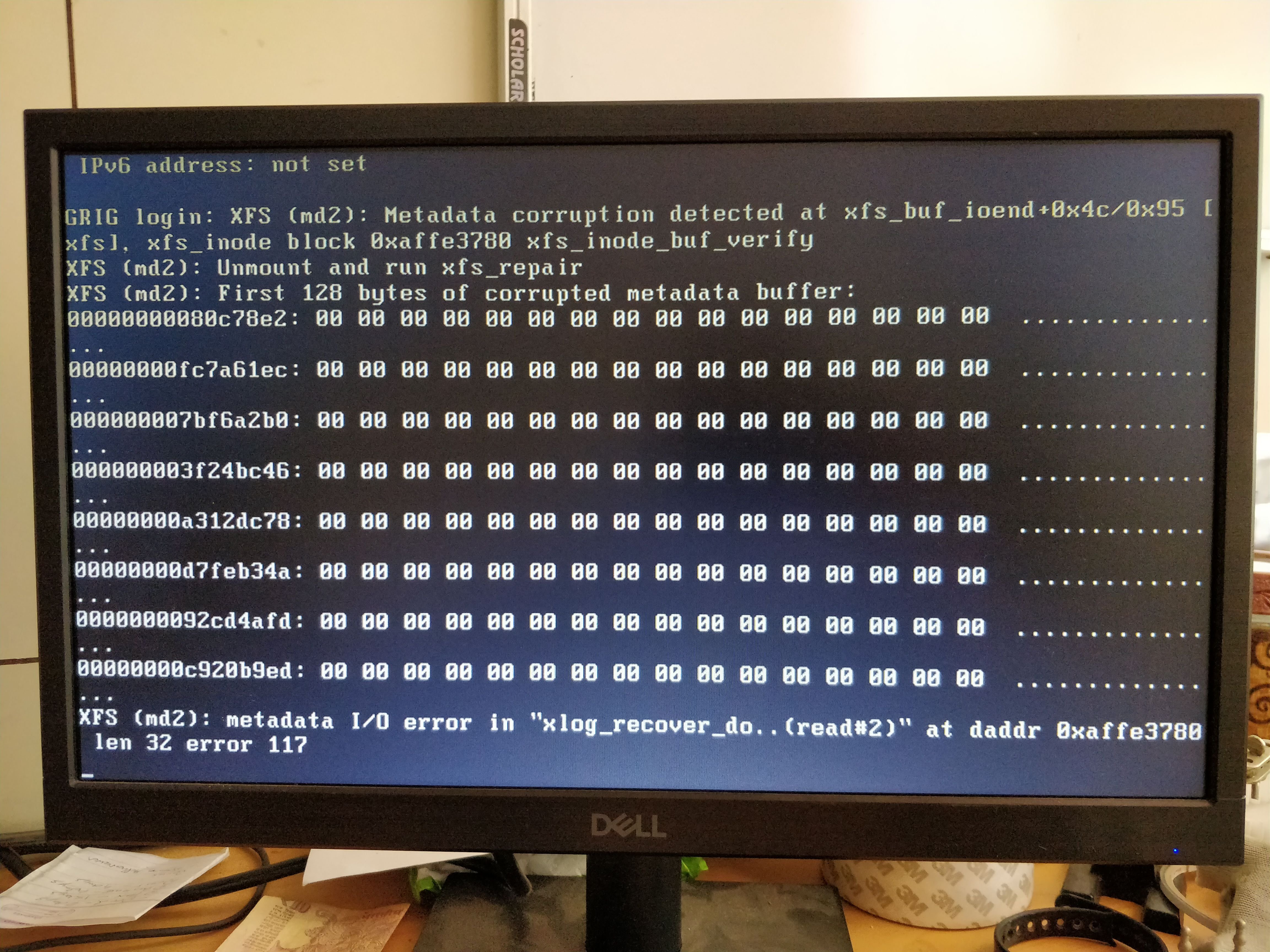

When servers boots i get following message:
PLEASE HELP......

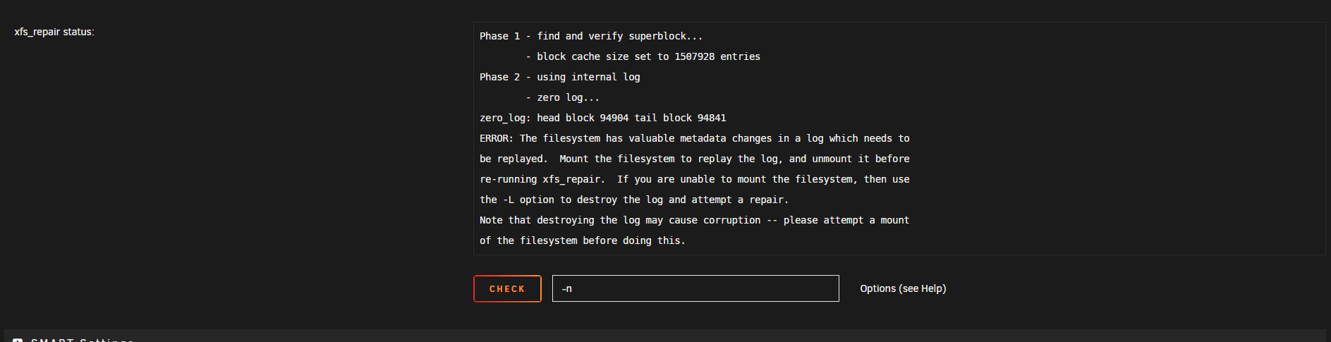

I just now ran the command xfs_repair with option -v  and got following output
Phase 1 - find and verify superblock... - block cache size set to 1507928 entries Phase 2 - using internal log - zero log... zero_log: head block 94904 tail block 94841 ERROR: The filesystem has valuable metadata changes in a log which needs to be replayed. Mount the filesystem to replay the log, and unmount it before re-running xfs_repair. If you are unable to mount the filesystem, then use the -L option to destroy the log and attempt a repair. Note that destroying the log may cause corruption -- please attempt a mount of the filesystem before doing this.xfs_repair.thumb.PNG.0cf807df847ab69b0cdadb3aa4a631a2.PNG
kindly advise should i normally start the array or use xfs_repair -L??
