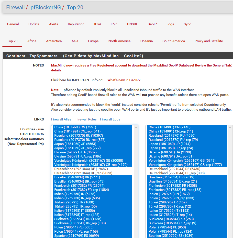

If you're using PfBlockerNG on Pfsense, make sure you don't block the GEOIP regions where you wanna access your server from.
Every traffic marked blue is blocked and only access from germany is allowed in this example.
You have to unselect every region you want to allow access from.
