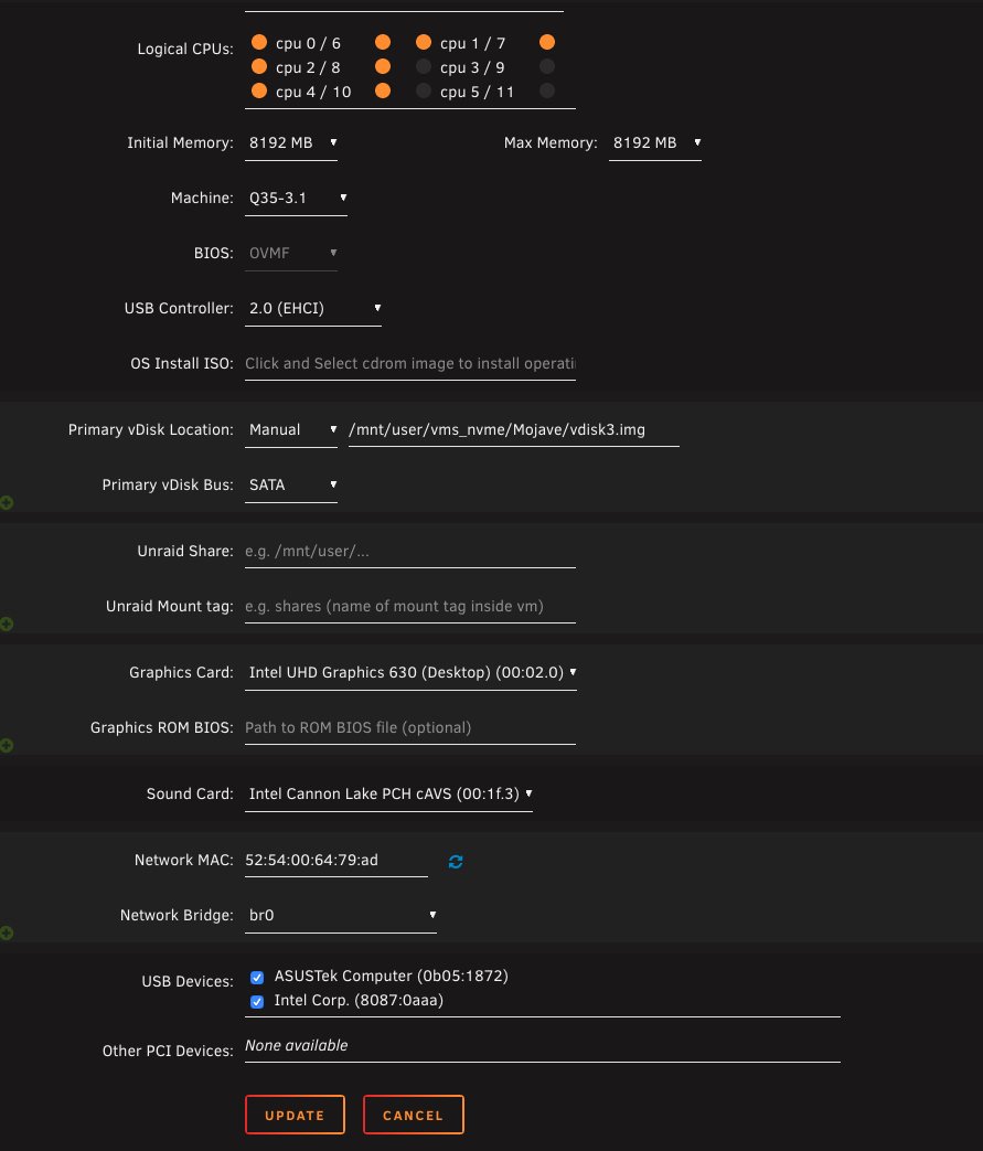

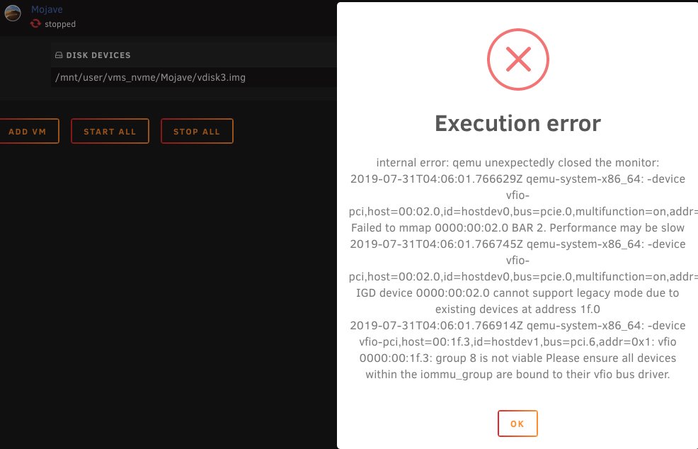

  11. Hello, I followed the Youtube video on installing Mojave, and it worked, until the last steps where I edited VM to switch following: 1. Graphics Card: from "VNC" to "Intel UHD Graphics 630 (Desktop)" 2. Sound Card: from "None" to "Intel Cannon Lake PCH cAVS" 3. Checked "ASUSTek Computer" and "Intel Corp." Then I got an error message when starting VM (even when I chose individual choices above only, I still got error message). I cannot start VM at all. As soon as error message appears, VM stops. Does anyone know how to fix this? I attached all settings I have, along with log files. Here are my core server components: 1. CPU: Intel Core i7-8700 with integrated UHD graphics: https://ark.intel.com/content/www/us/en/ark/products/126686/intel-core-i7-8700-processor-12m-cache-up-to-4-60-ghz.html 2. MoBo: ASUS ROG STRIX B360-I GAMING: https://www.asus.com/us/Motherboards/ROG-STRIX-B360-I-GAMING/ When I run in terminal: lspci -nn I get: root@Tower:~# lspci -nn 00:00.0 Host bridge [0600]: Intel Corporation 8th Gen Core Processor Host Bridge/DRAM Registers [8086:3ec2] (rev 07) 00:02.0 VGA compatible controller [0300]: Intel Corporation UHD Graphics 630 (Desktop) [8086:3e92] 00:14.0 USB controller [0c03]: Intel Corporation Cannon Lake PCH USB 3.1 xHCI Host Controller [8086:a36d] (rev 10) 00:14.2 RAM memory [0500]: Intel Corporation Cannon Lake PCH Shared SRAM [8086:a36f] (rev 10) 00:14.3 Network controller [0280]: Intel Corporation Wireless-AC 9560 [Jefferson Peak] [8086:a370] (rev 10) 00:16.0 Communication controller [0780]: Intel Corporation Cannon Lake PCH HECI Controller [8086:a360] (rev 10) 00:17.0 SATA controller [0106]: Intel Corporation Cannon Lake PCH SATA AHCI Controller [8086:a352] (rev 10) 00:1b.0 PCI bridge [0604]: Intel Corporation Cannon Lake PCH PCI Express Root Port #21 [8086:a32c] (rev f0) 00:1c.0 PCI bridge [0604]: Intel Corporation Cannon Lake PCH PCI Express Root Port #5 [8086:a33c] (rev f0) 00:1d.0 PCI bridge [0604]: Intel Corporation Cannon Lake PCH PCI Express Root Port #9 [8086:a330] (rev f0) 00:1f.0 ISA bridge [0601]: Intel Corporation Device [8086:a308] (rev 10) 00:1f.3 Audio device [0403]: Intel Corporation Cannon Lake PCH cAVS [8086:a348] (rev 10) 00:1f.4 SMBus [0c05]: Intel Corporation Cannon Lake PCH SMBus Controller [8086:a323] (rev 10) 00:1f.5 Serial bus controller [0c80]: Intel Corporation Cannon Lake PCH SPI Controller [8086:a324] (rev 10) 00:1f.6 Ethernet controller [0200]: Intel Corporation Ethernet Connection (7) I219-V [8086:15bc] (rev 10) 03:00.0 Non-Volatile memory controller [0108]: Micron/Crucial Technology Device [c0a9:2263] (rev 03) root@Tower:~# 4-Log Files.txt
