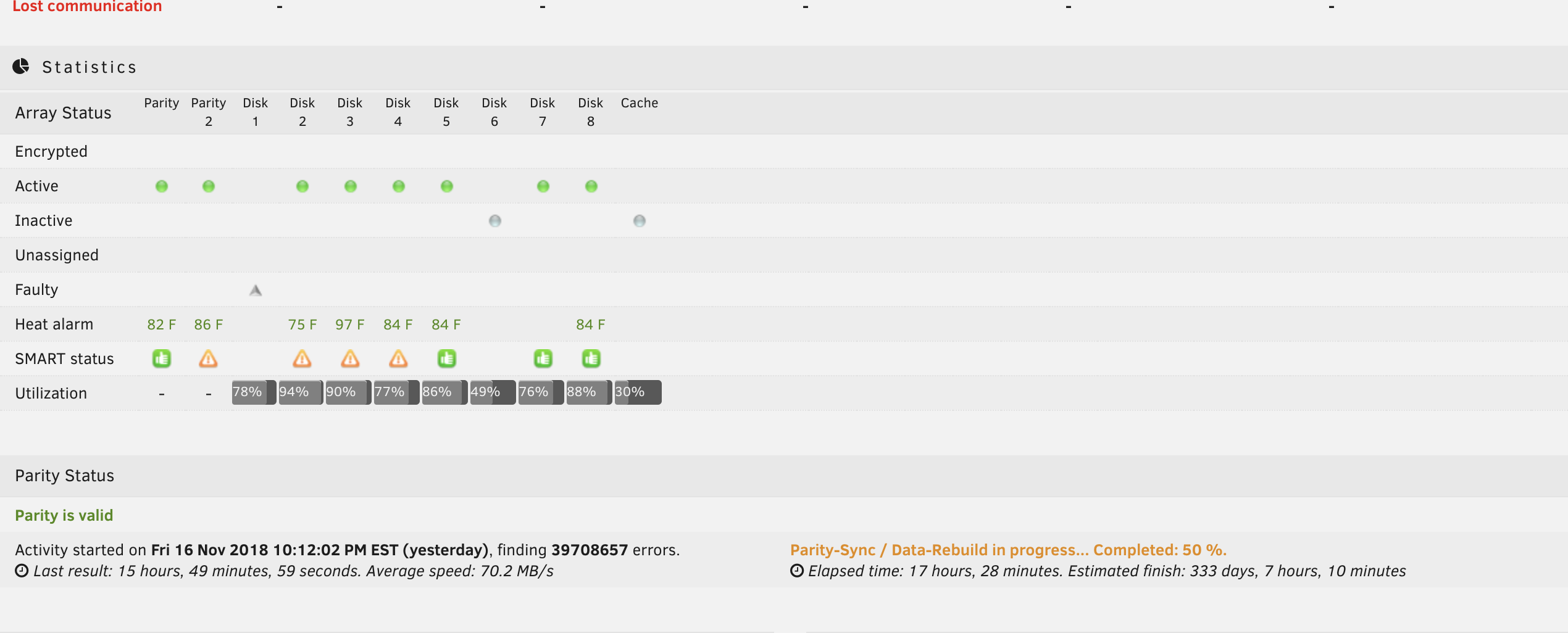

So, here is my issue(s) that I am having with my Unraid.  Hopefully i can fully encompass what is going on.

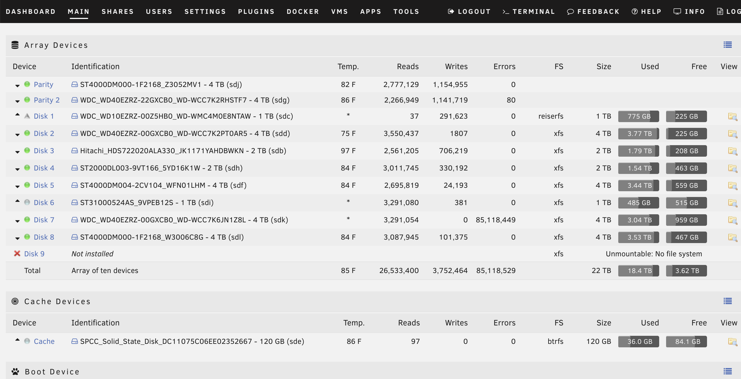

I first started seeing drives randomly becoming unavailable in my rig. This would, of course, cause data to become unavailable (very worry some). At first, I could take the server offline, and re-add the drive back. The Parity would begin its process of rebuilding, no issue.  Things would be great for about a month , then another drive would go offline.
I then started seeing an issue of one failed drive (new WD Blue 4TB). Bummer, it was about two years old, but that happens. I then swap it out with a new one, which proceeded to fail or report back failed/unavailable within 3 months (from memory).  The two drives were connected directly to my MB's SATA ports. I moved them to the controller and re-added them. Issue solved.
Most recently, I am now seeing more than 2 drives failed, at the same time and my data is now unavilable. I was able to move one of the failed drives to the Sata/PCI controller (which is now maxed out) and re add it.

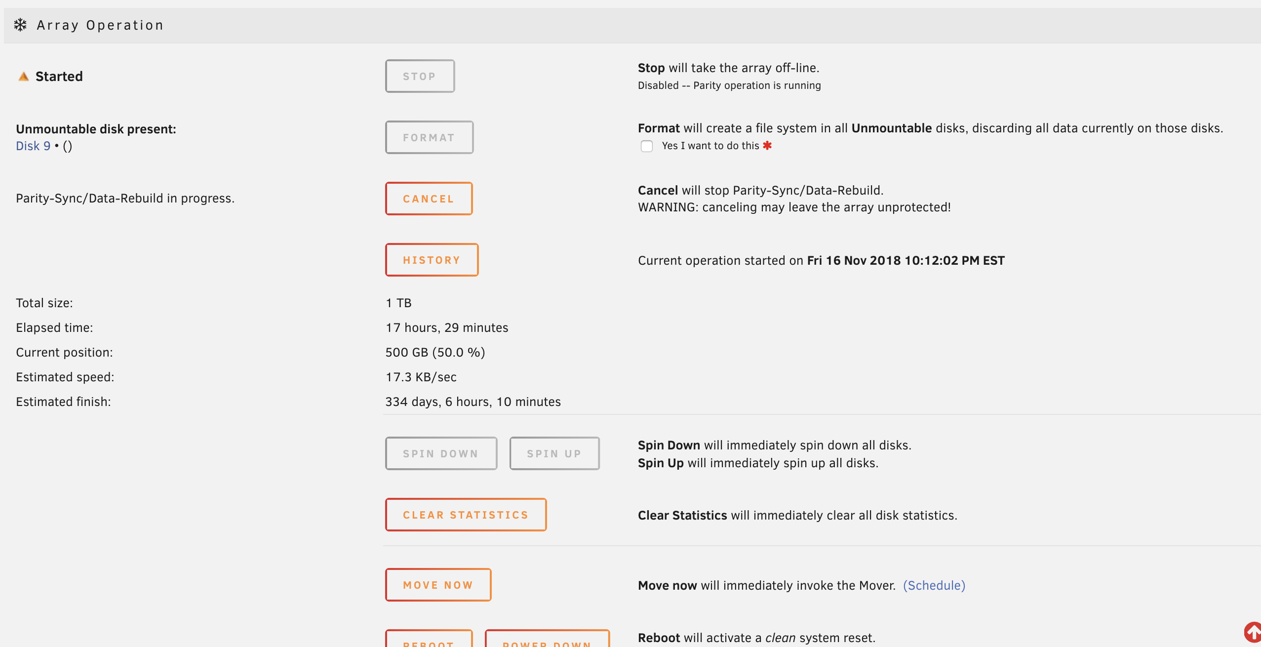

Parity Sync / Data Rebuild  . Stated it would take about 1 day to complete (bummer, but I am ok with that). I now check and the rebuild is at 18Kb/s, etimated time is about 344 Days to complete. It is stuck at 50.0%.
I am up to date with all the settings on my UnRaid.  When going to System Log > my browser doesn't pull anything, just spins indefinitely.
So... what  the heck is going on?

Update 01: I was able to pull this information under "HISTORY" . the drive that is reporting back all the errors is a new drive.
DateDurationSpeedStatusErrors
2018-11-16, 12:29:4215 hr, 49 min, 59 sec70.2 MB/sOK39708657

It states:  Parity Sync / Data Rebuild 50.0% .     (this is where it has been stuck at all day). With the estimated completion time going up in days @ 13Kb/s. Originally when this started out it stated it would take 1 day to complete (estimated time) and was doing the procession at 50MB/s (if i recall). This morning when i woke, I see the updated time.
I will edit the comment above. Again, this is my error for mislabeling.

Lost of ATA errors on disk4, it might the Marvell controller, it might be cable related.
Both disk1 and disk9 have filesystem corruption and need to be checked.
As mentioned earlier parity2 is failing, since you rebuilt two disks at once there were read errors during the rebuild and there will be some data corruption on the rebuilt disks, possibly just on disk9 since the errors appear to be on the last sectors and disk1 is much smaller.

Check filesystem on both disks, you'll also need to replace parity2.
New to this part of the system.
To confirm.   my disk9 states it must be formatted before it can be mounted. Should I do this? [1]
Some searching brought me to this website: https://wiki.unraid.net/Check_Disk_Filesystems
Is this what you were referencing when you stated to check the file system?[2]
Additionally, reading through this, it appears there are two methods. One via, command line, the second via the web gui-when restarting in maintenance  mode.  Is the maintenance mode preferred ?[3]
thank you (as always).
Edited by bradtwo
6 minutes ago, bradtwo said:
Semi noob question here. From my searching I found this article on Checking Disk File System for Unraid: https://wiki.unraid.net/Check_Disk_Filesystems
The parameters it stated was  "  reiserfsck --fix-fixable /dev/md5 "
is this the correct method?
You should be able to do it from the webUI. Just click on the disk to get to its page. As it explains on that page, you will have to start in Maintenance mode.
VERY QUICK RESPONSE!  (thank you). !!!!
I just edited it when i re-read the bottom bit where I saw that. Thank you for the confirmation on this.  Hopefully I can get this into a state where i can recover the data, then  the plan is to replace those controllers and rebuild.
