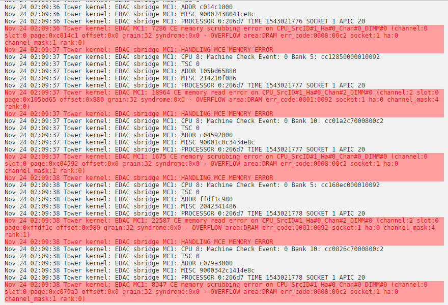

I keep running it to this weird ram issue, where my log kinda get over flooded with RAM error messages, and don't know why. I have tried switching some of the ram around, but non of it seemed to have worked. Have even tried leaving the system running without any dockers or VM's running. And it still comes up after some time. Sometimes it takes as little as 2 hours to show up. Other times it can take 2 - 4 days. But as soon as it does. I'm hit with a massiv VM performance performance hit.
I have a little screenshot and the diagnostic files here:

Well, the clue is in the error message. You have a faulty RAM module, or a bad DIMM socket. If your BIOS has an event log it will help you locate the fault.

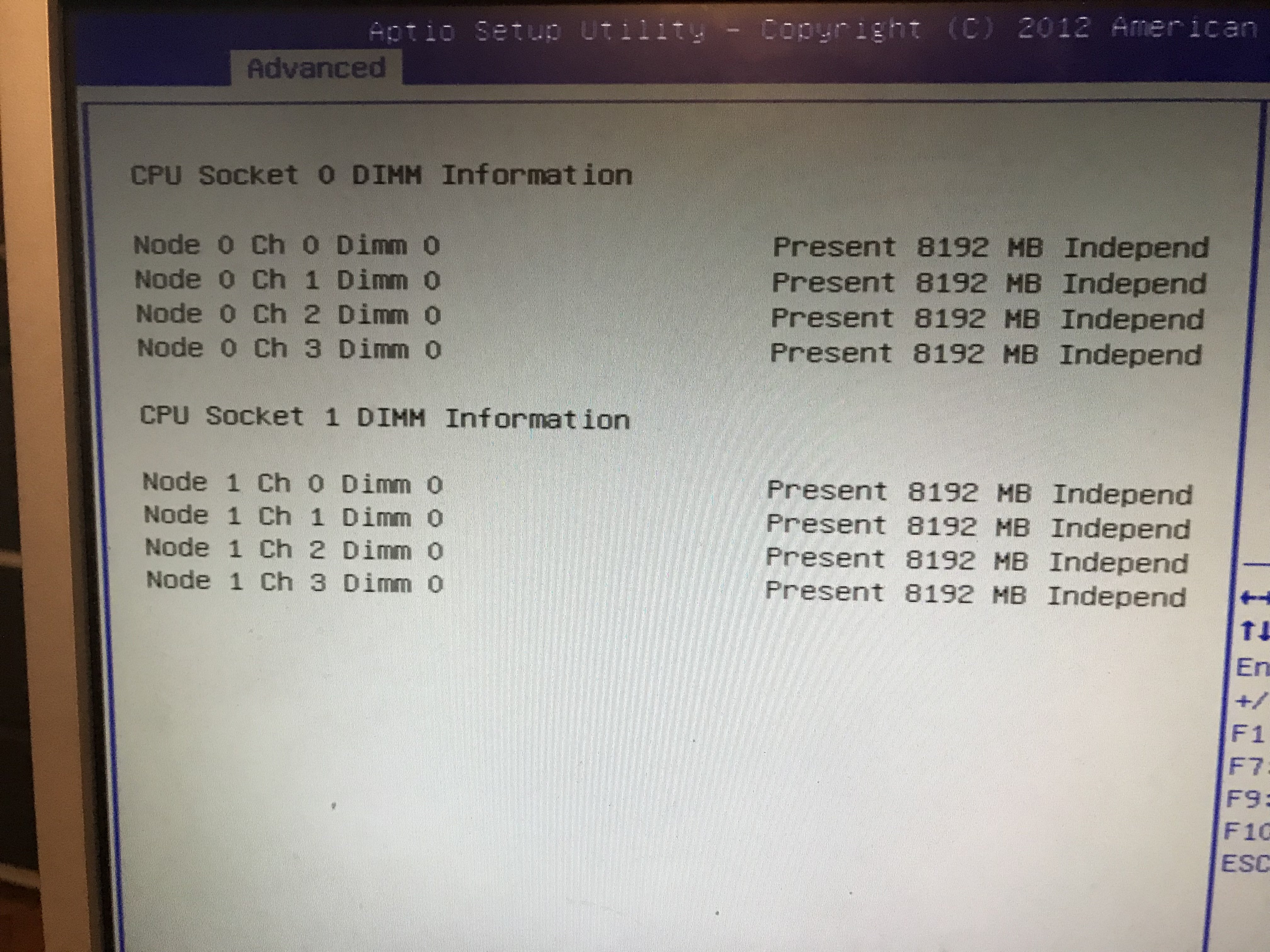

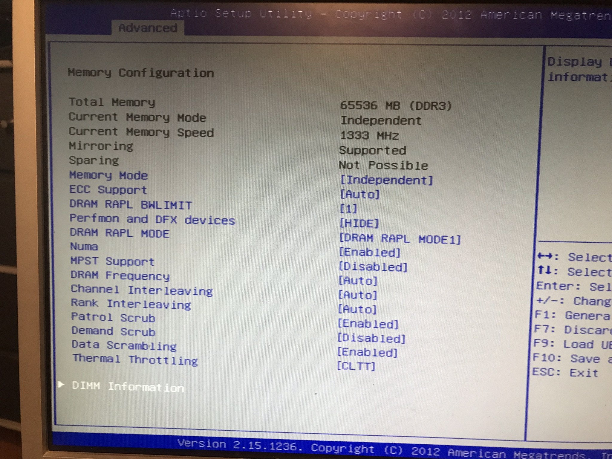

i will post a screenshot of my memory section in the bios in a sec
- I have switch the ram around, and can see that the issue now is on socket 1 instead of socket 0. So I think it's some of the ram that are failing maybe. Just really hard for me to identifying what stick(s) it is....

It looks like two faulty DIMMs. The Unraid log suggests Channel 0 and Channel 2 of CPU Socket 1 in your most recent post but that might not coincide exactly with your motherboard's terminology. Does the BIOS itself have an event log? If it does it should make it easier for you to identify them
I think it is the RAM then. Because I switched all of them around like 4 days ago. And the DIMMs location reporter by the log seem to have moved around indeed. But the documentation for the motherboard is not really clear on what DIMM slot is what channel. So maybe I need to do some trail and error and look in the reported installed memory to locate it..
But just flashed the BIOS to the newest version today. They released a spectre and meltdown patch. So will leave it running, until I get the error again. And will post it. But before I flashed it, it didn’t even show anything about memory errors in the event log :-(
Hi @John_M I got the error once after the BIOS upgrade, but then it showed socket: 0 - and their is literally no sign of anything in the eventlog 😮 I have no clue what is going on.. But have noticed, that on some rare occasions my motherboard throws a error 60. The BIOS error codes says that it's a memory error, and a recommended option is to reinstall the cpus and clear the CMOS. So maybe I will do that in the weekend. Take out the CPU's and swap them over in the opposite and maybe move tha ram around again. :-S

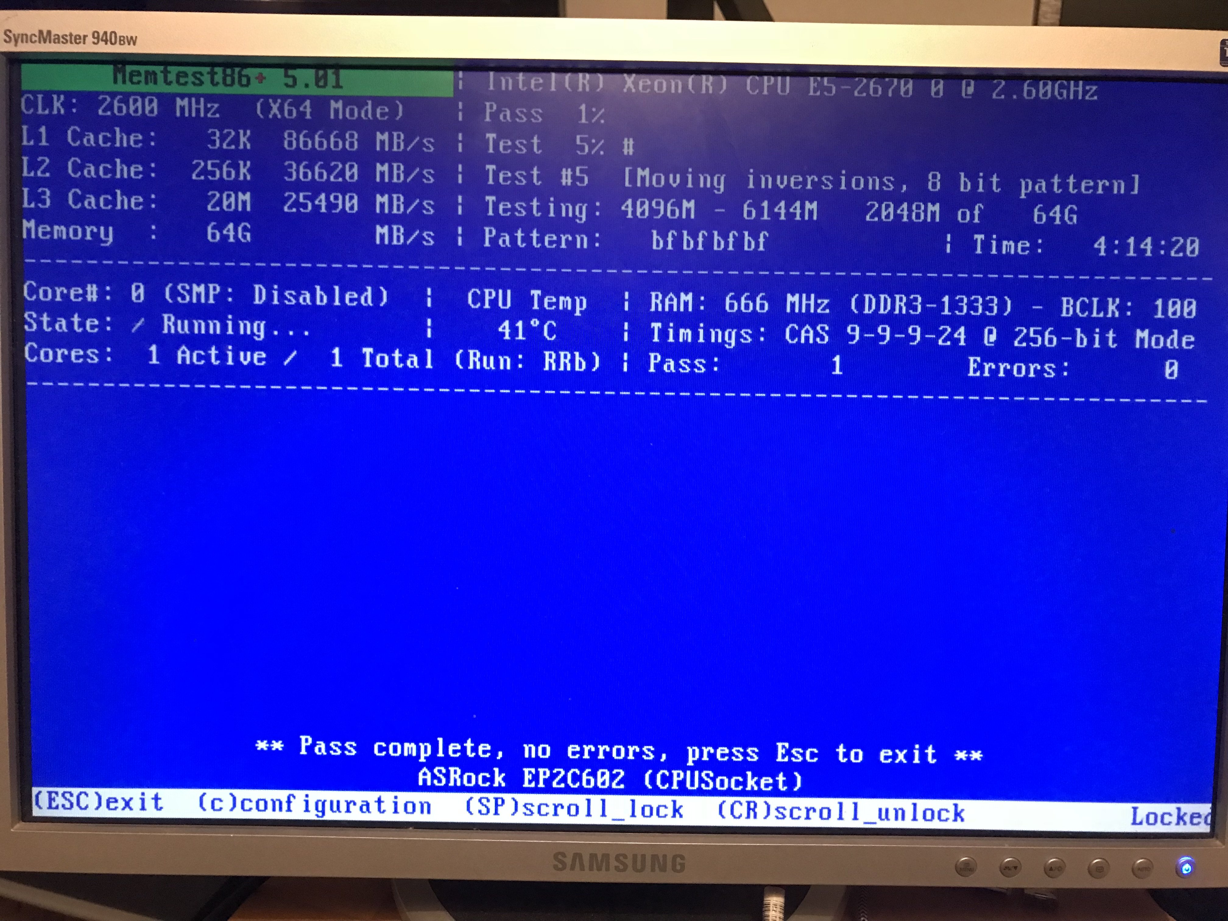

Hello @Frank1940 and @John_M I'm running memtest86, from the unraid boot menu. And I just hit the first pass, it did 13 tests to complete one pass. But I have some minor questions; in the Testing line (just above the Pattern) it says 2048M of 64G. I did not increase when it did the first pass. Do I need to change something or? Seems quite odd to "only" test 2048 of 64G :S
It has been so long since I ran this test (and I can't remember if I sat there watching its progress), I don't remember exactly what is happening.  But it seems to me, that it has to test the block of memory where the code resides also.  So it may be doing that in a separate pass before it does the rest of RAM.  By the way, it is recommended that you run it for at least 24 hours.  Hopefully, it will complete more than one pass in that time period.  (But the problem with the 24 hours recommendation was that was back when 8GB was the high end of the RAM installed in most Unraid servers.)

It has been running for 17 hours and 33 minutes now. The first pass took around 4 - 5 hours. And it says that it’s running at 666 MHz?! It’s only 68% complete on the second pass

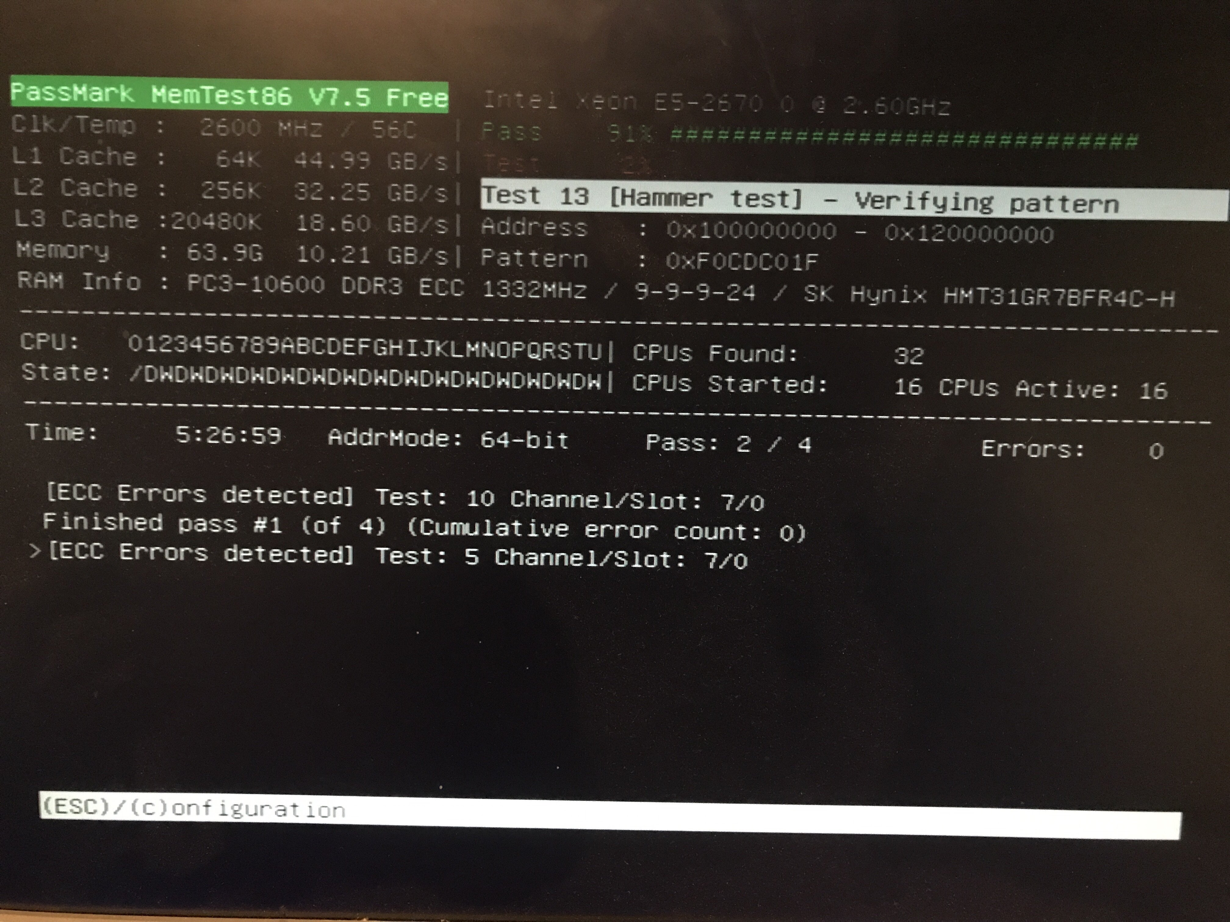

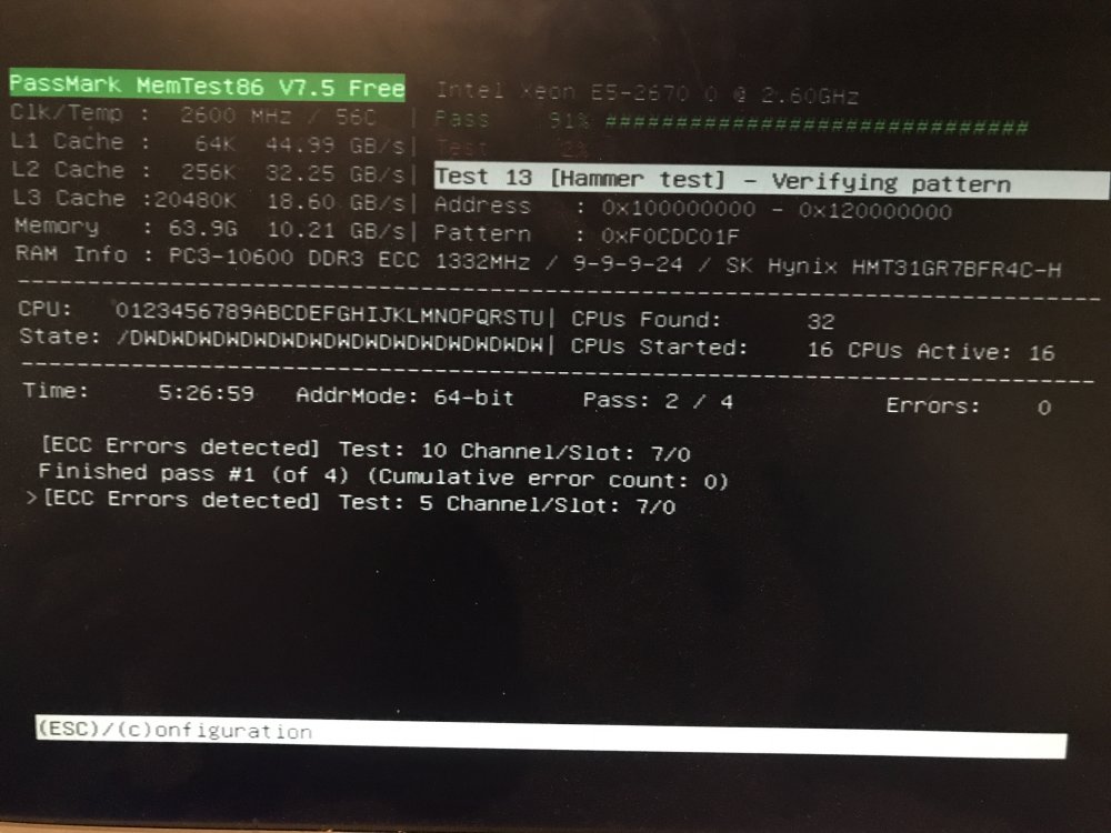

I had to change a few BIOS settings. So I boot UEFI first and fallback to legacy. I’m running MemTest87 V7.5 on almost the 6th hour by now. Been through “almost” 3 passes now. And both of those said their was a ECC error on Channel 7. But I did also change a setting in the BIOS from auto frequenzy on the ram to lock in 1333 MHz. But I’m pretty sure that would not matter much. As I kept getting the errors in the unraid logs too. - so think I have to message the eBay seller, and ask for a replacement. The are only little under a year old. 😕
I'm not sure why you're carrying on testing for hours after a fault has been revealed. You know you have faulty RAM. Unraid has already told you so. You just need to find out which DIMMs are the bad ones. Does "Channel 7" give you any clue? If so, either remove that DIMM or swap it with another (having labelled them first) and test again. If not, then move them around (again, having labelled them) and test again until you can identify the faulty ones. Your diagnostics suggested two bad DIMMs. Usually when you RMA RAM the vendor needs all the modules in the set to be returned together. I suggest you contact the vendor.

Yeah it is because of the diagnostics, that I keep on running the test. As only one back module or DIMM has shown up by now. And hoping that it will find the other one before it finishes the test. Don't know if I can do any RMA on a ebay seller, but will contact him/her and hear about what we can work out. But I don't really know what Channel 7 is tbh. My motherboard manual is pretty lose when it comes to the RAM DIMMs.
Well glad I could help some johnnie :P

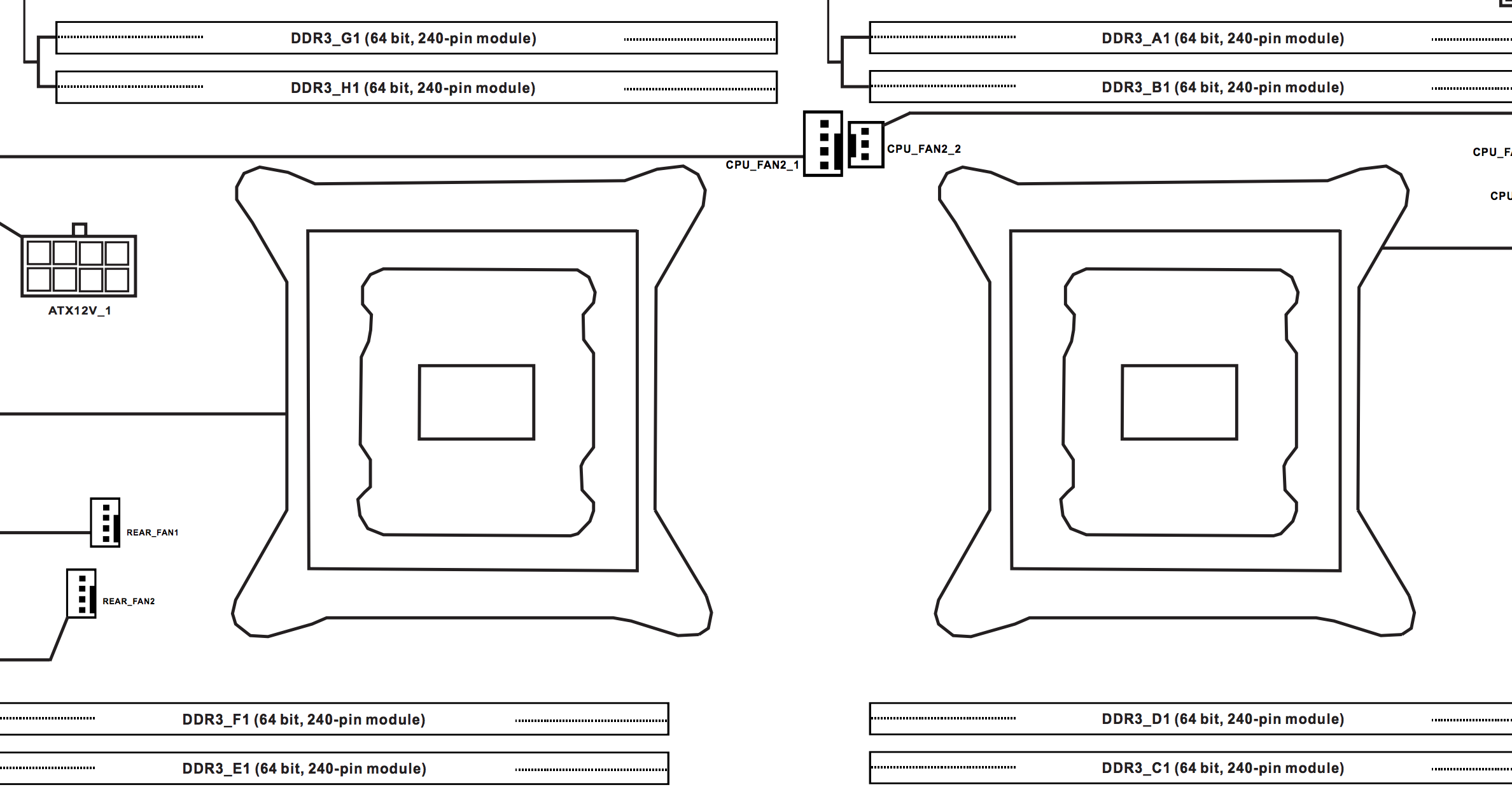

It's pretty hard for me to find the right memory stick. I have no clue how to identity it. The manual only list the slots as DDR3_A1,B1 (...) can I assume A1 is channel 0 and so on? So G1 is channel 7?
