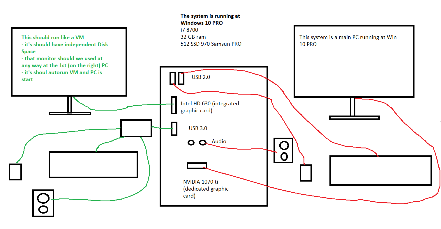

Thank you for the answers!!!! Very helped. I finish the configuration of PC. But I installed the Primary the Windows 10 PRO system.
To work the system like I need am I'm right with that steps:
1) Create a DiskImage of the current Win10 PRO.
2) Install the UnRaid (with erasing all data from the SSD) I have just a 1 disc C:\ on the SSD drive.
3) Choose the DiskImage from the 1 step and run the PC as a 1-st but main VM.
... and check all things
4) After that setup a 2nd VM and passthough the Intel 630 HD, USB 3.0 to that VM.
5) Profit.
Am I right with the step 1 and 2, and all another?
Or better from step 1 not create a DiskImage, but direct connect whole drive to the VM. And if something going wrong with UnRaid. I just have abiblity to reboot the system and load it as usual do. And continue my work)
Any thoughts?

Does my image looks like complicated? )

Hmmm... seems like you are not getting the limitations of unraid.  Each VM that you want to connect a monitor directly to will need a graphics card dedicated to it.  You can use embedded graphics for unraid but you won't want to use it on a VM.  Also, unraid boots from a usb drive and hosts images on top of that using KVM. Drives can be pooled or passed through to machines directly- which is your best bet for speed.  If we are talking about CAD here- you would be best buying a new graphics card that supports SRVIO and setting up a proper esxi server and passing a number of GPU cores to it.  Using unraid means that all disk and machine activities are hosted on top of a custom slackware linux kernel with some nice features added.  Using unraid here is not going to get you where you want to go without planning- then buying components that are exactly right for this project.

heh, really. So yes if it's, looks like I need to buy a dedicated graphic card.
Did get this, sorry. I have a UnRaid USB and boot from it. And have 1 NVMe PCI and 1 SSD and 3 HDD into my Tower. So it's not possible to pass-through NVMe PCI directly to VM which I'll be using on the machine where USB with UnRaid inserted?
So it's not possible to use CAD on the VM (on local PC) with GTX 1070 ti on it? I think it's possible, but right now I just gathering information before try)
What is my pain right now:
- is it possible to boot from USB UnRaid connect, connect my NVMe PCI drive (with already installed Win 10) and use it in that way.
and if something going wrong, I just delete the USB and boot with my NVMe PCI again whithout any de-installation of Win 10.

Hmmm for me using RPD is still create a pain while I'm using it on local PC)

does any other solution on the market which one working smoothly ? And my plan will not work with UnRaid?
I think the issues with that process are related to windows activation and hardware changes that would happen between the VM and the physical machine.  I think other people have posted some workarounds, but this will definitely be a bigger pain in the rear then just excluding a drive from unraid all together and booting to windows on that drive.  It would depend on the setup once you boot a physical windows copy- to access any other drives that unraid has access to.  Technically, you are not really allowing unraid to do anything but be a lightweight hypervisor with some unassigned devices that are consumed by VMs when they boot.
