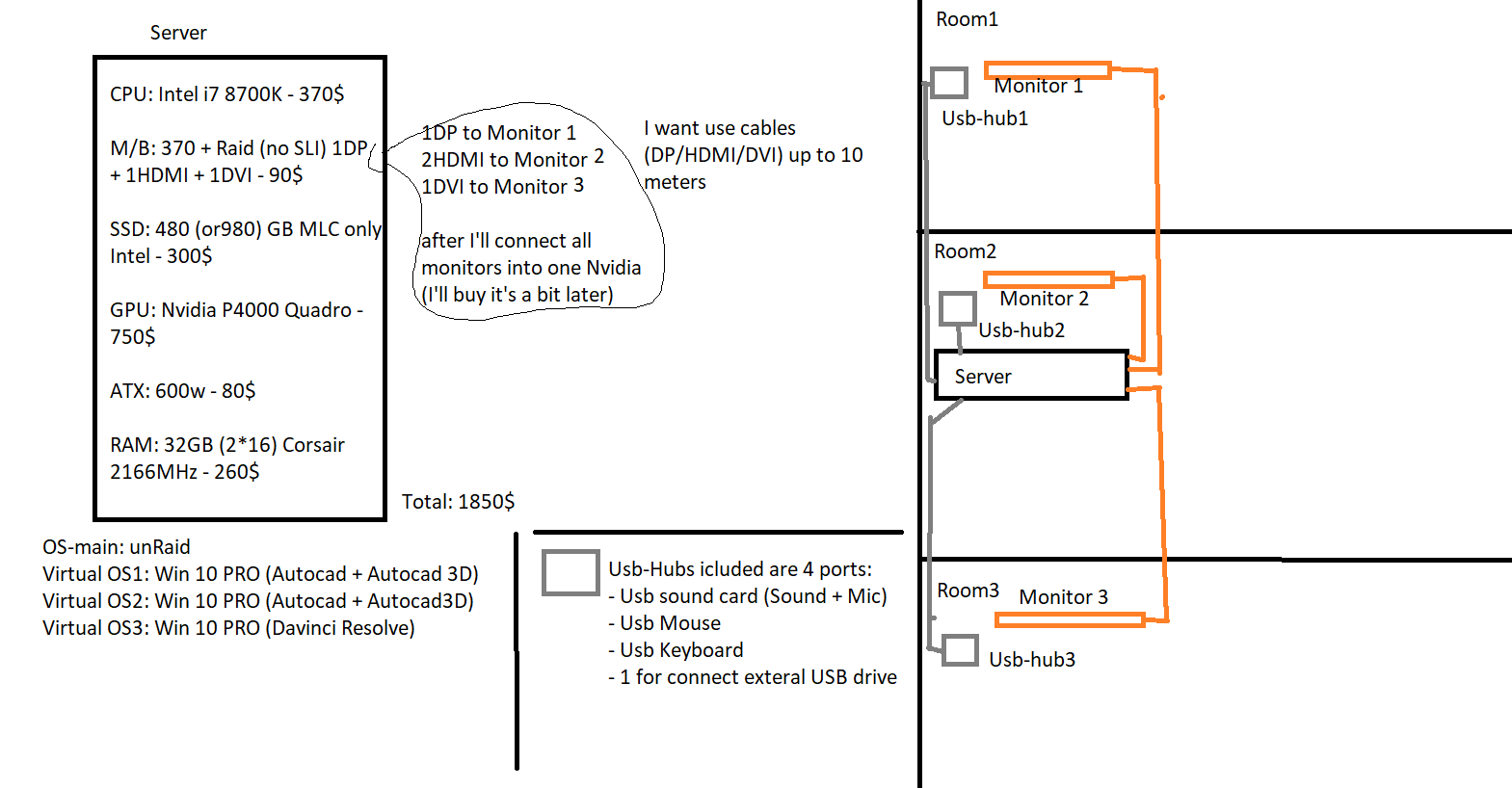

Hello everyone) After watchign Linus videos about installing several work places at one PC I want to do by myself)
I actually need for 2 Autocad (+3d Autocad workers) and for me for video edditig videos from the trips and from the Chromakey in Davinci Resolve (free version).
I tried to visualize it. If somebody uderstand what I want to archive I'll be happy to receive any recommendations)
The software may be UnRaid, Microsoft Multipoint Server 2016.
left - the server specs
right - 3 rooms of each worker
ps: I really want and hope on the BlackFriday it'll be discounts)
The plan is: install the unRaid software and after that install Windows 10 PRO on each of the machines and use them just by turning on the monitors at work places)
I don't think you can use 1 GPU in 3 VM's at the same time.
The PassThrough GPU is not a way to realize it?
Passing thru the GPU will work, but (if I am remembering correctly) you will need a separate GPU for each VM, assuming you intend to use them at the same time.
This is correct!   You cannot split up the ports on a single GPU among different VMs.
And if I'll buy the 2 the cheapest GPU just for monitor connection. I'll have posibility to use my main Nvidia Quaodro as a Passthrow? (and this card will be using already by one of VM.
If you want to install 3 independent VM´s, you´ll need 3 independent GPU´s. That´s for your purpose.
Be sure to choose the right ones which support your programs.
And don´t forget to think about also 3 independent NIC´s.
I'll buy the cheapest GPU, but I need ability to use the MAIN power of Nvidia Quadro GPU.
And what is the NIC's mean... don't understand this terminalogy)
@MakarkinPRO If you need the power of the quadro in 3 vm's you need 3 quadros. You can't use one GPU in 3 desktop pc's at the same time, right? Same for VMs. As soon as 1 VM uses one secific GPU other VM's have no access to it.
And I heard about termin GPU Passthrough. Does it's not mean like using 1 GPU power for 3 VMs?
That's not how it works in Unraid at least not now with consumer and workstation GPUs. There are Server GPUs that supports SRIOV but i don't think Unraid is ready for this yet. Nvidia and Amd not selling such GPUs to the mainstream user atm. Might be changing in the future but don't expect it to be happen. As soon as it happens, expensive server parts will become obsolete if cheap mainstream gear can do the same thing. You might can use a Windows Terminal Server with the one specific Quadro card passed through and have multiple users connected via RDP to it and make use of it. Depends on the software. For some applications you need special licenses to work under TS. If you watch Linus video again you can clearly see, he passes through ONE card each per VM. Also noted in my experience Autocad benefits from lots of RAM especially in 3D mode. 32GB might be ok for 1 VM and same with the CPU. 6 cores 12 threads thats 2 cores 4 threads for each VM. Did you ever used Autocad or a video editing software on a dual core system? With your specs you can play around with it but forget about a perfect experience on these ressource heavy tasks.
[emoji848]
One GPU per VM....,.........
Sent from my SM-N960U using Tapatalk
I actually thought the Resources will be not fixed for a particular VM. And it'll be flexible, like if AutoCad requesting more power it'll get more and if Davinci resolve will request more power it'll use for CPU cores and more GPU power. Am I correct with this or not?
You have to specify which core is accessible by which VM. Sure, you can give 2 VMs the same cores but as soon as 1 VM will use lots of ressources the other will throttle or completly pause for a second. Forget about the idea of 3 VMs using 1 single GPU and all the same cores with enjoyable experience. There is a reason why people buying expensive workstations for 3D rendering tasks or video editing.
I just thought about it like running 2 Autocads and 1 Davici Resolve programms at the same time. But just need to separate in to 3 USERS. Will be it a wise idea to setup a UnRaid + 1VM settig up everyting think correctly to mai users.
And after that trying to connect another ones?
Hardware that is passed through (i.e. cards) cannot be used by more than one running VM at the same time.    The same applies to RAM so you need enough RAM for all the VMs plus some overhead for Unraid.  USB devices such as mice/keyboards can be allocated to specific VMs without needing to do hardware passthrough (buy no device can be used by more than one running VM at a time).
CPU cores can be shared across VM's (although a particular VMs definition will specify which cores can be used). and the system will allow it to be shared with other VMs that have the same cores allocated.   However this can lead to unpredictable performance in a VM if two different VMs make demands on the same cores at the same time.  As a result many people prefer to dedicate particular cores to specific VMs to reduce contention.
The specs for Unraid + 1 VM should be ok. You can test it if Autocad allows you to connect a second user via RDP to the VM and run a second instance of Autocad. Usually you need a special license for this to work.
