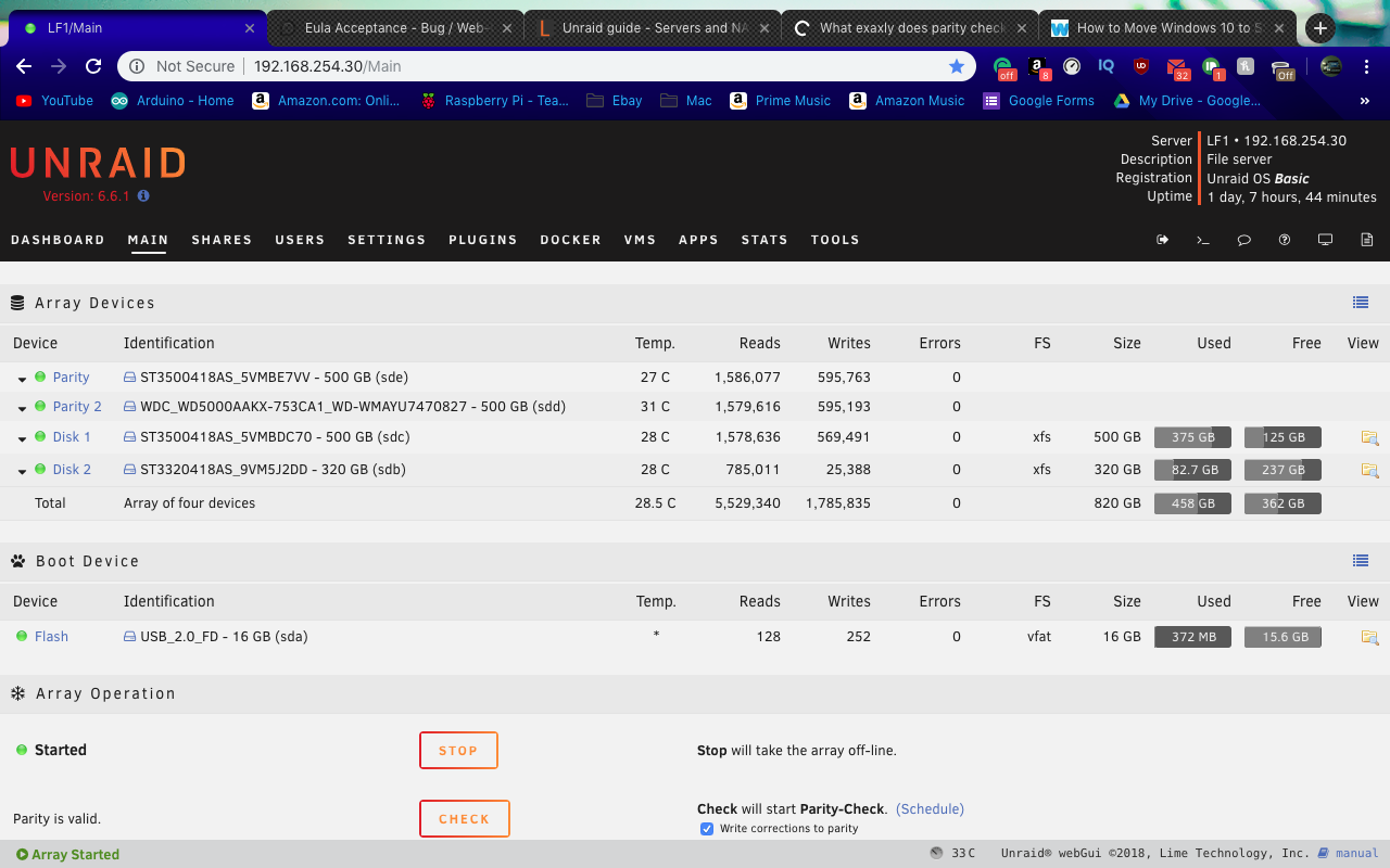

Here is my current unraid setup. I want to add a 1tb drive to my array. I was going to move one of my 500g parity drive to my main array and then add the 1tb drive to the parity slot I just switched out. Is this how I should do this or should I only have one parity drive?

It seems more logical to me to replace one of the parity disks with the 1 TB drive first, then add the old drive as a new data disk when the parity has rebuilt.
Your method would work but it's less safe as you're needlessly trashing the contents of a parity disk before you actually have to.

Personally I wouldn't bother with dual parity with so few disks.

Unraid won't let you have a parity drive smaller than any data drive.
Parity doesn't store any data by itself, it works along with all the other remaining drives to reconstruct 1 missing drive.

All your data IS protected!    When a drive fails it is reconstructed using the combination of the parity drive plus ALL the other data drives.

No, you have 2 x 500GB parity, which gives you 2 independent 500GB parity disks. You don't add them together.
A single 500GB parity disk can protected any number of data disks, as long as each data disk is 500GB or less.
Parity IS NOT a backup. As mentioned, parity allows the data for a missing disk to be calculated from the parity disk PLUS ALL the other disks.

It is worth pointing out that the 2nd parity disk works in a similar way to that described for parity1 in the suggested link but uses a different mathematical formula so that parity2 is independent of parity1.

Is that 1TB drive going to become a new parity1 drive?    If so that would be OK.   If not then your array would be unprotected against drive failure.   It is perfectly OK to run unprotected if you have a backup strategy in place to recover data if a drive fails, but most people prefer to have at least one level of parity protection in place.

I am going to have one 1tb drive for parity. Just to make sure if one drive fails on the array all data on that drive will be rebuilt, correct?

Yes.  The number of simultaneous array drive failures that can be handled is the same as the number of parity drives.
If you DO happen to get a drive failure and are not sure how to proceed then ask here in the forum first.    Taking the right action will recover your data, but taking the wrong action can result in data loss.  One is often in 'panic' mode after a drive failure and prone to rushing things.
It is worth pointing out that you should still have a backup strategy in place for any data you really cannot afford to lose.   Although unlikely it is possible that some catastrophic event (e.g. PSU going rogue, lightning strike) could fail multiple drives simultaneously and the simple recovery process will not work.   Unraid is good at handling even such events if one is careful but you do not want to rely on this being the case.

Just to clear up some terminology for you. The parity drive(s) plus the assigned data disks ARE the array. In other words, parity is in the array by definition. If you notice in your screenshot the heading above parity and those assigned data disks it says "Array Devices".
Flash, cache disks and any unassigned disks are not in the array.
