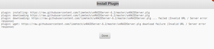

upupgrade to 6.1 problem
I am trying to upgrade from v6.1
I followed the instructions
Copied the target url.
However the following is the log message that is returned....

Might not be able to do the upgrade using the webUI from that very, very, very old version.
You might even have some trouble with the Update Notes, but see if you can work through this:
Even if you do a manual download, I still recommend reading through those Update Notes I linked. There are a few things that people get hung up on making the transition from versions before 6.4
Probably none of your plugins are going to be compatible now so consider removing them all before doing the upgrade.

 Well worth it. Nobody can support that old version since nobody is running it.
I'm not sure if Community Applications was around back then. In any case, once you get the OS upgraded install the Community Applications plugin and it will help you choose and install all other plugins and dockers you want.

The basic NAS function will work fine.  All of your data will be safe and the shares will work as they do now.  Many plugins, Dockers and VM's can be problematic.  It is best to remove ALL of them!
Begin by shutting down your server.  Remove the Flash Drive and make a complete copy/backup on its contents onto your PC.  (This is your safety net.)  Now install the flash drive again and reboot the server.
Basically, you need to uninstall all plugins, Dockers and VM's.  You then would install the most recent version using the the new repository that I referred you to in the second post of this thread.  This will/should give your Basic NAS setup with the server name, IP address, passwords, and the other settings that you had with 6.1.9.
Follow @trurl's instructions that he spelled out in this thread.
IF you have trouble or problems, posts back in this thread with the issues and attach a Diagnostics file to the post.  Tools   >>>  Diagnostics

Hurray !!!!!   🙂   It worked .... all that trepidation about nothing !!!!!
FYI.  I did exactly what you said to do.... removed plugins  (none of which i use anyway)
Rebooted  (already had a recent copy of th flashdrive).
Inserted the link into the plugins
(https://s3.amazonaws.com/dnld.lime-technology.com/stable/unRAIDServer.plg)
Executed
Rebooted
Hay viola !!     [  🙂 - i know ;-)... ]
Brilliant.  Very happy.  Thanks very much to both of you.

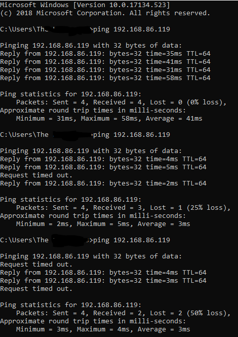

Since I performed the parity swap my file transfer (write) to the unraid is painfully slow (700 kB/s). In addition I am experiencing  frequent buffering when playing media files from my nVidia media player. Nothing else has changed to my setup  Previously i enjoyed multi MB/s.

I have attached a ping log for the server.... the first ping is from before I rebooted the server (whilst the file was taking forever to copy I wanted to check the ping response time).....After I rebooted... I performed the subsequent pings.... as you can see....after the reboot the ping response was terrible....
Any idea why this wold be ?
Thanks
Bad network connection? Any port or plug along the way is suspect.
