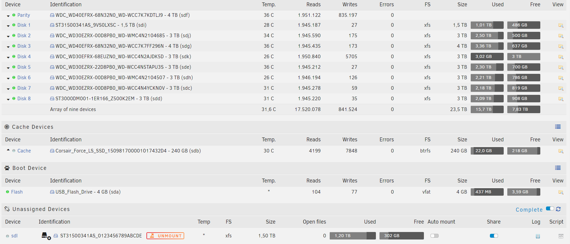

BTW, disk 1 is also bound to be discarded and replaced. Could I copy its content to disk 4, then after that connect the replaced disk (with the missing data) instead of disk 1 and also copy its content, or rebuild parity?
Or even better, can I connect the replaced disk with missing data through a USB  HDD docking station? Will Unraid read the XFS through USB?

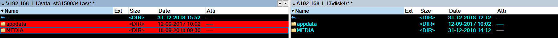

I connected the replaced drive using an external USB dock. As you can see I mounted it and can access it from the network via Toal Commander.
I could copy the content from Windows but I am afraid to lose something due to Windows or filename syntax or whatever, and also I wish to spare my PC the burden to copy all those files.
What command could I use via Unraid Terminal to put all the burden and responsibility on Unraid?
