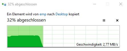

here is another one unraid-diagnostics-20190120-1435.zip
It was taken when this happened:
Sadly thats thats no exception but rather the rule when writing to the unraid server.
Any ideas?
4 minutes ago, Henning said:
Any ideas?
There's read activity on disk3 at the same time you're writing to it, that will severely impact array write performance, there's also reading on disk4.
Thanks for the answer,
reading activity is correct but I was under the impression that writing should go to the cache drive.
The share I was writing too has a split level set, will this setting prevent caching?
Edit: oh I checked the screenshot again, I was reading from the disk so I dont know exactly what was writing to the disk.
Edited by Henning
No, as long as the share is set to use cache, try writing directly to the array with turbo write enable, and see if it's faster.
