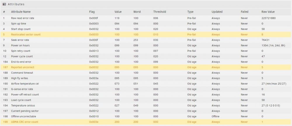

Can someone help me understand Smart Drive Data? I've got some errors. I've attached the log files and posted the short self-test data below:
I've tried swapping out the cable. The Hard Drive is a Seagate Ironwolf 3TB and it's brand new. My config is four 3TB Seagate Ironwolfs 3 are acting as storage and 1 is parity. I also have a 500gb Samsung Evo acting as a cache drive. The four Seagate drives are connected to a controller (I/O Crest 4 Port SATA III PCI-e 2.0 x1 Controller Card Marvell 9215 Non-Raid SI-PEX40064)
The first two drive and the parity drive all have not had any issues and I ran pre-clear on all four drives when setting my system up.
Thanks for your help!

This is all you need to look at:
Num  Test_Description    Status                  Remaining  LifeTime(hours)  LBA_of_first_error
# 1  Short offline       Completed: read failure       90%      1303         5469842936
Failed SMART test = failed drive

Sorry, I'm still not understanding are you saying the drive has failed and that I should replace it?
Edited by jh1987
yes

Got it. I have a replacement on order from Seagate. I'll give it a swap. Appreciate your help.
