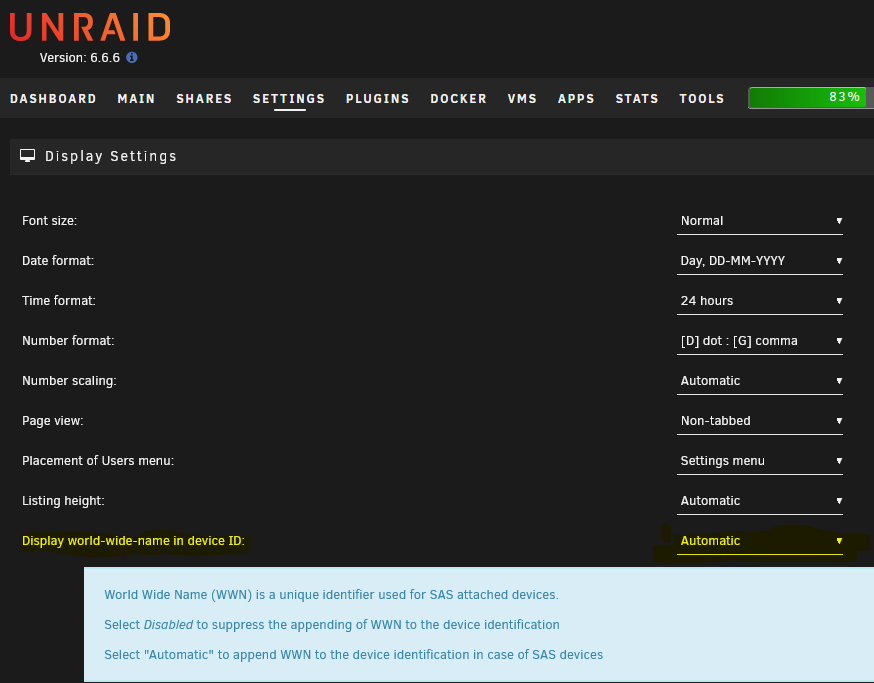

how do you have this setting?
It was disabled but changed it to automatic no change...
ok,

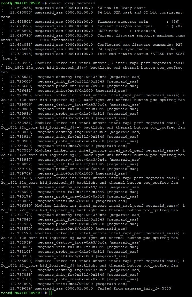

Hi,  Sorry but been offline trying to flash this card but no luck with that either due to sas3flash not detecting the card "sas3flash no avago sas adapters found"
here is my output, not looking good!
dmesg | grep scsi doesn't output anything...
looking at the above screenshot somehow the driver is not loading correctly, what firmware are you running on the H330 and have you tried another PCIe slot?
