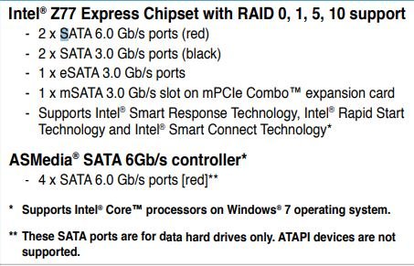

So would you say a SAS 2008 running at X4 would be better than on board SATA?
These are the on-board controllers I have
If you can, don't use you motherboard SATA, these are horrible! (no matter what board you have)
Have to disagree with this, Intel SATA controllers for example are rock solid and one of the best controllers anyone can use for SATA disks and SSDs.
Yes!
the Z77 chipset is connected by a DMI bus to you cpu (4x PCIe) and the ASMedia is connected to the Z77
running an SAS 2008 on an 4x PCIe (gen2 because the SAS2008 does not support GEN3) gives you max 250MB/s per disk with 8 disks in parallel. if you only connect HDD you will only get there with very big and fast drives!
Besides speed SAS controllers (at least from LSI) are way more stable reason enough to stick to those since they cost very little nowadays
