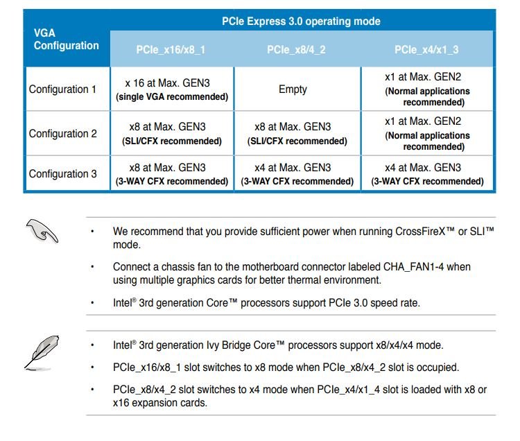

Here is my motherboard config and I think I would have an issue doing this as the PCI Lanes would slow down due to the amount of cards I have installed?
I have a PERC H330 PCIeX8 Gen3 on the way going in slot 1
SAS 2008 PCIeX8 Gen2 (6GB/S) Slot 2
Mellonox 10gbe PCIeX8 Gen2 slot 3
