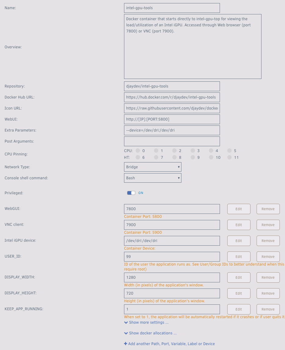

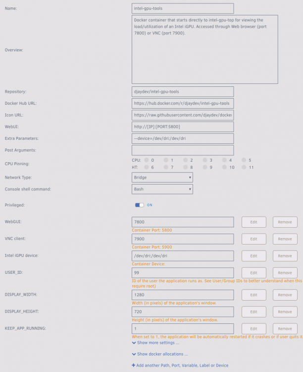

March 29, 20206 yr Author 3 minutes ago, cherrybullet said: I'm getting that error too, but I can see `/dev/dri` and plex is using hw transcode. can you please post the complete docker settings you're using?
March 29, 20206 yr 7 minutes ago, dee31797 said: can you please post the complete docker settings you're using?
March 29, 20206 yr Author Just now, cherrybullet said: You have the /dev/dri mapped twice. Please remove one and retry, let me know if the error goes away or not
March 29, 20206 yr 12 minutes ago, dee31797 said: You have the /dev/dri mapped twice. Please remove one and retry, let me know if the error goes away or not I removed it from extra params and got the same error Not sure if this helps but, I don't know if USER_ID=99 is correct for me. That's just a setting I saw on someone else's setup. Without it, it gives me an error saying it needs USER_ID.
March 29, 20206 yr Author 7 minutes ago, cherrybullet said: I removed it from extra params and got the same error Not sure if this helps but, I don't know if USER_ID=99 is correct for me. That's just a setting I saw on someone else's setup. Without it, it gives me an error saying it needs USER_ID. 'USER_ID'='0'
March 29, 20206 yr 4 minutes ago, dee31797 said: 'USER_ID'='0' getting the SESSION_MANAGER error again [services.d] starting app... [app] starting intel-gpu-tools... [services.d] done. Failed to connect to session manager: Failed to connect to the session manager: SESSION_MANAGER environment variable not defined
March 29, 20206 yr The default template I pulled from CA had /dev/dri twice. I changed it to /dev/dri and it still didn't launch. Showing advanced settings displayed the USER_ID variable, which had no value. I added 0 and everything started working. Thanks for the container! It was interesting spying on my Plex hw transcodes. Edited March 29, 20206 yr by Dase Typo
