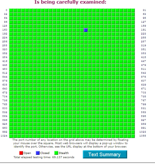

check your exposed ports:  https://www.grc.com/x/ne.dll?bh0bkyd2
If you don't find any- that means that something is exploited within your network.  Do you have a microtik or qnap device anywhere?  Those were exploited en masse recently by a russia hacking group.

Shields up report: shieldsup.PNG.6d724e4b40f8ca57b5bdc2c47064fe2b.PNG
which port is that? 80?

No it's 179/bgp - which is odd.

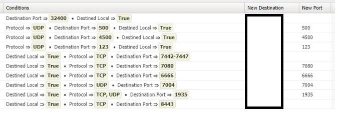

What port forwardings do you have?

also I should clarify, blue means closed. So it confirmed closed.
Oh right.... forgot- haven't had to use sheilds up in a while
