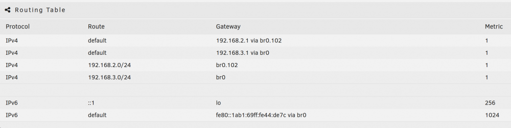

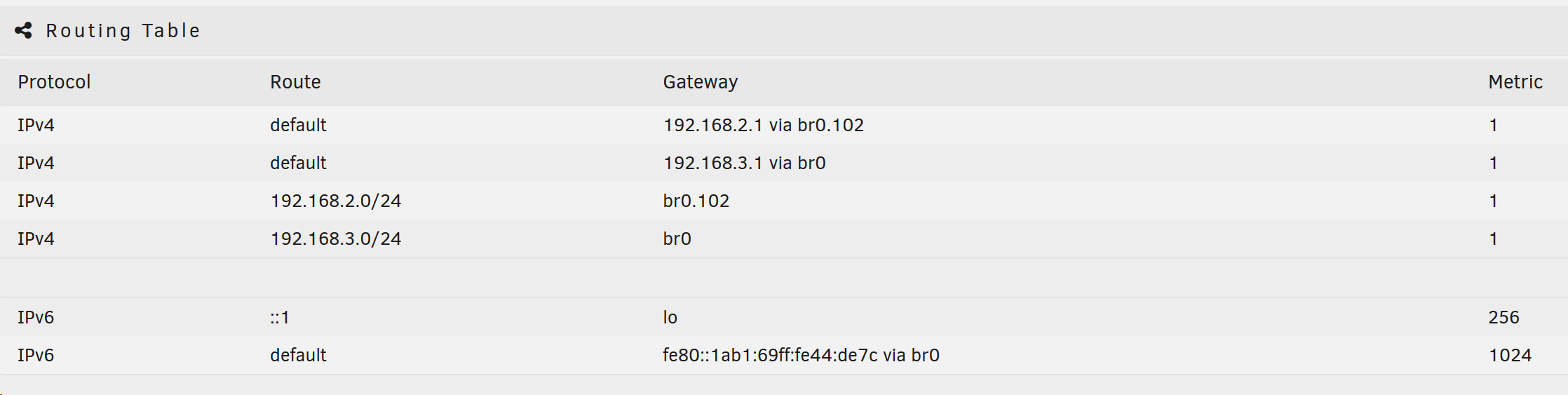

Also the diagnostics don't show the routing table so could you show that as well? ip route on the console or the settings | network | routing table section/tab
this is a universal problem when you have 2 default routes.
what happens is that unless Unraid was trying to reach a local subnet IP, it would pick the last defined gateway and keep using that.

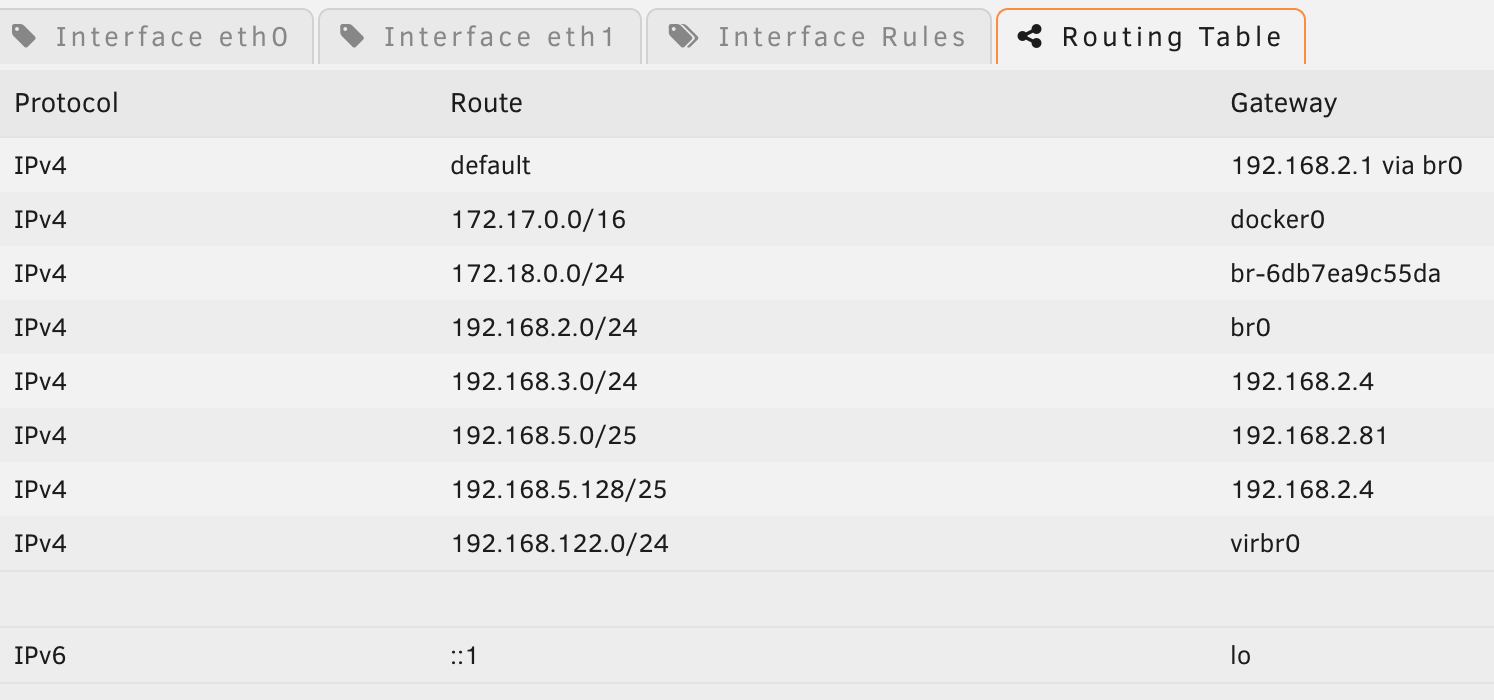

My setup has only one IP assigned to Unraid and and all the VLANs have active interfaces for docker networks, but no IP otherwise.
Removing the second default fixed. Thanks so much Ken-Ji.
Vlan required that the same ip address as primary be put in before it would allow me to remove the second route. After a reboot all good and working as expected.
