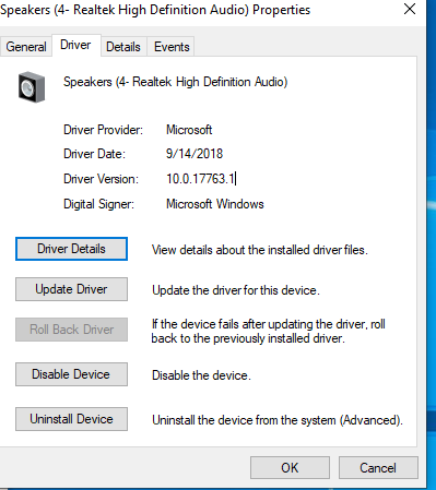

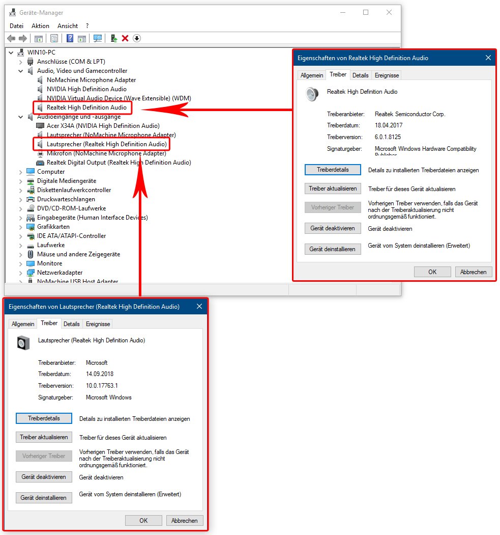

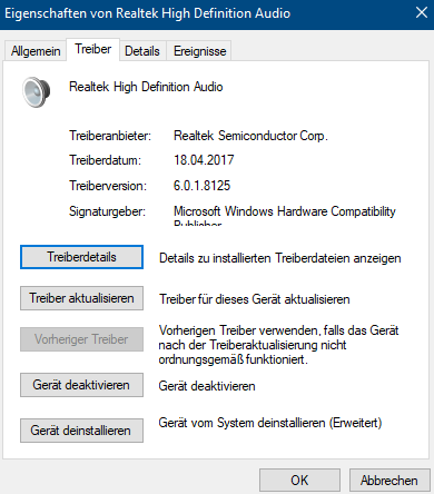

Another idea. What version is your installed audio driver? Just an idea, remebering some AMD GPU users had issues passing through there GPUs with the latest drivers. I have a kinda old driver installed which is working from day one until today.
weird, I installed the most recent from asrock and the driver still says from MS.

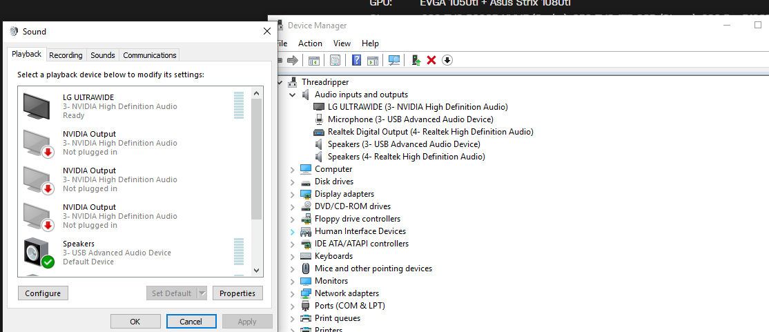

Wait a second. I have 2 Realtek HD Audio Devices, I'am confused right now. Is the upper one part of the 1080ti? I thought the "NVIDIA HD Audio" belongs to the card. 🤔 The other one is the same driver as yours.
One is probably the video card audio. Mine only emulates as a usb device and doesn't output anything. I've disabled all my nvidia stuff.

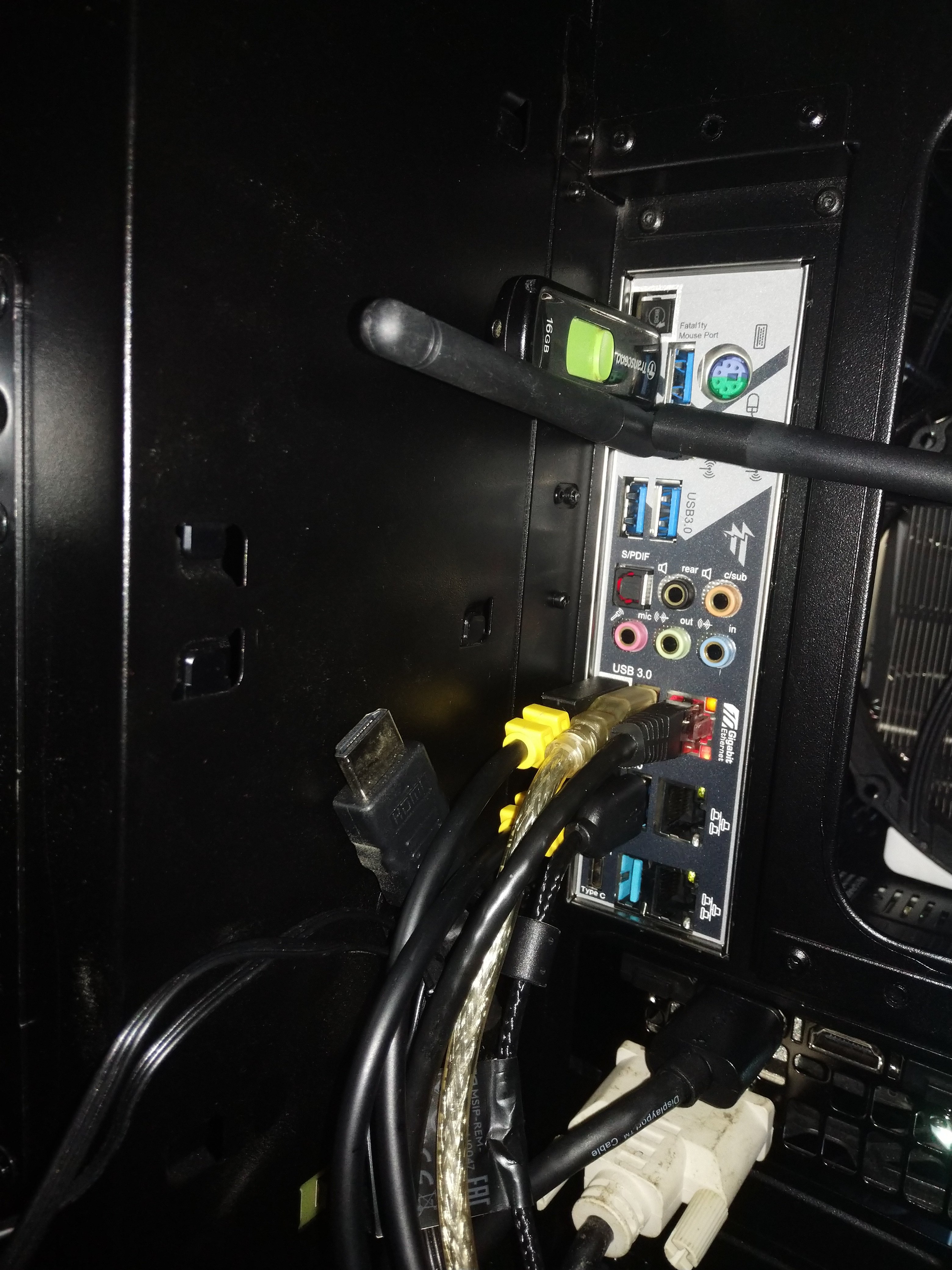

@bastlIf you get a chance, can you show or just tell me where things are plugged into your rear USB.

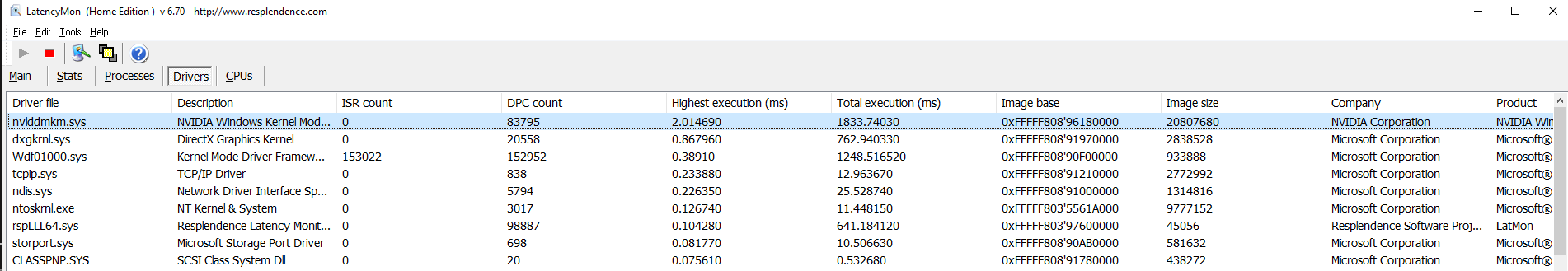

I MAY be onto something. I can't seem to get the gpu passed through, so I'm not sure yet. I tried some of the things that guy had in his xml at level1techs. This is by far the lowest latency I've seen, but gpu isnt really in the equation. It's throwing an error 43.
Edited by Tritech
Its cause nvidia's driver is causing a lot of latency.. Once we get the PCI-E speed fix that should go away. Wish I could figure out how to compile QEMU 4 for myself on unraid. I tinkered with it a little. Or merge the patches with my current build..
