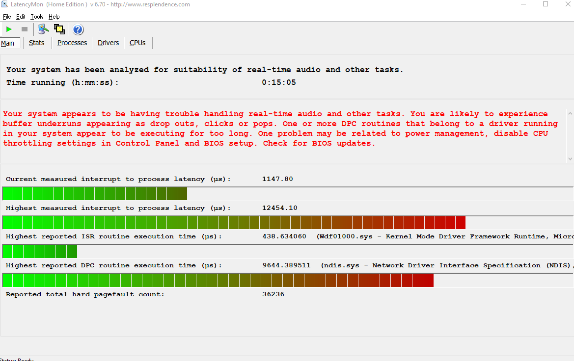

At my wits end with latency and audio drops in win10vm w/ threadripper 1950x
*********************EDIT*********************************
Check page 3 for my working .xml
I've got a threadripper 1950x w/ 32gb ram, on a asrock x399 professional board. I'm passing through an NVME controller to a win10 vm. Just updated to RC3 today. 1080ti is passed through, but I'm using onboard for my audio. I'm getting drops in audio and constantly have to switch my microphone inputs in discord (every minute or so, constantly switching from "default" to my mic and vice-versa). When ingame, FPS seems reasonable. I'm running the usual suspects docker wise (plex,sab, radarr etc) and they all seem fine. Bios is up-to-date. HVM and iommu enabled, as well as NUMA. I've tried for the last week to get UMA to work and its all the same things. Currently using OVMF and q35.31.
my syslinux line:
append isolcpus=12-15,28-31 initrd=/bzroot
My gpu is on numa node 1 (the 10de:1b06).
my xml: https://pastebin.com/1Em6QQTq
Things I've added to the xml
    <emulatorpin cpuset='0'/>  -will test if adding 16 to that helps
 <smbios mode='host'/> - didn't notice a difference
Things I've tried: I've tried both seabios and OVMF and OVMF seemed more responsive and less latency. I've tried the same machine in 1440fx3.1 and that seemed worse as well. I've also tested most of these in new VMs and installing windows each time.
I've installed "tips and tweaks" and set 'disable flow control and nic offload' to yes. Gpu scaling govenor to performance (seems slightly better than 'on demand').
Also applied MSI fix for all audio devices and gpu.
Does anyone have any suggestions to get this thing running well?

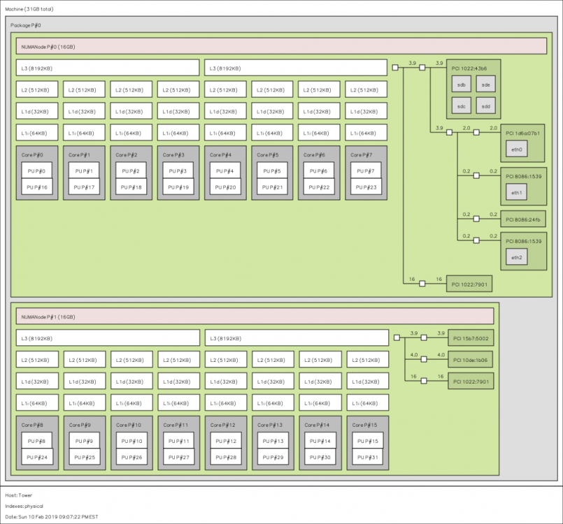

Looks like you have the same config as me. ASROCK Fatal1ty X399 Professional Gaming? 1080ti, NVME and onboard audio passthrough. Audio drops i only had before applying the MSI-fix. Make sure to run the program as administrator and recheck after every Nvidia driver update or every windows update if the settings are still in place. For me the settings are reset a couple times now after updates. I still using i440fx as machine type cause it was the recommended one as i started with unraid end of 2017 and it still works today. I played around a lot since then and tested a couple stuff. Currently my main VM uses cores from die1 only including emupin on that die. Die0 is used for other VMs and dockers and stuff. All the cores used by the VM are isolated from unraid so no other processes can access them. The CPU mode I've set is to decrease the CPUs cache latency inside the VM. With one of the next mayor qemu updates that shouldn't be needed anymore and the cache should be detected corectly without this tweak. I hadn't had the time yet to test if the latest Q35 versions brought any big improvements. The xml below works just fine for me, why changing it, right?

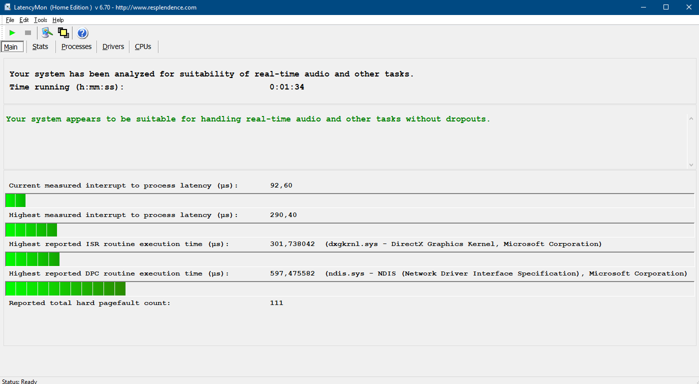

screenshot attached
Yea, you've replied to a few of my other threads and I really appreciate the help!. It's the same board. Couple of questions after looking at your .xml.

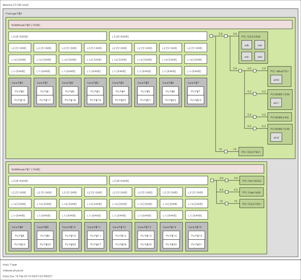

I see I have a mistake in my config. It should be "8,24" not "8-24".
These 2 threads are the first core and it's hyperthread on the second die. The die I isolated and only use for my main VM. In theory using the iopin and the emulatorpin on the same die as the cores the Vm uses prevents communication between the 2 dies and reduces latency. These both cores are only used for emulating and the io stuff. Not sure how big the difference in performance is, but i set it up a couple weeks ago with the idea to have everything this VM does limited to only 1 die.

You have you main card in the top pcie slot correct? which is node1.
Yes the 1080ti is in the first slot that should be directly connected to node1. I swaped around the cards a couple weeks ago. Second card 1050ti is in slot3 now. I guess i have to reboot the server and check lstopo again.
