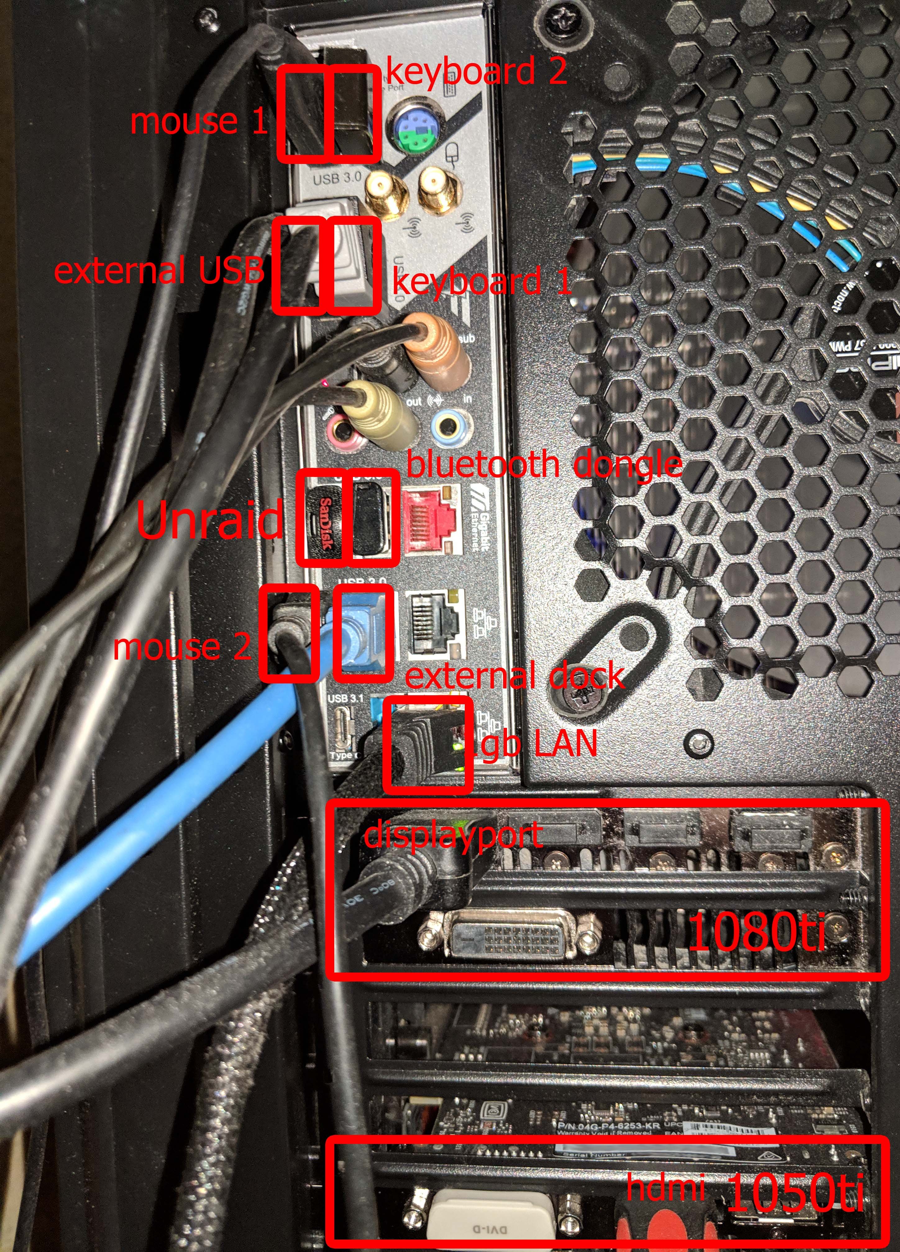

9 hours ago, Tritech said:
tell me where things are plugged into your rear USB
@bastl Thanks! I'll try switching some things around and see if that improves anything. Check my post above yours for some updates. IIRC I had my unraid usb where yours is, but I moved it so I can pass through the whole controller.

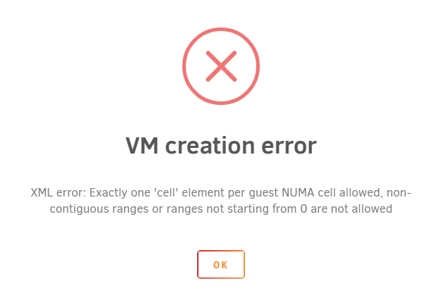

    <numa>
      <cell id='0' cpus='0-15' memory='16777216' unit='KiB'/>
    </numa>
Isn't that line telling the VM using 16GB from node0 for cores 0-15 where you using cores 8-15 and 24-32?

I saw that, and yes, that's what it looks like to me. Lemme test.
Evidently it does start with 1. I think the "0-15" refers to the vcpupin'd cpus, not physical.
Edited by Tritech
@Tritech Ok the "<numa>" tag is only if you have more vCPUs as one NUMA node has and you want to have a NUMA topology inside the VM. Let's say 2 cores from each node and than you can tell the vm which "virtual" node uses how much RAM. This should not affect us.

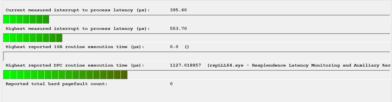

I reapplied the Epyc "hack" and that further brought down my latency, to ~300u, as low as 125ish.
https://pastebin.com/dLWncwhV

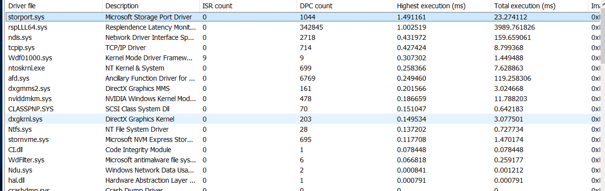

Here's some updates as well, seems that storport.sys is whats giving me the highest execution time. Gonna see if I can track down any gains there.
If the storport.sys handles all the disk IO than maybe changing/tweaking the iothreadpin can bring improvements.
Actually I let it run a bit longer and both of the highest execution are network related. ndis.sys and adf.sys. Come to think of it, you're using a different ethernet port than I am. I wonder if that may have some issue. I'm using the 10G port, which I don't really have a use for right now, the rest of my network is gigabit.
Edited by Tritech
I don't think. I don't directly passthrough a nic. It's a virtual nic emulated by unraid. I guess it's the same for you.
Yea I was just wondering if its driver related on the host side/vfio.

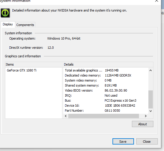

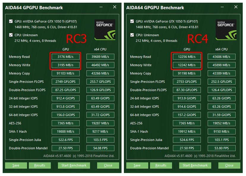

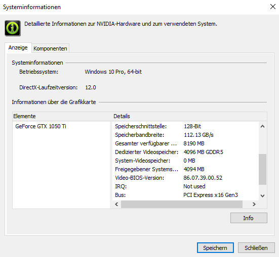

Tested the new RC4 and looks like it's working!
Same for me. Test VM with a 1050ti and the Nvidia driver shows the correct PCIe Bus speeds.
