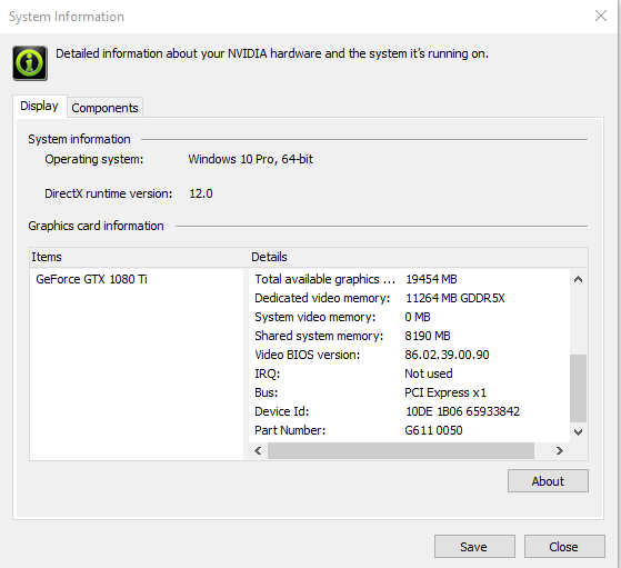

Thanks for this. I'm wondering if this is a windows only issue as on MacOS it reports the correct lane width (at least on one machine I have) and hits at or near bare metal benchmarks for gpu. I'll try to play around with it over the next few days!
Thats still not fixed. (as much as id like for it to have been that easy!)
Have a look in the NVIDIA control panel under system info at the bus in use. (id put money on it being x1!).
(image is from the level1 forum as im not at home and cant take a screenshot currently)
You can also do a speed test by using the evga utility: https://forums.evga.com/PCIE-bandwidth-test-cuda-m1972266.aspx
The patch to add the ability to set pcie root port speeds wasn't present in the 3.1 release (which is what we're on, as of 6.7.0rc2)
Edited by billington.mark
I'd like this as well if this really does work!! This could possibly fix many of the problems some people have with GPU passthrough performance.
Have a look in the NVIDIA control panel under system info at the bus speed in use. (id put money on it being x1!).
Ah shit your right.. still x1 #_# thats depressing
Yep, and because of that, the NVIDIA driver is reigning in performance.
I dont use MacOS, so im not sure if you're able to see this info on the driver... but in either case, x1 root ports will be presented to the VM guest, regardless of the OS its running. Depending on what checks the driver is doing on MacOS, it might have different performance implications than on Windows.

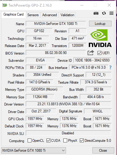

I am confused
PCI 3.0 x16 should gibe about 15,500 Mbyte/s
did run the linked tool in my Win10 VM guest and it shows me the following speed
its off by some degree, but probably ok since its a VM guest and VT-d ?
GPU-Z in Win10 reports PCIe 3.0 x16 and when I use the built in test it switches to x1 when I pause and back to x16 when I continue
in NVIDIA Systeminfo it says
does that mean passthrough works as it should GPU on PCIe 3.0 x16 ?!  😕
Edited by unrateable
2 hours ago, unrateable said:
I am confused
also in NVIDIA Systeminfo it says
I believe its all good and passthrough works as it should GPU on PCIe 3.0 x16, ain´t it ?!  😕
