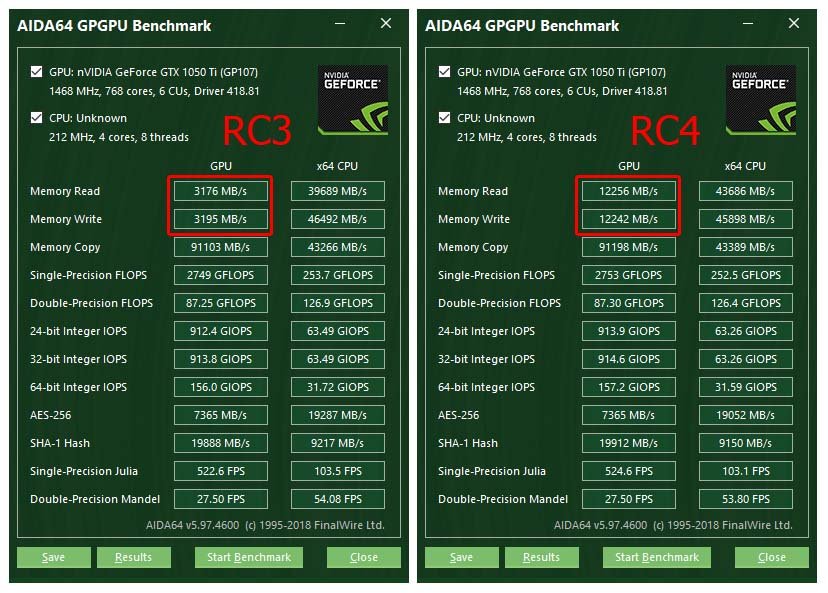

Right, our testing didn't show much speed difference but maybe not configuring properly...
On 1/29/2019 at 8:02 AM, billington.mark said:
<qemu:commandline> <qemu:arg value='-global'/> <qemu:arg value='pcie-root-port.speed=8'/> <qemu:arg value='-global'/> <qemu:arg value='pcie-root-port.width=16'/> </qemu:commandline>
I can report that after updating to 6.7 rc4 and adding that to the xml, there is no change in reported cinebencz fps performance on high Sierra or Mojave. BUT both vm's also reported correctly the PCIe lane width before the patch.
EDIT
Above testing was on a GT710, tested on another server running a 1060 and I'm happy to report the following
OceanCL before
368.2 max fps
Bandwidth  host to device: 2.79GB/s, Device to host: 3.09GB/s
OceanCL after
764.5 max fps
Bandwidth  host to device: 10.56GB/s, Device to host: 11.65GB/s
Cuda Z before
host to device: 27.9958MiB/s
device to host: 3085.54MiB/s
Cuda Z after
host to device: 10.8593GiB/s
device to host: 11.11552GiB/s
Only a 1-3fps gain in Valley benchmark, but I suspect I might see some large gains on video editing due to higher bandwidth availability.
But I'm curious how this helps out windows folks.

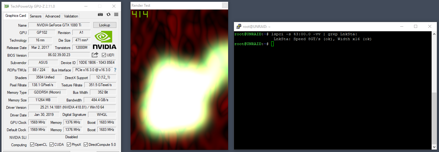

Trying now. I can say its not really completely about performance but also latency experienced in windows. DPC latency is all over the place. Can confirm patch is successful =0

@Jerky_san can you post your xml for reference?
<domain type='kvm' id='6' xmlns:qemu='http://libvirt.org/schemas/domain/qemu/1.0'>

Thanks @Jerky_san  You basically added the qemu lines at the end. For me in a test VM the Nvidia driver reports the 1050ti as x16 Gen3 now, before only x1.
Another thing i noticed, this is the first VM using the correct memory i have setup. Usually with strict no matter what, it always used a couple MB from the other node. Coincidence? Never saw that before.

All my latency issues on my OSX Sierra Render VM are gone like the wind. (had huge issues with midi controller devices and driven mouse/screen movements)
Also in pure speed i noticed a few fps increase on some specific Davinci Resolve performance tests.

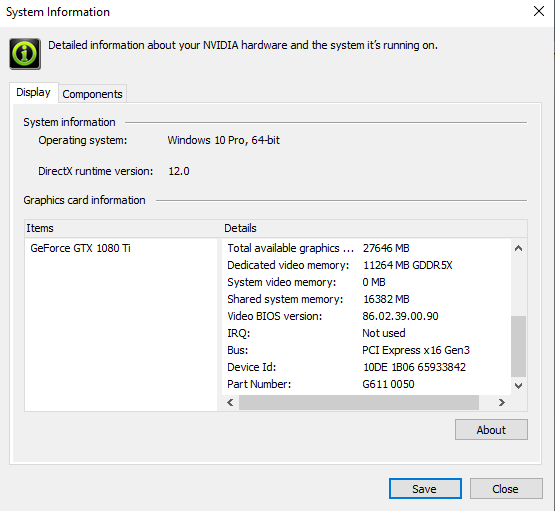

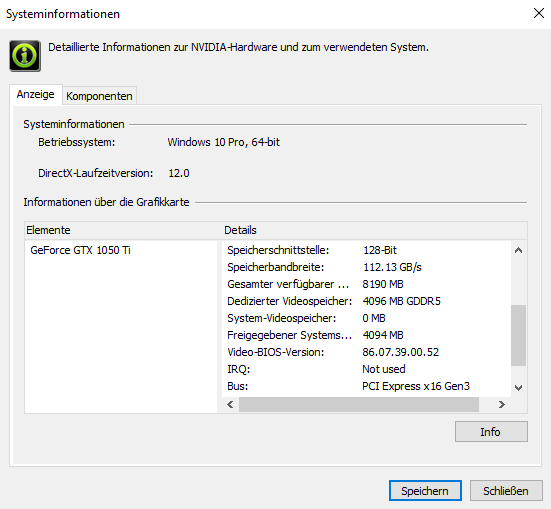

I've updated my original results with new info above, seems it's running higher bandwidth on (moderately) higher end card vs what I first tested with.
All tests i did so far, on synthetic benchmarks like cinebench or heaven and superposition you can't see that much of a difference. I guess the fact, that the benchmark loads all shaders and textures at the begining is the reason. Testing FarCry5 the performance gain I see is bigger. I guess games that constantly loading stuff will benefit more from that patch. I think that needs a couple more tests

I posted some test in another forum related to this.

@rix Try the following, Get some load on the GPU for example with the render test in GPUZ and run the following comand in unraid.
lspci -s 43:00.0 -vv | grep LnkSta:
Adjust it so it matches your GPU. 43:00.0 is my passed through 1080ti. 8GT/s is what you wanna see for a x16 Gen3 speed.
Mistake that everyone makes is to trust the link speeds GPUZ is reporting. Even if it's reporting x16 the Nvidia system info is the place shows it right.
